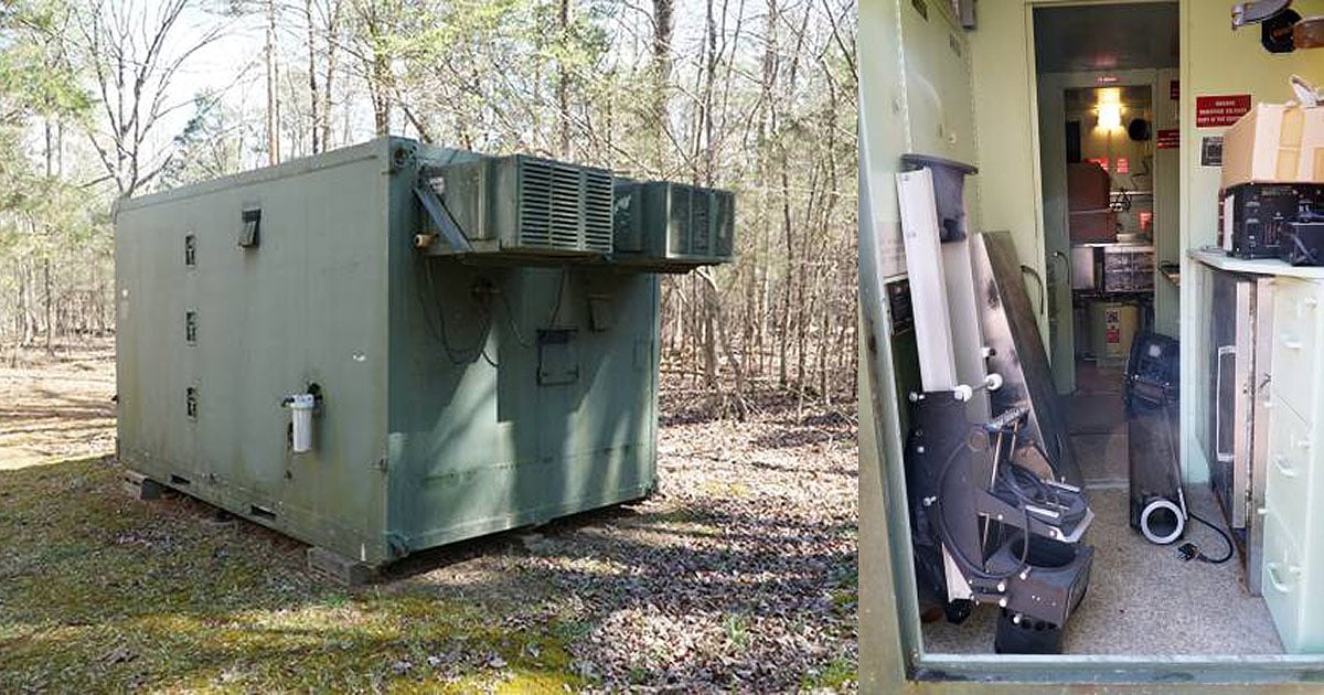

Maybe this could help you with setting up your "con-ex" dark space.
I wish that ad wasn’t in 2016 USA! I would be pressing buy now!! 😂 great inspiration thank you!

As I recall, these units or it's predecessor included a incinerator to reduce film and paper to ash and recoverable silver, but I've never seen one in person, to verify that as a fact.
