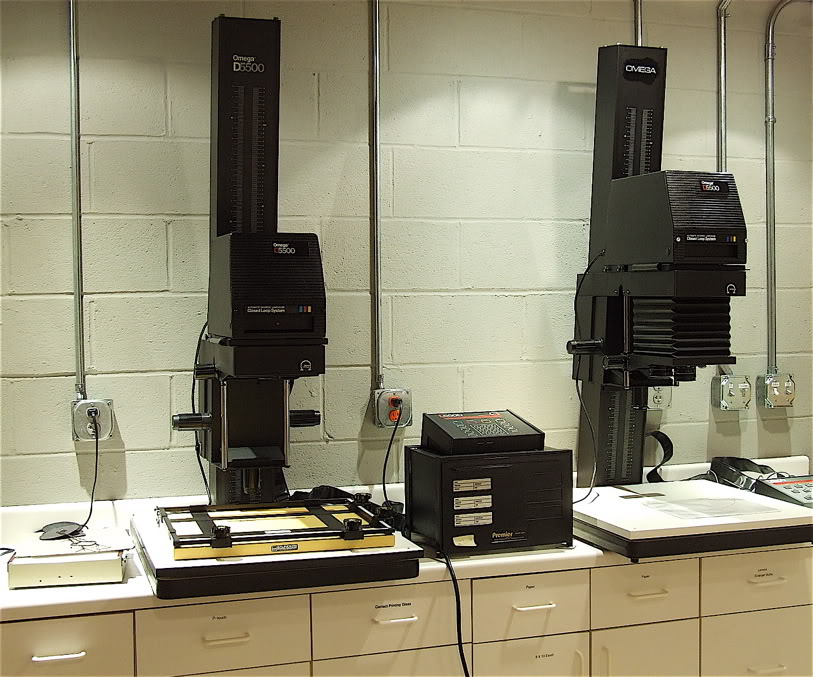

Thank you for looking. I am looking for some opinions and hopefully this does not come off as a gloat. I fell into a little bit of darkroom luck via severance pay when I lost a job due to down sizing. I worked for a lab that had not used (or had set up) their enlarger equipment for years. I mostly developed film and did copy work. I always expressed the goal of some day setting up my own darkroom again, so when the business was hurting and my job was eliminated, I got a bunch of stuff. A bunch! I only mention this as a preparation of my, oh so awful dilemma.:smile:
So, I have the following set-ups;
1.) Omega D5 with a Super Chromega D Dichroic II, with the better controller (pictured, but can't remember the name w/o going to look). It has the 2 1/4 x 2 3/4 mixing box as well as the 4x5 mixing box. I won't be doing Color, but I understand you can use this head very nicely for B&W by dialing in colors rather than using filters.
2.) Omega D5 XL with a cold light head and Zone VI compensating timer
3.) Omega D5 XL with the Ilford Multigrade 500H system
For the record, I am unfamiliar with the use of any of these systems as the last time I printed anything was with a Besler 23CII.
Two of these have 3 lens turrets on them and I am planing on printing from multi formats (35mm, 6x6, 6x7, 6x9 & 4x5). I have all the appropriate lenses I need to do so.
When I originally set up the darkroom, I made it out to keep all three enlargers thinking it would be useful to keep each format set to a specific enlarger. However, it is just too damn crowded in there and I feel selfish having them all. It's just over kill and I already set myself up with too many options in shooting aspect.
Luckily, they are all the same base enlarger, some I can mix and match. I feel pretty certain I will keep the Ilford Multigrade system unless I hear from a bunch of you that it is not worth it. The color head seems more versatile than the Zone VI, but I just read a thread (well some of it) where a lot of people like their Zone VI as a stabilizing unit for their cold head.
So what say you? Thank You again.

I have an LPL 5400 XL enlarger with variable contrast head. That head makes changing contrasts incredibly easy for split grade printing. I'd keep the enlarger with the lens turret and Multigrade system. Store the others.
TY Neal and John, I am certainly storing one, but since I have so many formats to cover, I'm thinking keeping two set up. At the moment, the multigrade system has a 50mm, 80mm, and 105mm on the turret. The cold light has a turret, but only has my 150mm on it for 4x5 and the color head has a 135mm. I ended up reading the whole thread about "cold light head" and now feeling that will be the one that goes away. I'm thinking I will remove the cold head from the XL base and replace it with the color head and add the 135mm to the turret.
If setting up two, you can put the turret on the one for large format and use the individual lens plates on the one for 35mm. I have a pair of Omegas setup that way. This may make aligning the lens easier. Large format, the alignment is not a critical. The SuperChromega II will outlast the others. It is all mechanical inside. The Chromegatrol might die but you can run the head from a generic 24V supply if all the Chromegatrols in the world die. I'd keep the Multigrade head and the Super Chromega II head. I'd convert the last one back to condenser and use as a spare. No 'electronics' to fry with the condenser system. Just a bulb and socket.
As usual, IC brings up some good points. The Ilford head is probably the easiest to use, but those heads can be hard to repair and I don't know that spare parts are available, so it makes sense to keep the Super Chromega. If you get rid of one, it would be the one with the Zone VI head, or sell the cold light head and compensating timer and keep the chassis for spares. L

Thank you ic-racer.
I have 2 - 3 lens turrets and 2 - single plates and 5 lenses I intended to use to cover all my formats. You bring up the point of alignment for the 35mm (50mm lens) and being on it's own single plate, so does it hurt alignment to pull the single plates out and exchange with another? Being that I will need to use 5 lenses I'm thinking the 105mm, 135mm, and 150mm on 1 turret and the 50mm and 80mm on another turret. Unless you think I would be better off putting the 50mm and 80mm on individual single plates.
Luis-F-S, TY, I think the Zone VI system is going to end up in the classified here since I have all these options. And, BTW I do still have a Beseler 23CII and Omega D2 in the attic at the moment in case I need to go back to a condenser enlarger.
