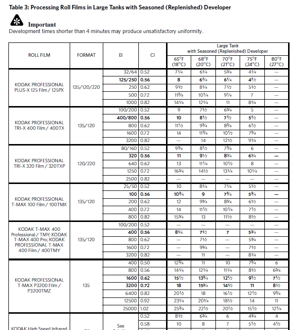

Problem is a new adjustment developing time. That could be hit or miss each time. So, if you're using it 1:1 that's 70ml stock plus 80 ml of what you just used to bring it up to 150ml and then add 150ml water for 1:1? That for 300ml for one 35mm roll.
From Kodak Publication J-109:
On page 11:
There are also pages on rotary processing [example: Jobo] on earlier pages.

Then I can't use it since the developing time would be too short for a higher than 68 degree temperature.
When you replenish a developer it has less activity than stock developer, which means you end up with developing times very similar to 1:1 dilution.
What slows the developer down are bromides and other byproducts that naturally occur in the film processing cycle. These compounds are what makes the developer different from fresh chemistry; it makes you lose speed, but you gain sharpness and finer grain, and a different tonality.
It is actually easier to do than diluting 1:1, and if you find yourself not using up the whole 5 liter kit while doing 1:1 you wouldn't use it up with replenished developer either, but you were going to throw out the excess anyway...
I loved working with replenished Xtol, particularly with Fomapan 200 and Kodak TMax 400 (and 100) films. Great results for my tastes. I went through dozens of 5 liter packets and never had to mix a new batch during the five years I used it. Dead accurate, dead reliable; never missed a beat.
Anyway, don't shy away from replenished developers out of fear that it'll be difficult. Particularly with Xtol where the stock developer is also the replenisher. It is so very easy to do. But if you simply don't want to, no worries. :smile:
