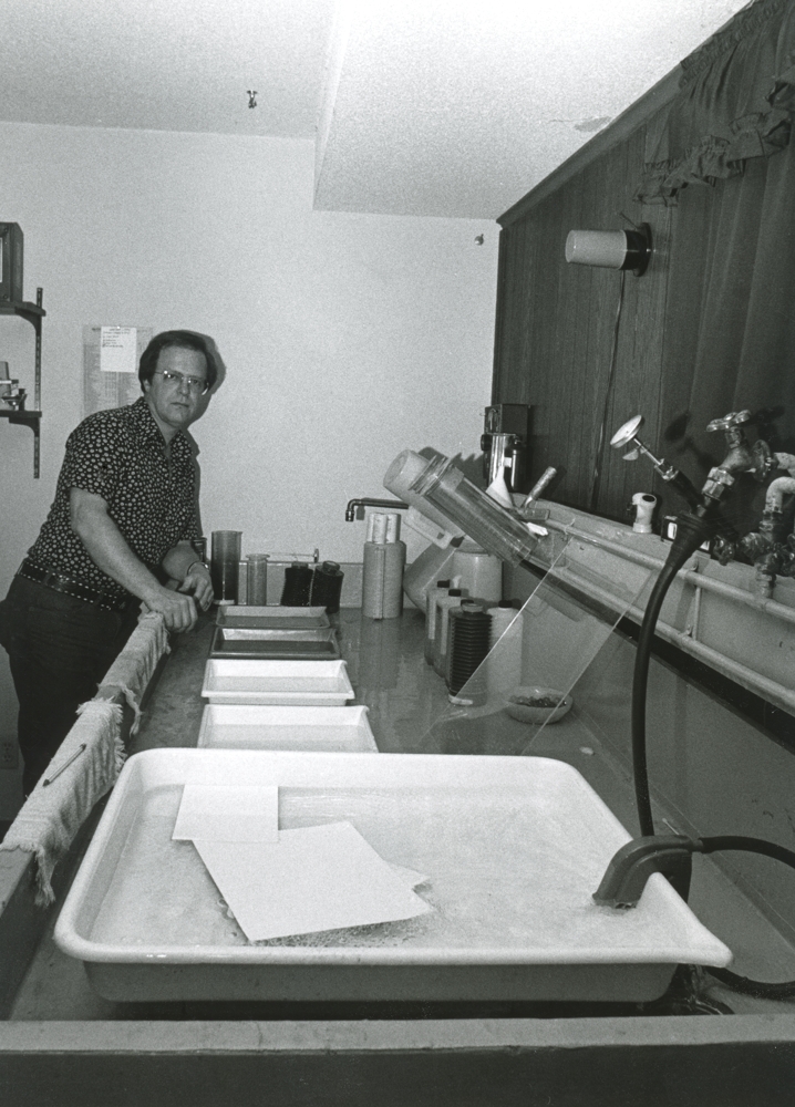

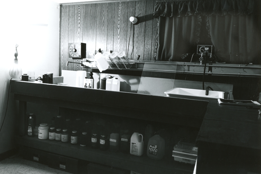

I'm considering resurrecting my old darkroom after years of inactivity. The one I built back around 1982 has old faucets that no doubt will need the seals replaced but I may update that altogether. I'm looking for a means of being able to get and keep a steady 68 degrees from it if possible as the only time that's available at the tap is during the winter. Otherwise, tap water from the faucets are 75 degrees Summer months.
This is what it looked like while in use some years back. You may/may not be able to discern the faucets. the lamp at the left was for lighting purposes only. Couldn't get the flash to work back then when that was taken so used the lamp for light.
