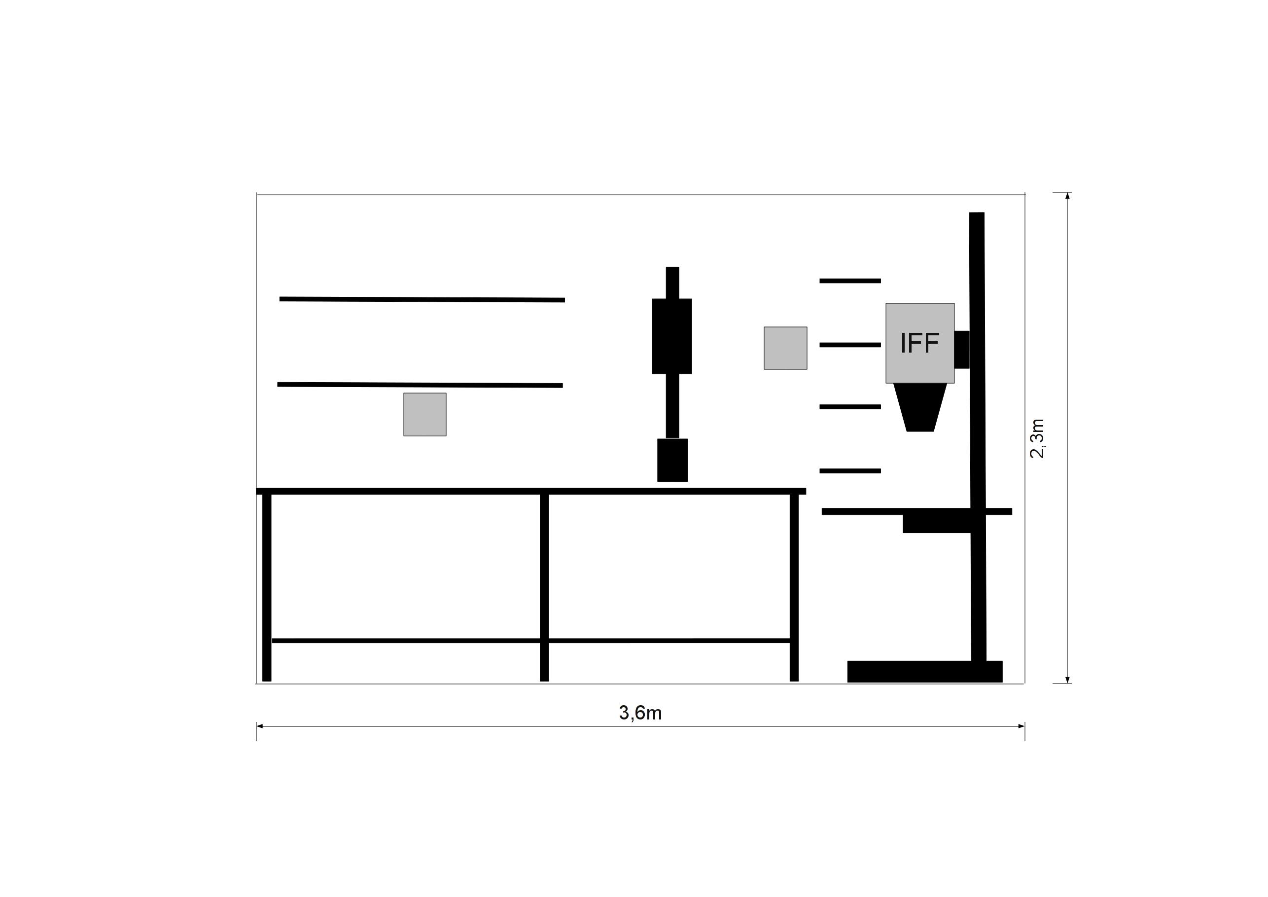

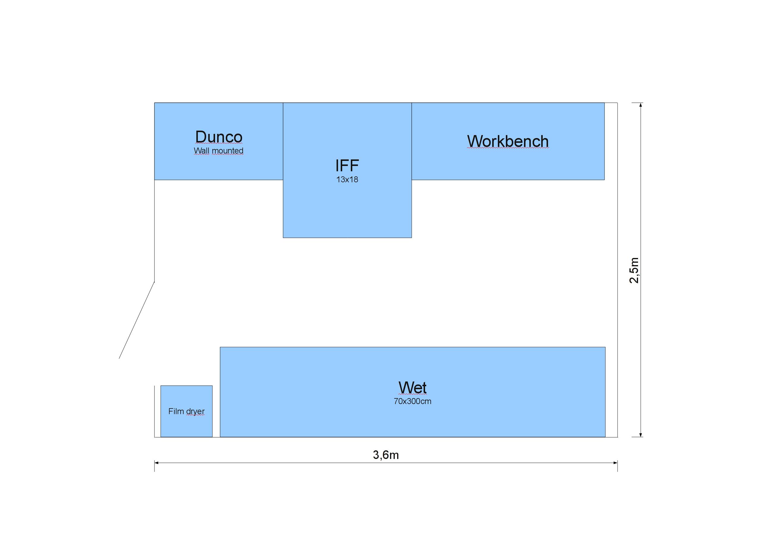

The room where I will build my new darkroom is about 2.5 x 3.6m. A movable print drying rack and Jobo (ATL-1000) will be stored outside of the darkroom and moved in when needed in order to save space. As much equipment as possible will be mounted on the walls.
Hot and cold water pipes, and also a drain pipe, goes through the room and are easy to connect to.
Darkroom plans attached. Any comments or suggestions?

Looks fine and would probably put the big boy in the middle as well.
I have a left to right work flow on the wet side so would move the workbench to the left and bring the Dunco to the right. Fewer steps to get to the sink. If you go right to left, then keep as is.
Allen Friday
Mar 30, 2005
882
ULarge Format
The only thing I might change would be to switch the two enlargers around. The IFF sticks out into the room farther than the Dunco. I can envision a lot of bruised hips or shins as you move from left to right in the dark down the length of the room. Or stick a piece of light proof darkroom tape on the edge of the LFF table. Looks like a great, usable space. Have fun with it.
MattKing
Apr 24, 2005
53,519
Delta, BC Canada
Do you use one of the enlargers much more frequently then the other? If so, I would tend to put it closest to the workbench.
fotch
Mar 16, 2005
4,774
SE WI- USA
I think having to go around the middle enlarger would get tiring fast and might be better in the left corner, near the door. If you had more isle width that might be different. Looks like you can change it later if you need to and if that's the case, try whatever is your first choice.

The work flow on the wet side will be from right to left.
Thanks for the suggestions on the placement of the enlargers. The main reason I have put the IFF in the middle, is that there is a H-beam in the ceiling on the left side, where I have placed the Dunco now. It would limit the maximum height of the IFF.
I will make some alternative plans to see if I can come up with something better.

If it works for your printing method, you might put the workbench in the middle and have an enlarger at each end. That way you would have work space next to each enlarger.
In my darkroom, I purposely moved the enlarger farther from the sink when I redesigned it last time. I found that I don't tire as much if I move around more in the darkroom. My current set up is less efficient than the old, but I feel better after a long printing session
The set up you have is great and you can't really go wrong with it. All of our suggestions are just things to think about--food for thought. It seems like you have considered the possibilities. Go for it and have fun.
Ditto for me and would put the LF enlarger away from the door.

Darkrooms are a very personal thing - but here is my $0.02
I like to have some worktop space on both sides of my Enlargers - makes stuff easier to reach without stretching - particularly useful when you get into complicated dodge and burn sequences
I also find it pleasant to have the developer tray as near the Enlargers as I can manage - it feels like I have to move around less in the darkroom.
I also like the boxes of photographic paper to be near to the white light switch - so I can check I have the lid on properly before I switch on the main room lights.
YMMV
Good luck :smile:
Martin
grahamp
Mar 2, 2004
1,721
Vallejo (SF Bay Area)
This space is slightly longer and slightly narrower than mine. Do I understand that the ceiling construction limits the placement of the IFF unit? I'd probably put the enlargers at each end, with the workspace in the middle. That's how I have my two Beseler 45s set up. I can use my RH Designs unit on either side. The only thing about putting an enlarger close to a wall is that you need to allow maybe 150-200mm of space between the wall and the enlarger baseboard otherwise you will elbow the wall a lot. If you have a dominant format, try to put that enlarger opposite the developer end of your process cycle.
With a space of this size, you are only going to be taking two or three steps to get anywhere.
Jan 17, 2005
1,355
Downers Grov
A little walking keeps one from getting tired so fast. My first in this home was 10x8 feet. Space became available and a dry pace was added L fashion to the first which became the wet side.
The 4x5 enlargers are 15 feet from the trays. The 35 mm enlargers are closer, 3 to five steps depending on which I use.
Keep the aisles wide.

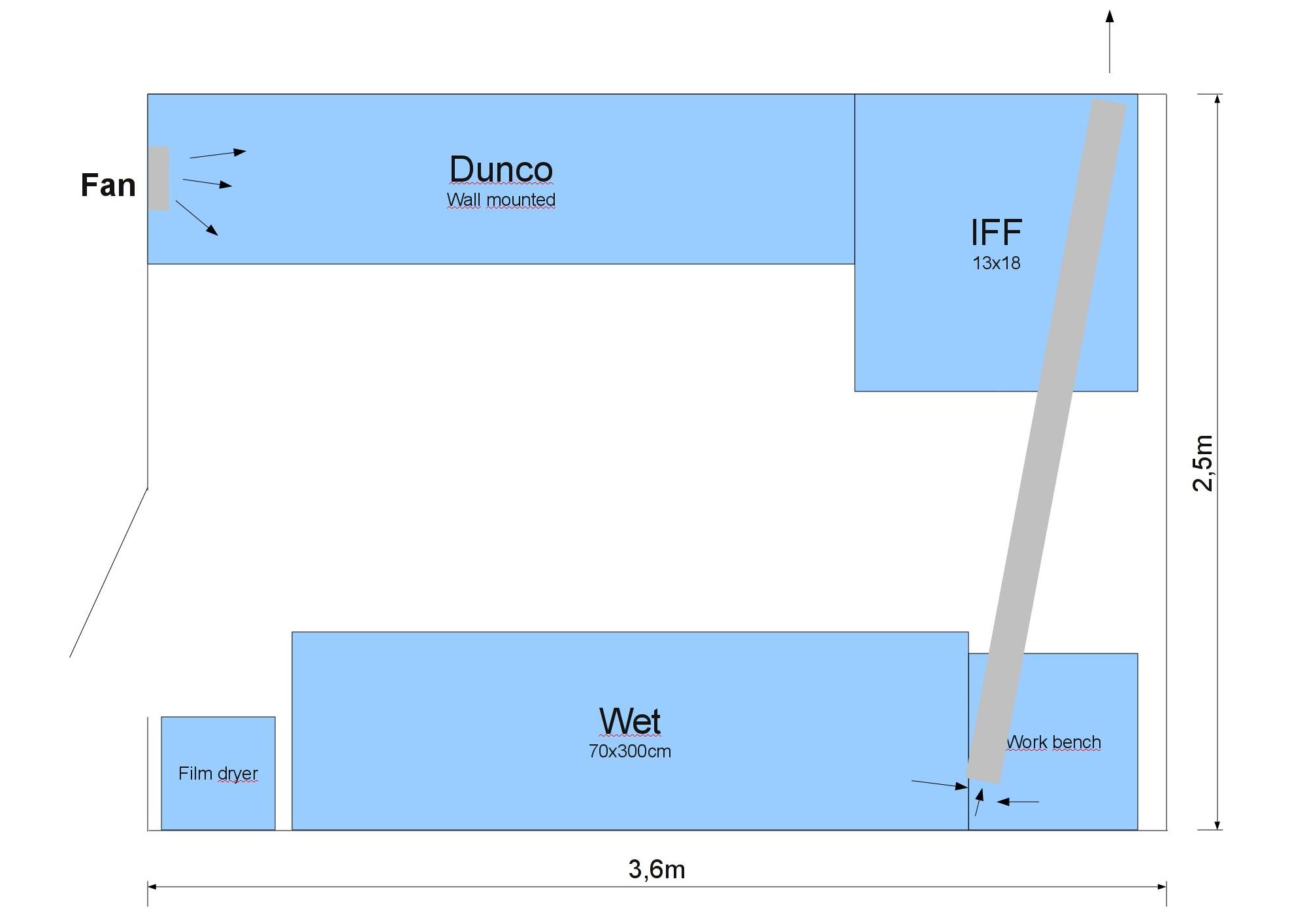

Is added ventilation-part of the plan?

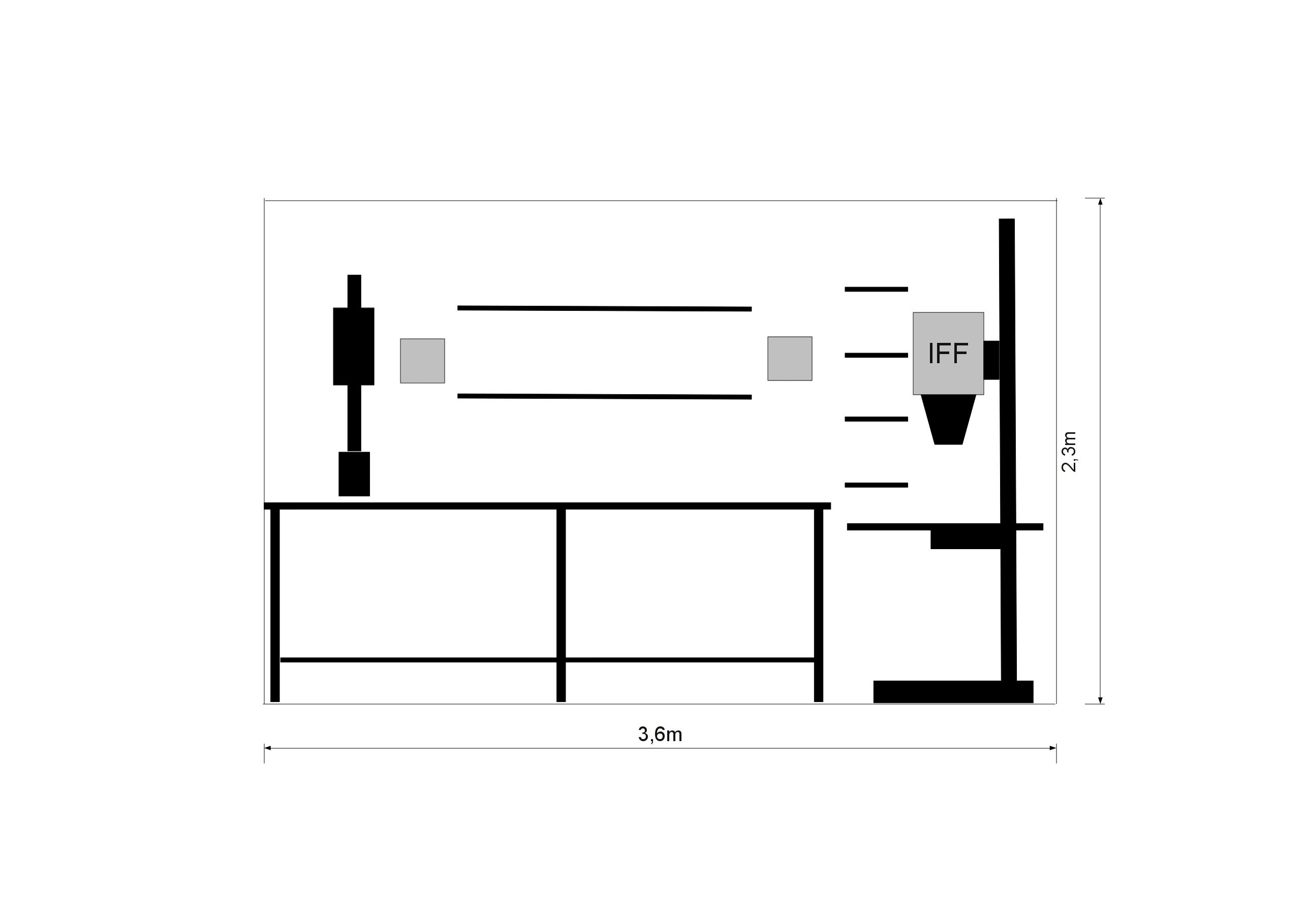

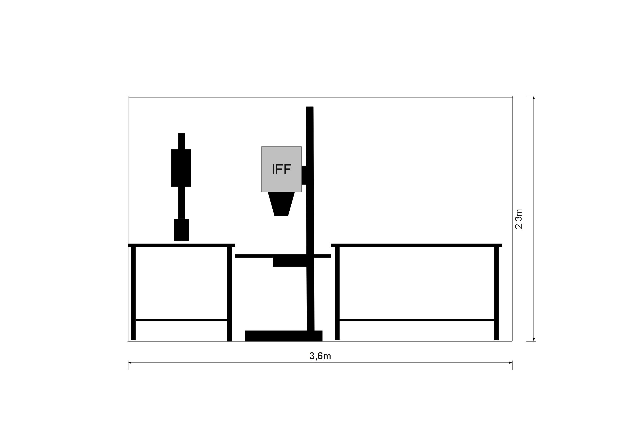

Two more plans of the dry side. The IFF on the far right side, and a long work bench. Two alternative positions of the Dunco. I think I would like to have to two enlargers side by side, so that I can use the same timer for both.
Trond

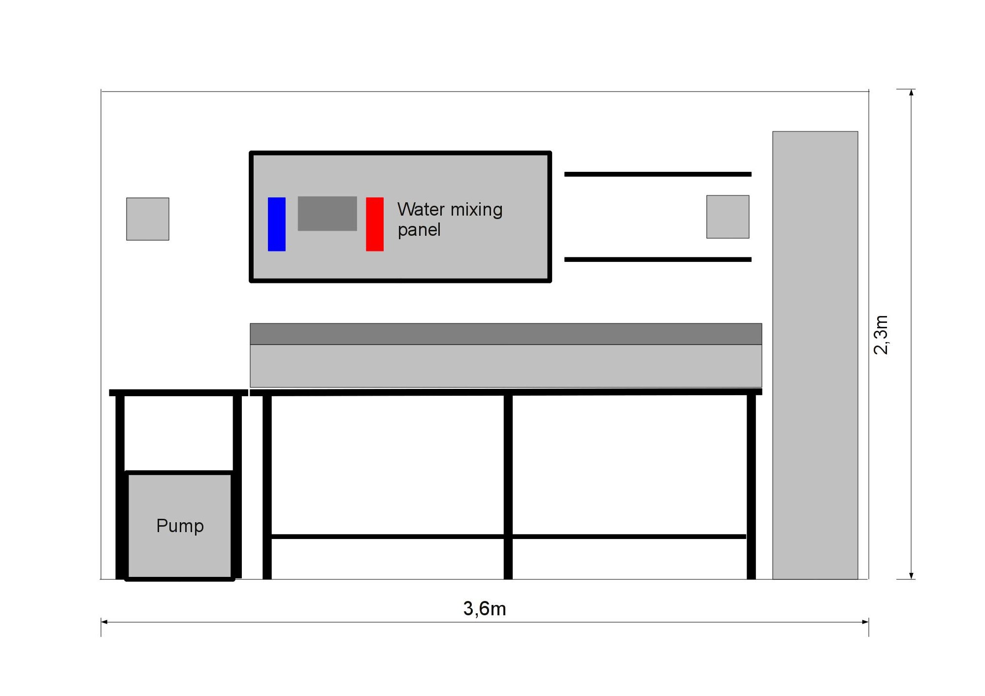

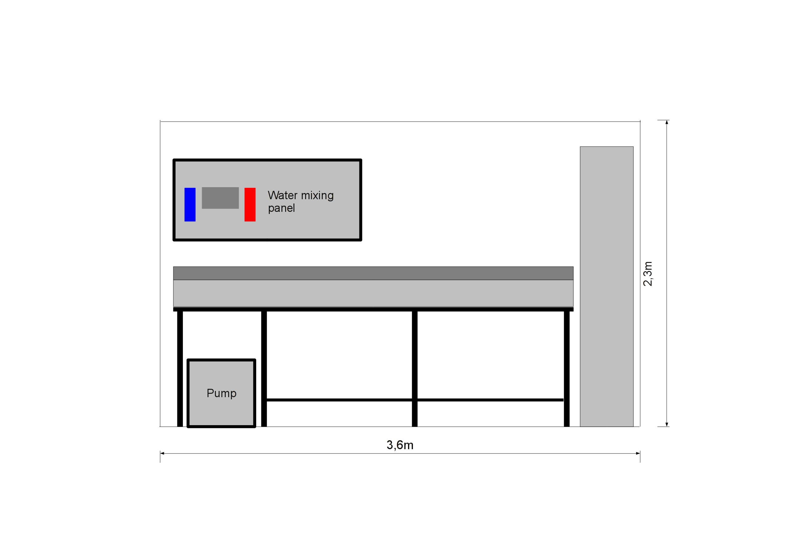

I have updated the plans for the wet side of the darkroom. I'm now planning a shorter sink (2,4 m). 2,4 m plywood is easier to get, and the sink will also be easier to move into the darkroom. As a bonus I will have room for a small table beside the sink.

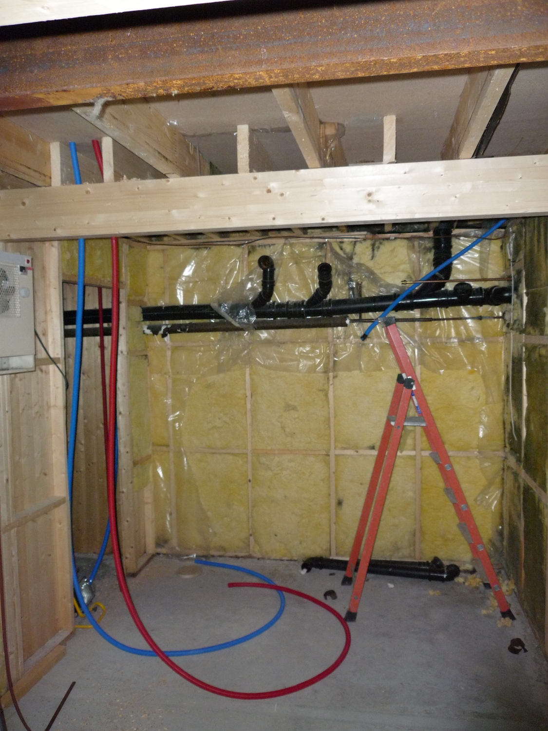

A photo of my future darkroom. The walls have been opened to dry after a big water leak (frozen drain pipe in the ground outside of the house). This is thankfully covered by insurance ($60 000 and still counting...).
This was originally two storage rooms. When the wall between the rooms was removed, the ceiling had to be reinforced because of the bathroom above, which is being rebuilt.
We are moving in on Wednesday, and the darkroom should be usable this autumn.
Totally agree with this and was going to reply saying the same thing: flip the workbench and the dunco/IFF. You want to be able to do a 180 and end up at the developer.
(I'm assuming you follow a dev-stop-fix L-R order as most do).

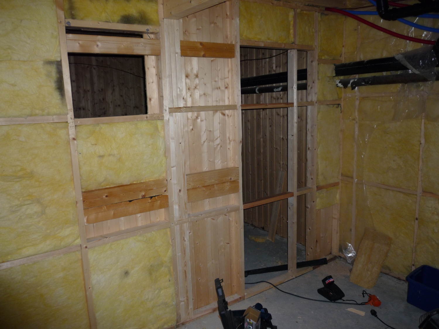

Latest progress. The walls have been reinforced to hold the wall mounted Dunco. I'm planning on finishing the walls and ceiling within the next two months.
The workflow on the wet side will be from right to left.
