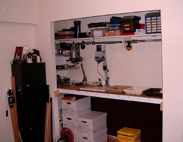

Well, at least the darkroom is finished. Well, sort of, you will note from the attached photo that I still have stuff in boxes under the counter. Setup is mainly for 8X10, but I can go larger if I take down one enlarger. For print rinse I use a large water filled tray on a cart that goes under (replaces the yellow kitty litter box). Then prints go a short hop to the bathroom where they are rinsed in the tub. Thank gawd I am a bachelor.
As this is a rental suite I could not do a major renovation. As a matter of fact the height of the bench was determined by the two sliding doors I took off. They lay in the back and actually form the support for the back of the bench.

Relax, Thomas. You're on APUG. You don't need to be a closet darkroomer around here. :D
Seriously, nice adaptation of the space.
BTW, I use the kitchen sink for print washing - a much more convenient height.

Very neat, Thomas, and not dissimilar to my own set-up. My darkroom bench and equipment are in a walk-in cupboard off the bedroom, so when the doors are closed it's all out of sight/out of mind but when I'm using it I have the full space of the bedroom to cover with junk!
I see that your right-hand enlarger is a Durst. I have a similar model, which I'm very happy with other than the fact that it tends to suffer from Newton's Rings when the head is lowered on to the negative. It doesn't happen all the time and never with my old negs, so my guess is that it's the modern thinner film base having that bit more curve and allowing it to contact the condenser when lowered. I've just increased the thickness of the orange mask to try to avoid the problem.

Never had that problem with the durst. But have had some associated problems with the Meopta. I would really like to get rid of that glass clam shell carrier. It is totally useless for small negative. Not shown is the air compressor to keep the dust out of the enlargers.
No picture of the rest of the room forthcoming, but needless to say it is rather full!

Looks like a sensible arrangement. Dursts of that vintage are easily mounted on different baseboards, so you could put both units on the same base and gain about a foot. That assumes you don't need both enlargers simultaneously.
I would do a safelight check - the lamp looks a touch close to me unless you have dropped the wattage.

Oh yea, the safelight. It is running a tiny christmas tree bulb inside. I did have to put the deep brown one closer to the enlarger. Paper safes are on the shelf beside the enlarger and for safety I use a really tiny safelight on that side.
The Durst does indeed have a larger base. I have the extension post, so the base is now 18" square. Don't know for the life of me how those tiny bases it comes with can be any use at all. I also have 35, 50 and 75 mm lenses all of which are interchangeable for optimum magnification.
Window has "masonite" blackout boards in slides. So I can get the whole place really black.
