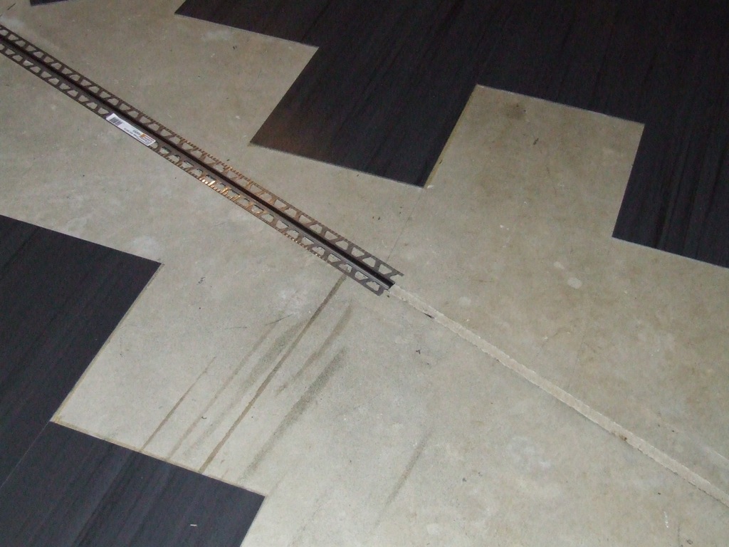

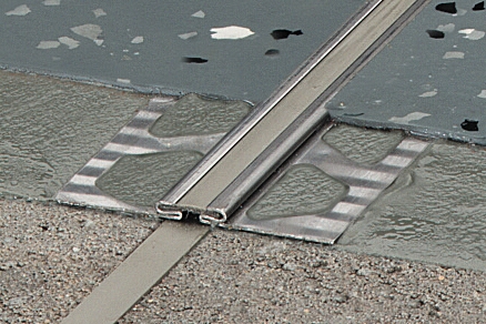

I'm doing the floor adjacent to the darkroom floor and spent some time deciding on the best way to cover some expansion joints in the concrete. I came across this product and ordered it today. We will see how well it works. (Picture shows Schluter DILEX)

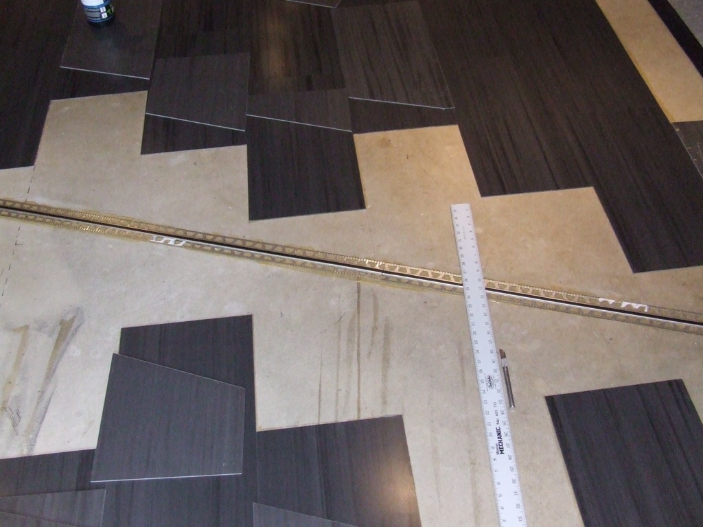

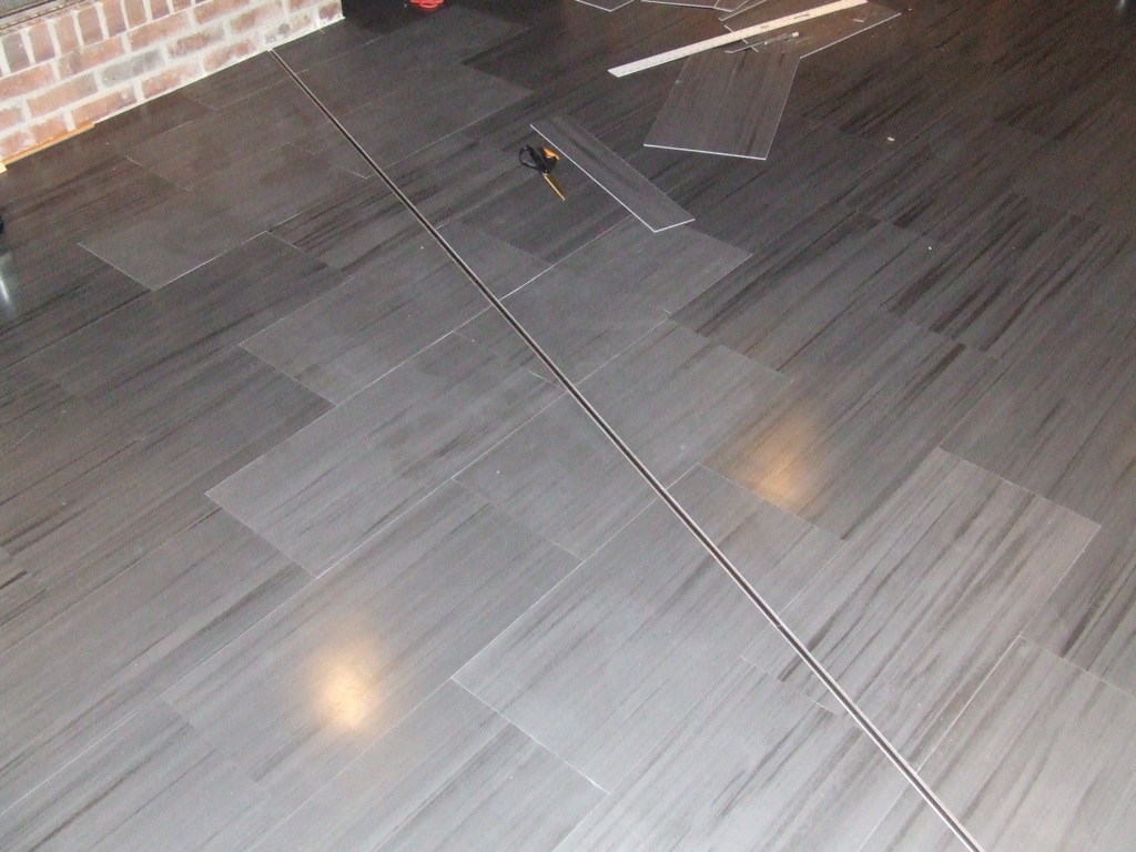

Update on this thread. I had to wait 3 weeks for the expansion strips to come in. In the mean time I tiled the rest of the floor, leaving space for the expansion strip. Once the strip came in I had to fill in the empty tile spaces. The tile that abuts the expansion strip had to have a perfectly straight and smooth cut.
