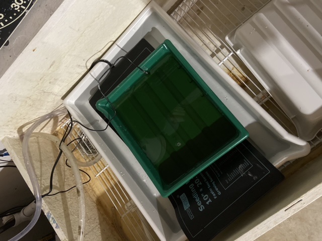

I wanted to post that image of my current tempering set up. What you see there is a 11x14 mat water bath with the thermostatically controlled seed mat, and my tray of A130 on top of it. By setting the seed mat to 80F I was able to heat my A130 to about 70-71F. Perfect for a 2 minute development time.

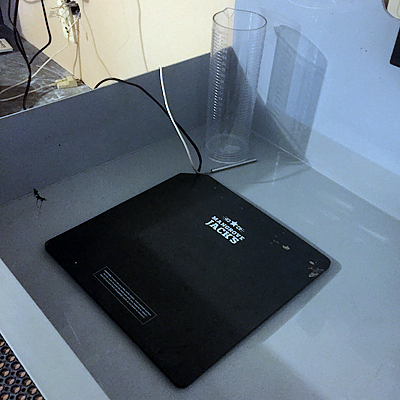

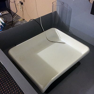

Here is a photo of my homebrew heat pad and a second photo with an 11 x14 tray sitting on the heat pad with the probe in the tray, keeps developer within .5C. I love it!
View attachment 243318 View attachment 243319
Yes when I tried it just under my tray the heat transfer was non-existent. It's possible that the ambient temp of my lab at that time was too cold also, or that your fermentation mat is simply much warmer. I looked up your model on Amazon and it lists as not being available. My search continues... In the meantime though my solution may be inelegant, it works.
I'm guessing that having the rack under the source of warmth may reduce efficiency.
