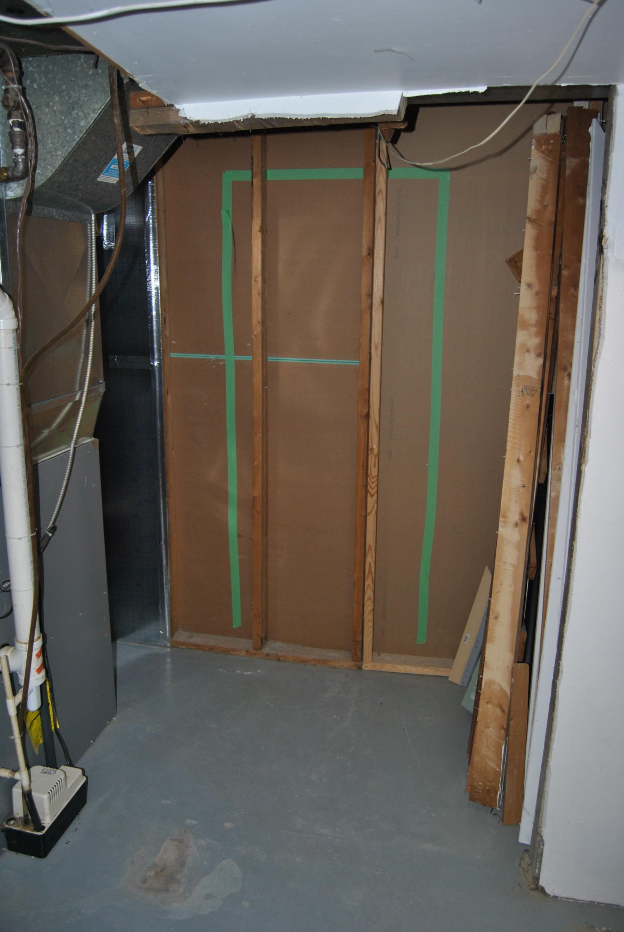

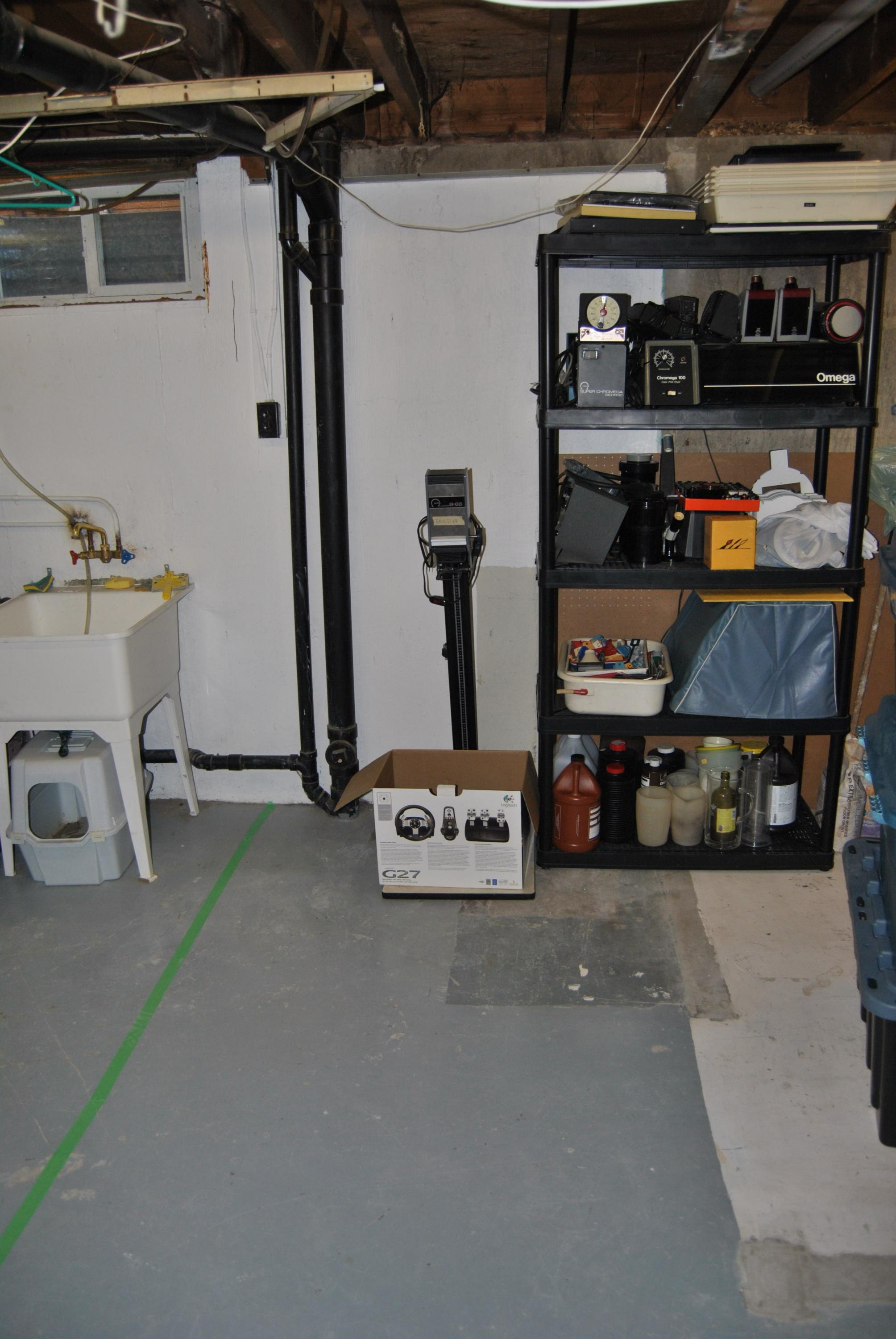

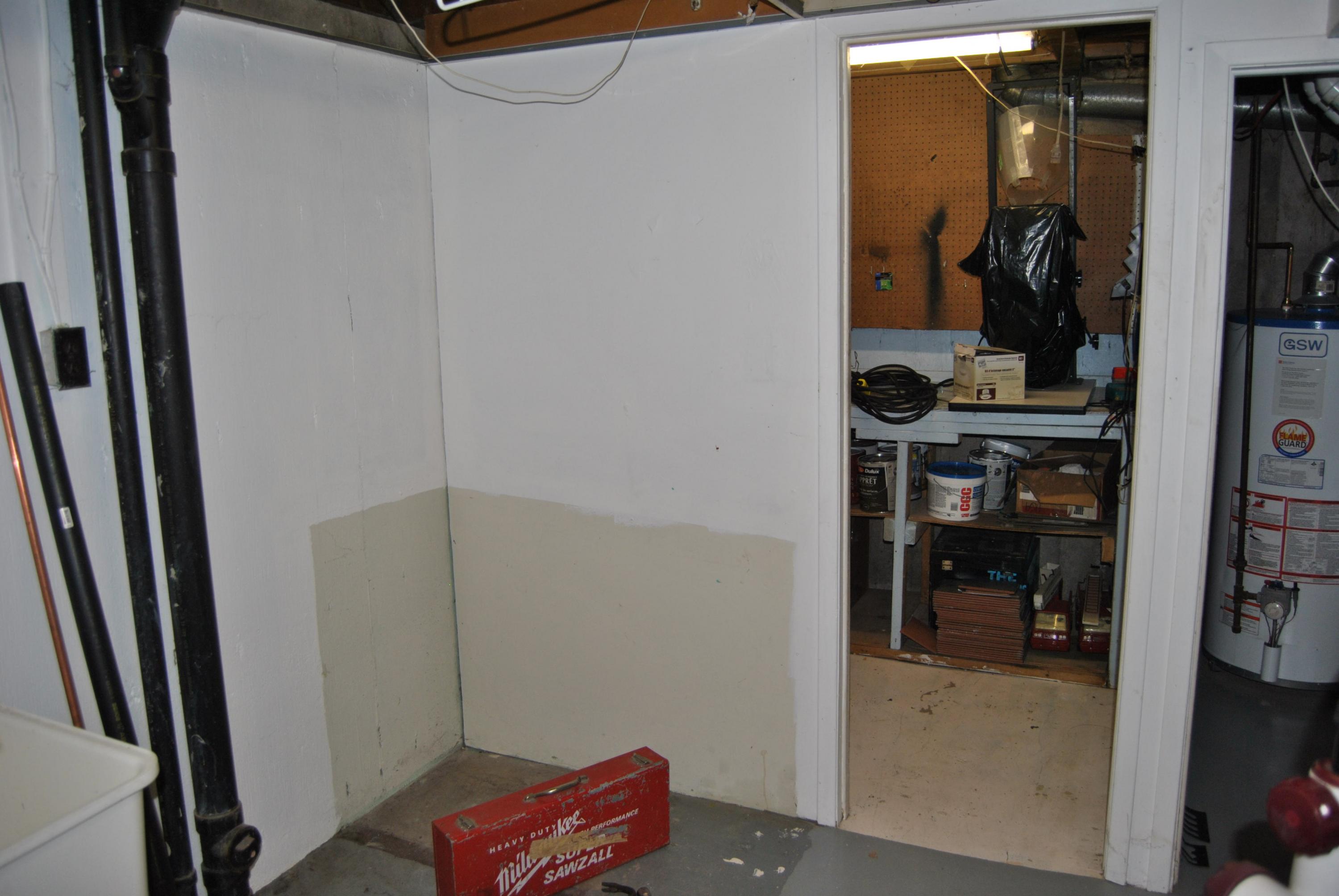

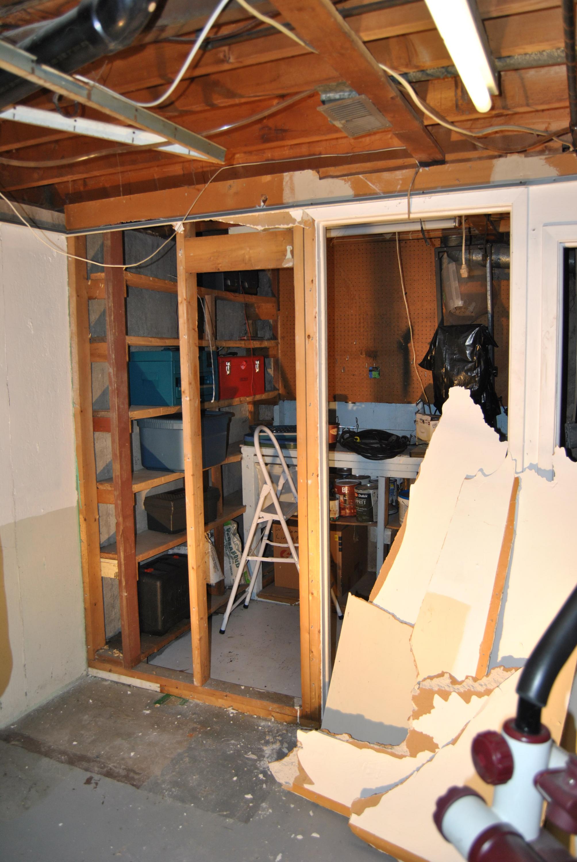

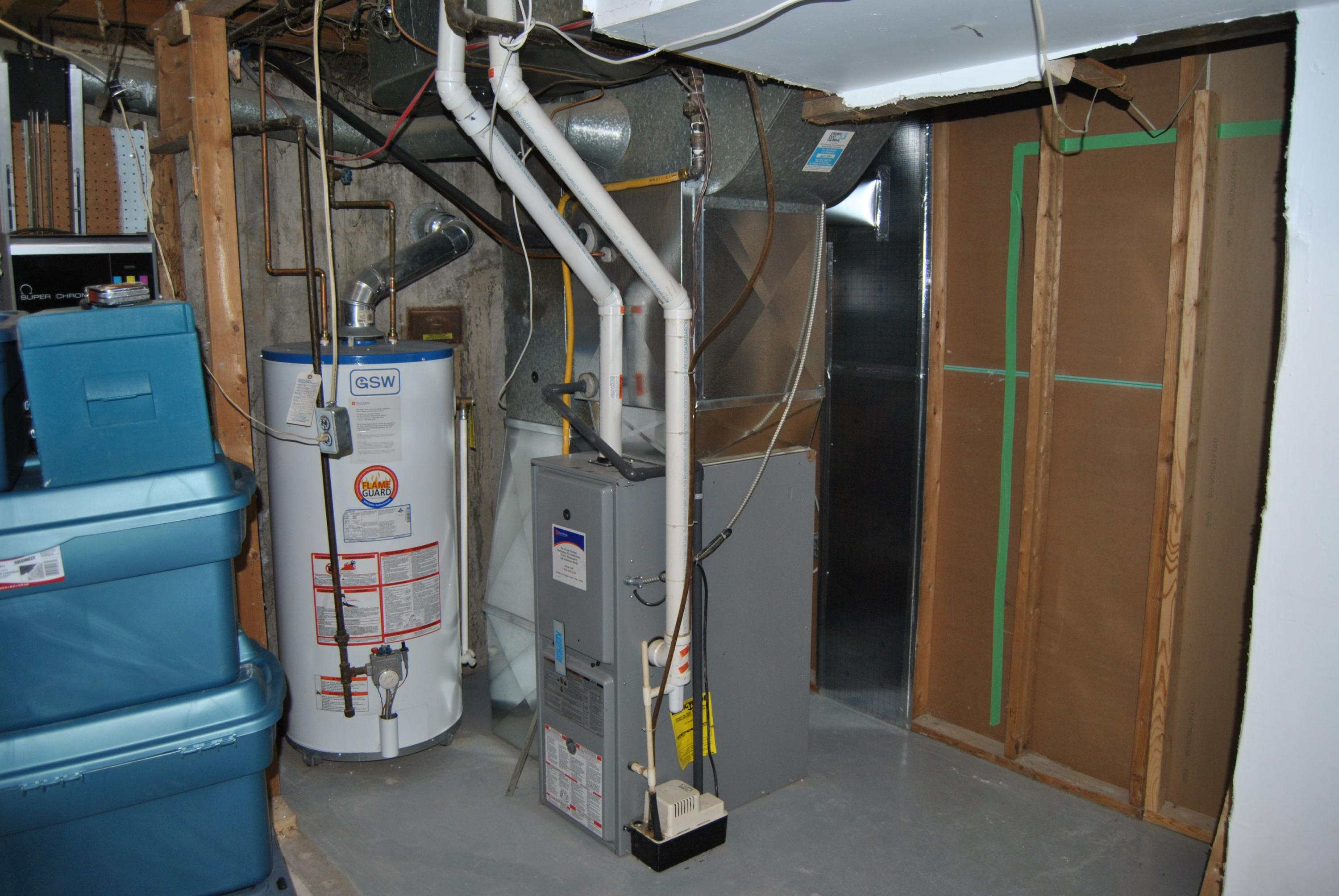

In order for you all to see what I am talking about I added a few photos from this weekends demo. I taped out the door in one photo as I will be entering the darkroom from my office. I also taped out the floor where the new wall will go. As you can see it is adding some extra space as the little room I opened up had white pain on the floor. The new wall will be my wet side and I was thinking of a L shaped counter to work to my sink. As you can see the water and furnace takes up a bit of room and I REALLY wish they were some where else. Oh well I will work around them!
Thanks
Tim
Your furnace is ok, but the hw tank is a normal convection flue, so you really should have positive pressure air into the room.
