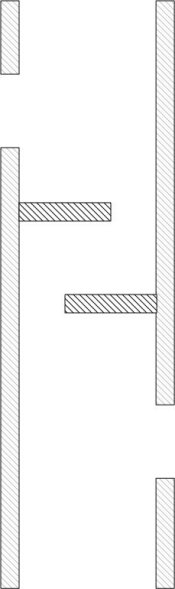

A light baffle is simply an opening through a box (which could be a wall cavity) that allows air flow but that prevents light from coming through.
The basic principle of a light baffle is that light (and we won't get into the hoary old argument of whether light is a ray or a particle) follows straight lines - except when it reflects or refracts. Light baffles don't involve glass, so we don't have to worry about refraction.
The sketch illustrates what the cross-section of a light baffle might look like. Note that it's simply a couple of barriers that keep the light entering one hole from passing straight through to the other hole. The interior of the baffle is painted flat black to prevent light from entering one hole and bouncing around the baffles to exit the second hole.

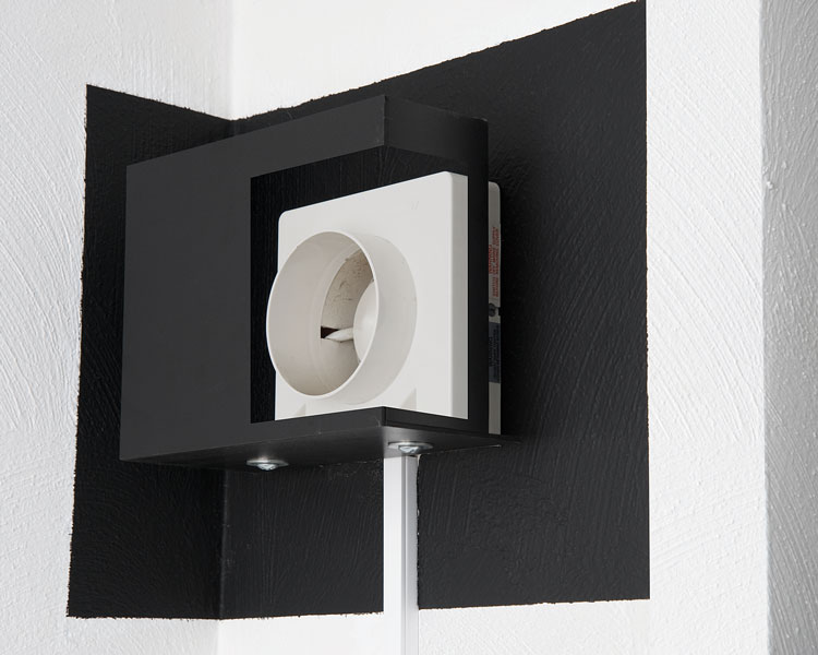

RalphLambrecht
Sep 19, 2003
14,635
K,Germany
Anybody know how to make an air baffle for a darkroom? I have just built a shed and intend to use it as a darkroom. Tim Rudman has details of how in one of his books but it is not detailed enough. Help please before I suffocate!:confused:
This is how I made mine (shown in a cut-away).
MOPS
MOPS
Aug 10, 2008
91
Dublin, Irel
Thanks for the picture of the baffle Ralph, I now have the thing in mind and will give it a go.....MOPS
