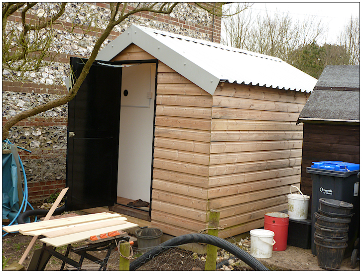

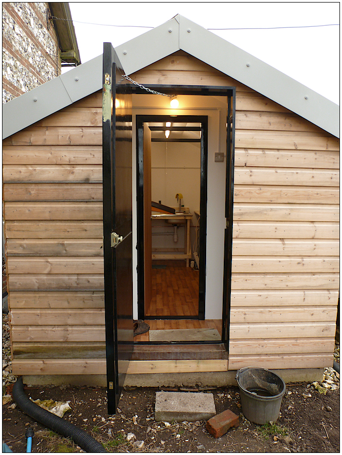

That's exactly what I did. It was quite a lot of work, but it has repaid me in satisfaction. I built a concrete pad, constructed a lattice floor of 2x3s, and stuffed the spaces with 2in insulation board before flooring it with chip board. I had previously prepared water and electric supply from the house. Then I built four sides on the same principle as the floor, and assembled them onto the base. I added a pitch roof, then wrapped the whole thing in breathable roof membrane. Ship-lap boards outside this on the walls, and metal roofing sheets on top. Shots below towards the end of construction and still surrounded by clutter. There are 2 internal shots of the finished thing on my IG account here.
I love this shed. Beautiful! The less glamorous shed nearby, the exposed roofing nails 🙃.
I've been wanting to build a nice shed in my backyard, my wife thinks I should put my lawnmower inside. Seems like a waste of a nice shed.
