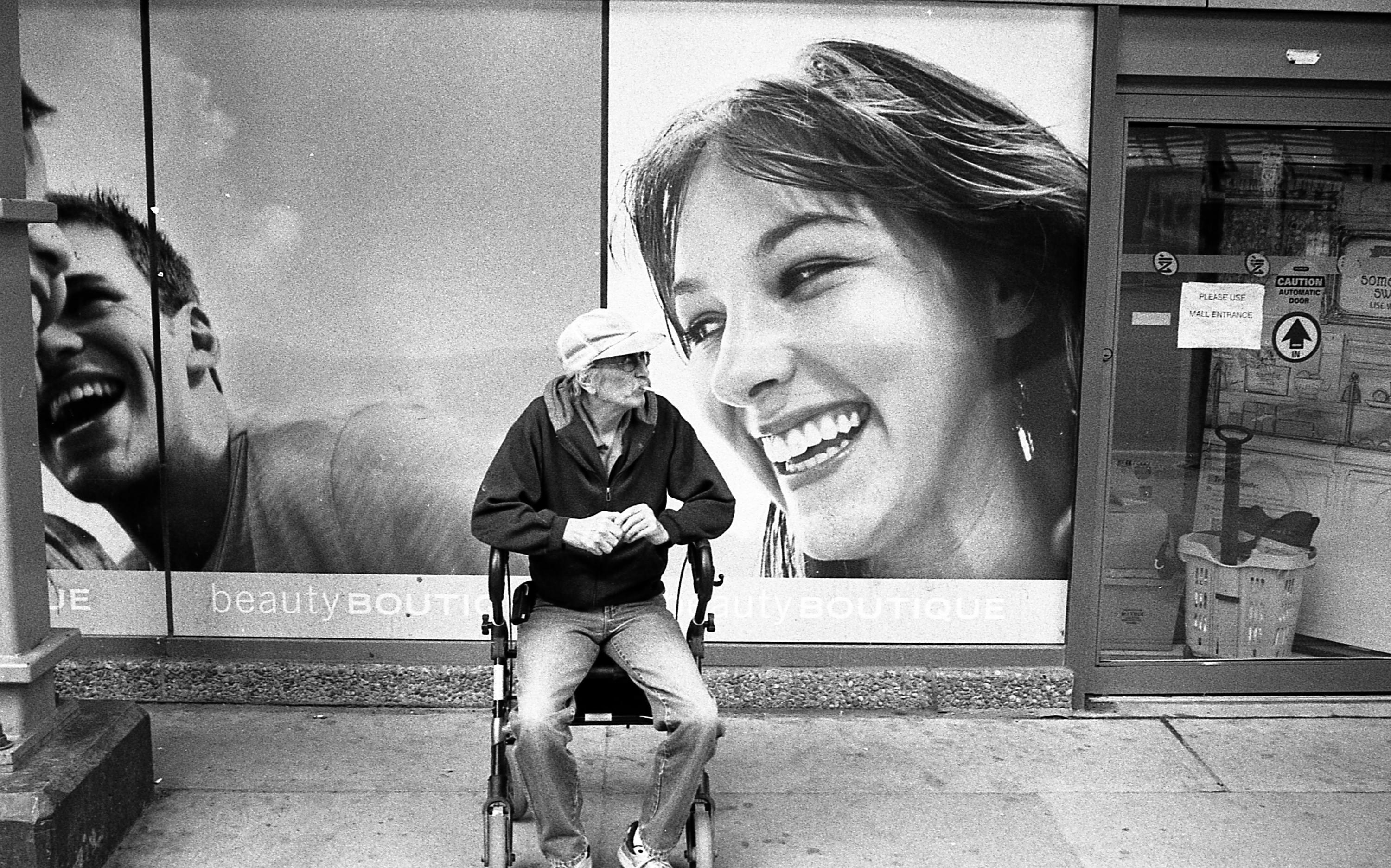

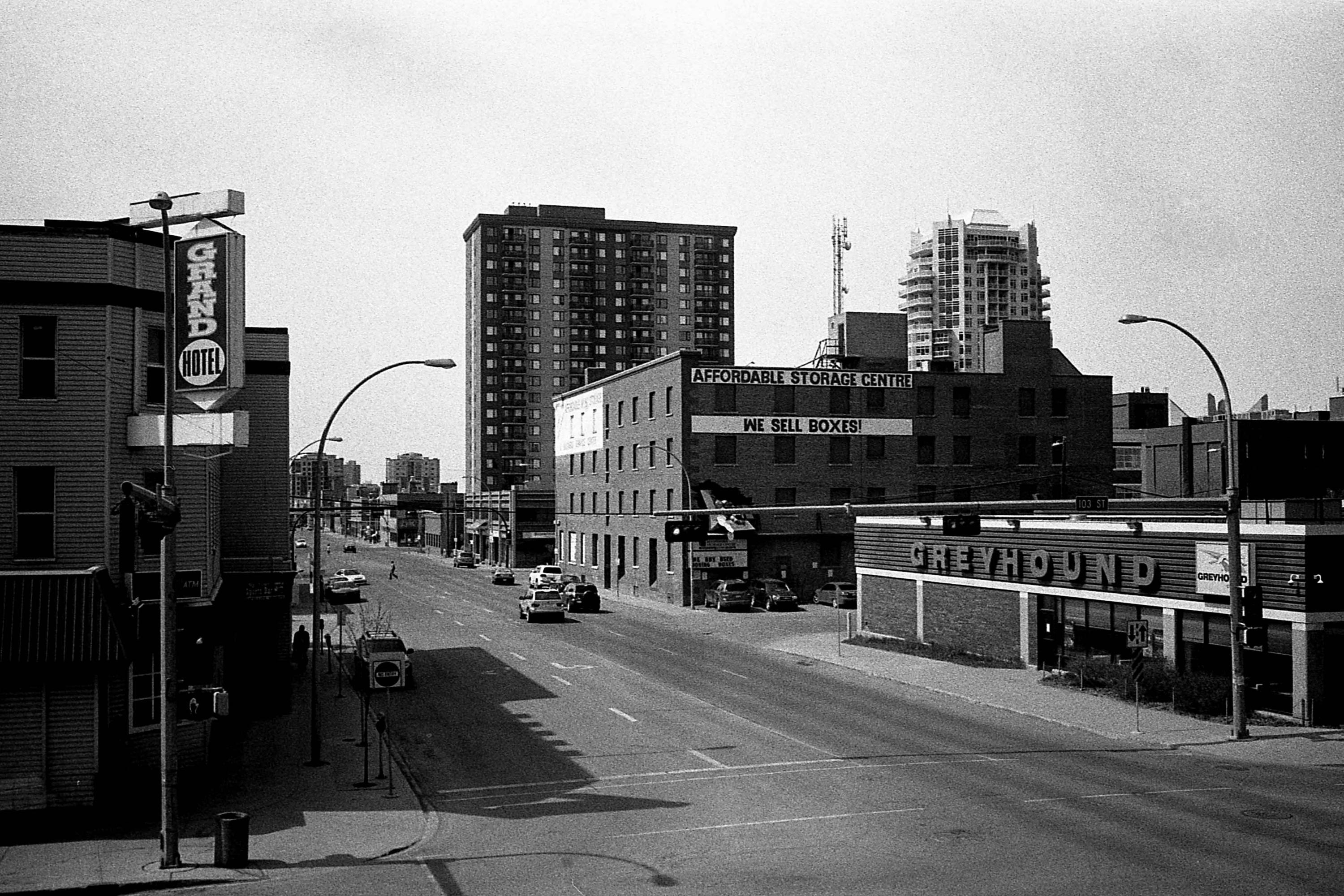

This may seem like a silly question, so apologies in advance. I've been getting all sorts of different markings on my B&W since I've began home processing...considering switching back to lab processing for consistency. One marking I notice that occurs from time to time are dark blobs on the skies in photos. I can't tell if it is just a gradient of the normal sky, or if it is a marking of some sort. It appears on the negs and scans. The rest of the sky is usually a flat overcast, which is why the darker pigment throws me off.
Another thing (this one happening more often) are random lines and markings. I'm assuming these are scratches, but would like to confirm so I can pinpoint the issue and prevent it. Here's a somewhat obvious example of it.
The odd thing is, I always read how liberating home processing can be and how much better your photos end up after you've gotten the hang of things. It's been the exact opposite for me; my photos technically aren't worse, but they're more annoying to edit and there seem to be endless frustrations. The benefit of getting the processed negatives back is negated by the fact that I tend to put off processing as I hate getting into the groove and setting everything up. I want to enjoy home processing and be happy with my negatives, but nearly 6 months in and nay. I've got some important stuff coming up this summer and am wondering if it's worth the hassle anymore. But, if you've read my previous threads, you will probably already be familiar with this thought of mine (although I did take a bit of a hiatus from apug).

I never had film developing problems. Looks like insufficient agitation to me, possibly.

Maybe. I agitate 1x over 10 seconds every minute. When I started, the Ilford beginners PDF stated to that 4x (I think) over 10 seconds every minute. I found my negs too grainy, and read somewhere (can't remember where) that I could try agitating less. I think I tried 2x before settling on 1x. I was planning on processing some HP5 tonight, I could try agitating more if that might be the issue (how much?).

Keep reading--lots of smart people here, smarter than me. All I know is I saw unwven developmet in both your pictures, and agitation is the first obvious culprit, especially with short development times.

I too see uneven development.
A couple of suggestions:
1) try pre-soaking the film in water for two minutes prior to development. Make sure that the water is the same temperature as your mixed developer; and
2) start your development with 30 seconds of continuous, gentle, rotating, randomized agitation. After that, you can transition to two gentle, rotating, randomized agitation cycles in 5 seconds each 30 seconds.
Adjust your times if the contrast isn't to taste.

Most spots/blobs are uneven development and/or drying. A good pre-wash will help the development issue, and a good pre-dry squeegee can help reduce water spots. I find 35mm is especially problematic when drying. When I started doing colour processing, in which a pre-wash is a necessary step, I really started to notice the difference it can make.
Careful how you handle the film when loading it onto reels, and what it comes in contact with in the process, so as to reduce finger prints/dust. However, I find dust on the scanner is generally a bigger problem than on the film itself.
I agitate for the first 30, then once a minute. If you're not using a stock developer solution, make sure the working solution is mixed well or else the concentrate may be mostly sitting at the bottom of your graduated cylinder when you start to pour.

I also can't quite tell from what you've said whether you agitate for the first 30 seconds or not. That's very important.
I'm not quite sure what you consider dark blobs in the shot with the sky. I see grain that could be in the pattern of light and dark areas of sky - clouds on a blue sky aren't hugely different in B&W. If you're printing with an enlarger, how does it look? If you're only scanning, it could be something from that.
In the shot with the guy sitting in front of the billboard, I also see a darker stripe running through the middle third that looks like a drying mark to me. Is your last rinse with distilled water and a few drops of photo-flo? That can help. The white spots by the guy's head on the billboard look like dust. That could be on the negative or on the scanner, tough to tell. Hanging film to dry in a very clean place is important, too.

You need to tell us everything you do in your developing process. As others have suggested good random agitation for at least the first 30 seconds is key. I found I got uneven development when I used a water stop bath. I switched to a regular acid stop and it got the issue under control.
I've had mottled looking negatives when I went in and out of a warm house in winter into sub zero temperatures. I believe water condensed on the negative in the camera. There are all sorts of reasons you can have uneven skies that is why it is imperative you tell use everything you have done.
I wouldn't believe the hype about home developing. Yes it is the way to get the best negatives but commercial developed negatives can get you 90% of the way there providing you use a fairly conventional film and shoot it in a conventional manner. If you get some niche B&W film and shoot it at your own personal EI and then try and print it in the darkroom after commercial processing then yes this can be noticeably sub par.
There were three things that really improved my negatives, avoiding "stand" developing, figuring out a good agitation method (not too fast and not too slow), and using an acid stop bath.
