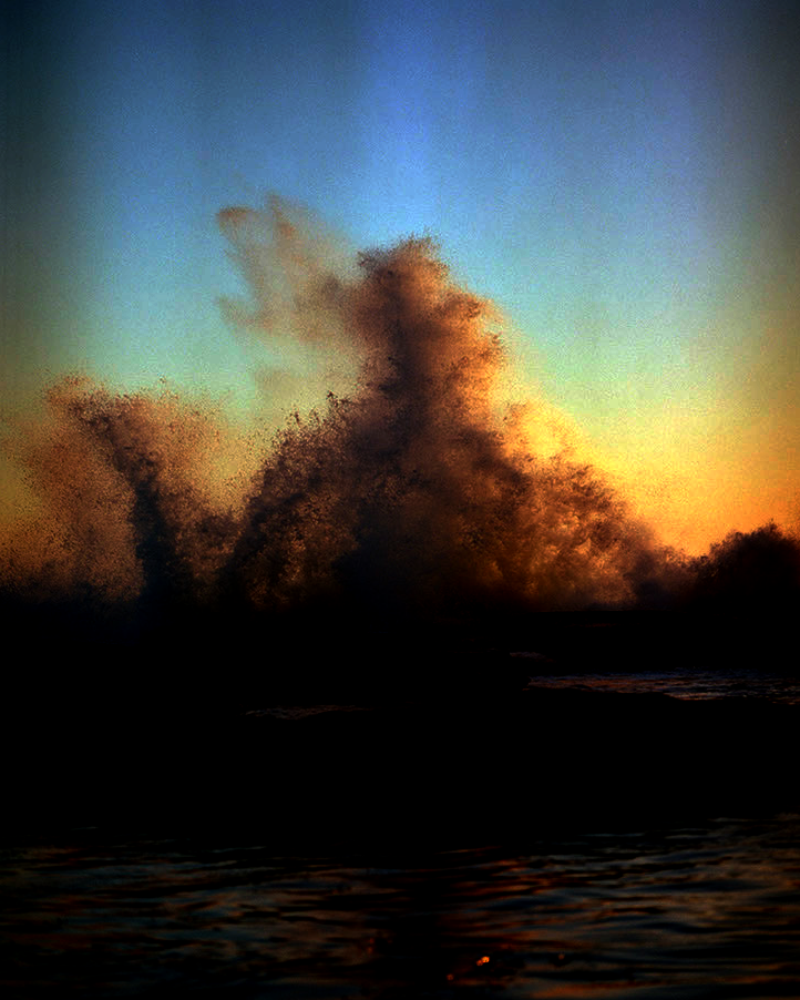

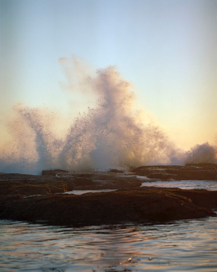

Hey, I'm hoping someone can help me out with an issue I'm having.

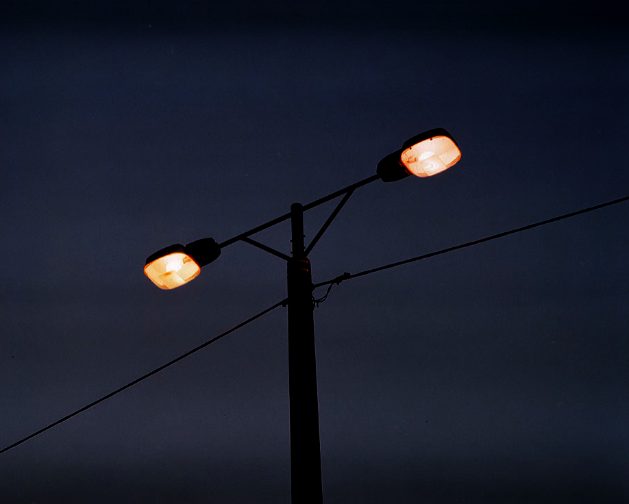

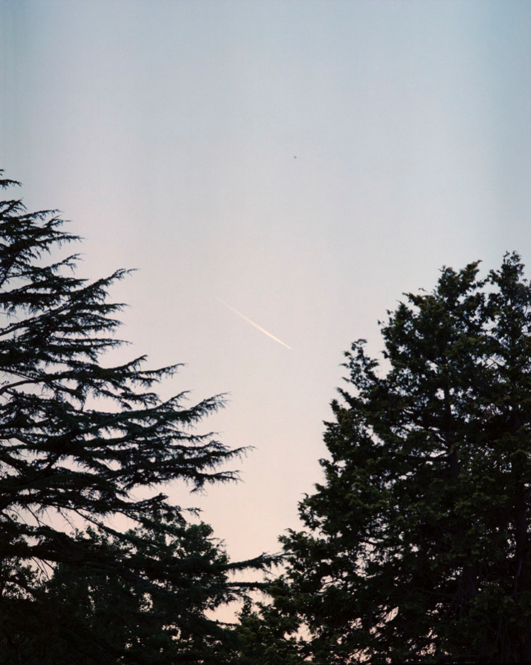

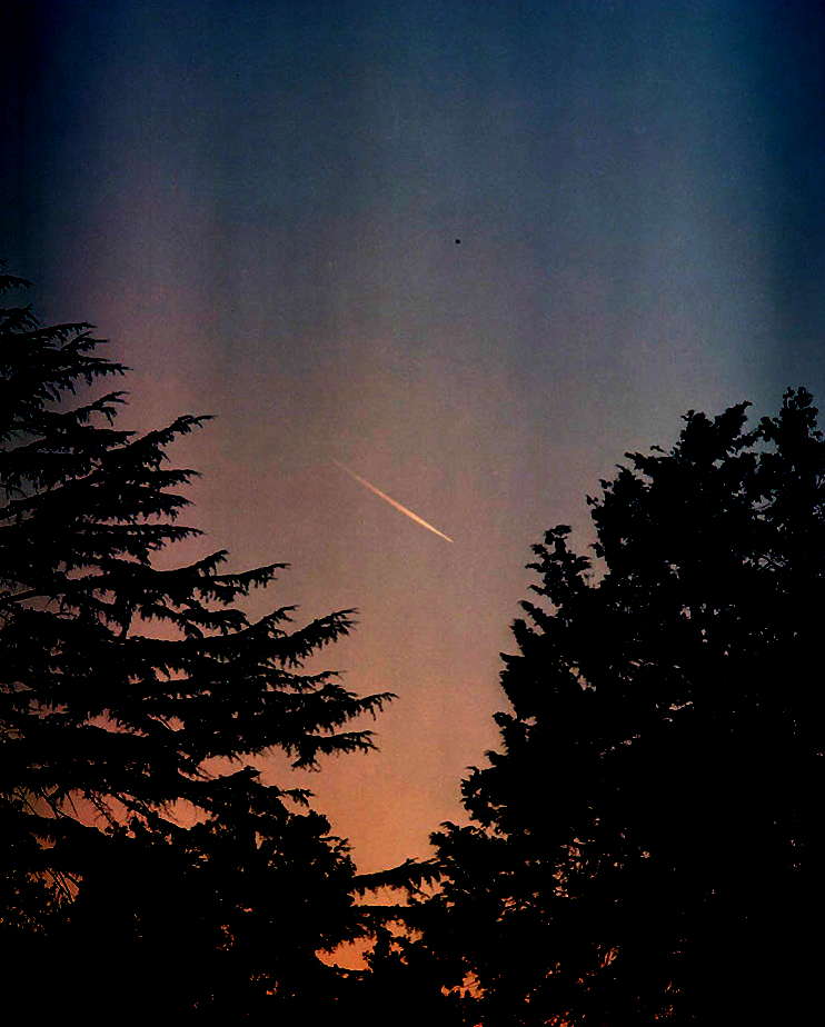

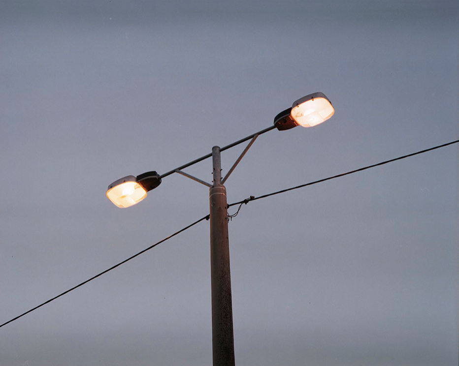

I've had a few rolls of film developed now that, when I scan the film the edges always end up darker and muddier in colour. I'm not sure why this keeps happening. In the photos I've included you can see when the brightness is brought down it reveals the variation further. It seems there are three bright strips along each photo as well.
I'm wondering if someone could please give me some insight as to why this might be happening.
These photos are from different rolls of film, Portra 160, Portra 400 and Fuji 400H
Shot on RB67 Pro SD
Developed by a Lab
Scannerd with Epson V700

Hi connorgeoff, Welcome to the forums.
Actually it fell down my priorities, but upon receiving my last batch of C41 I had the same issues in some frames. Your post is very timely in that matter.
My examples are quite similar, streaky skies varying densities as if the darkness out of frame was whisped into frame. I also had a frame where there was a cloudy darker (lighter density area).
If you take a close and deliberate look at the negative, it is there as uneven density in the sky. Orientation also was mysterious, mine being a 6x9 camera, some frames had it coming from the long side of the strip, and others were vertical.
Was your C41 developed in dip and dunk (tecnolab?) that is the case of my lab. A google search for "streaks, uneven density" brought the gross conclusion of agitation issues. AFAIK, those machines burst gas into the tanks and that acts as agitation. I was very intrigued because my issue happened with one of the best labs around. The tech even called me and was puzzled about it.
So we are two having found the same.

Check for dichroic fog on the film. Turn the negative away from you at an oblique angle, toward a light source until it reflects like a mirror and inspect the surface for colored reflections in the shape (or inverse shape) of the streaking on the negative. Just like dichroic mirrors used in color lamphouses, certain wavelengths of light can be blocked by this film that can form on the surface of the negative due to exhausted or poorly mixed chemistry.

It could be that your scanning procedure is responsible for exacerbating a very faint density pattern that would never be seen on a photographic print.

I'm guessing that this is a scanning/software problem. Try re-scanning the negatives one way, than again with the negatives turned 180 degrees, to see if the problem areas "move".

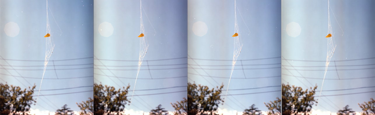

Alright so here is a negative scanned 4 times in different locations, with the auto CCR, silverfast
. The film has been rotated and moved around. The Auto density does a pretty terrible job, but you can clearly see it's on the film.

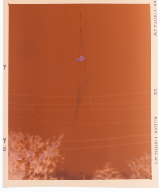

Here is the actual negative, it's a photo taken on a DSLR over a lightbox. You can see the edges are definitely lighter in the negative.

The unevenness of the neg you posted could be flare. There is obviously a flare blob in it already, but veiling flare could cause the unevenness. Your real problem though is you need to clean your scanner. That thing is diiiiirty. Clean the mirrors, the underside of the glass, the whole enchilada.

That looks more like vignetting to me than anything else.

What you're seeing is uneven developing. I have seen this a lot on 120 film developed in minilab machines. I suspect the machine don't give enough agitation of the chemical for the wider film. Minilab film processors use pumps to circulate chemistry through the tanks for agitation, but the tanks are also filled with gears and rollers that move the film through the machine, so I don't think they agitate enough for the wider film. I've never seen this on 35mm, just 120. It shows up in prints made from scanned film more than on traditional prints because with scanning we tend to bump up contrast and color higher than what you would get directly printing on RA4 paper, and that increased contrast brings out the uneven tones in the film caused by the bad developing.

Chris is always right. This is a processing problem.
Other factors can contribute like leaky dark slide felt on some brands or not wrapping tight enough after exposure and/or not keeping in a dark place
Most always it is processing and the agitation or lack thereof.

I have to say I think you're correct Chris. The 2 new rolls I got developed at a new place came out fine, so it is not the camera nor the scanner. Nor is it the film as it's over both Fuji and Kodak rolls.
I have gone back to my old lab and told them about this and they are looking into it. I explained the reasons why it couldn't have been anything but the development and they seemed satisfied and are going to see if they can fix the issue, hopefully I get some sort of compensation.
Thanks to everyone for giving thoughts on what the issue could be, it helped me a lot and although it's annoying having a bunch of rolls ruined I'm just glad it's not the camera that's broken
