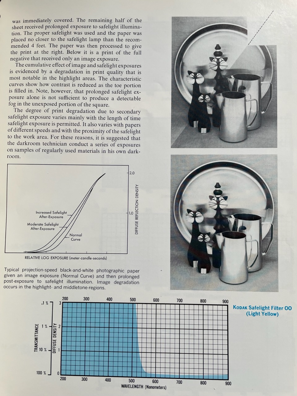

Thank you Bill and Matt. I suspected that the dark stuff was staining, but it was my safelight fogging things. If I had been in the darkroom regularly for the past few years, I would have given the weird Dektol more of a chance. As a "newbie," it added one more variable to the re-learning curve.
Bill Burk
Feb 9, 2010
9,461
Wow good timing MattKing with the resource. I’ll find the siamese cat somewhere and add. It’s really just “the” image Kodak used in earlier texts of the safelight test that illustrates how a bad safelight can ruin a print. Siamese cat and shiny chrome plates still life.

Siamese cat is in the Kodak filters guide…
MattKing
Apr 24, 2005
55,127
Delta, BC Canada
Thanks @Bill Burk
I wasn't familiar with the Siamese cat illustration, so I confess I couldn't make heads or (cat) tails of what you were on about! 😉
