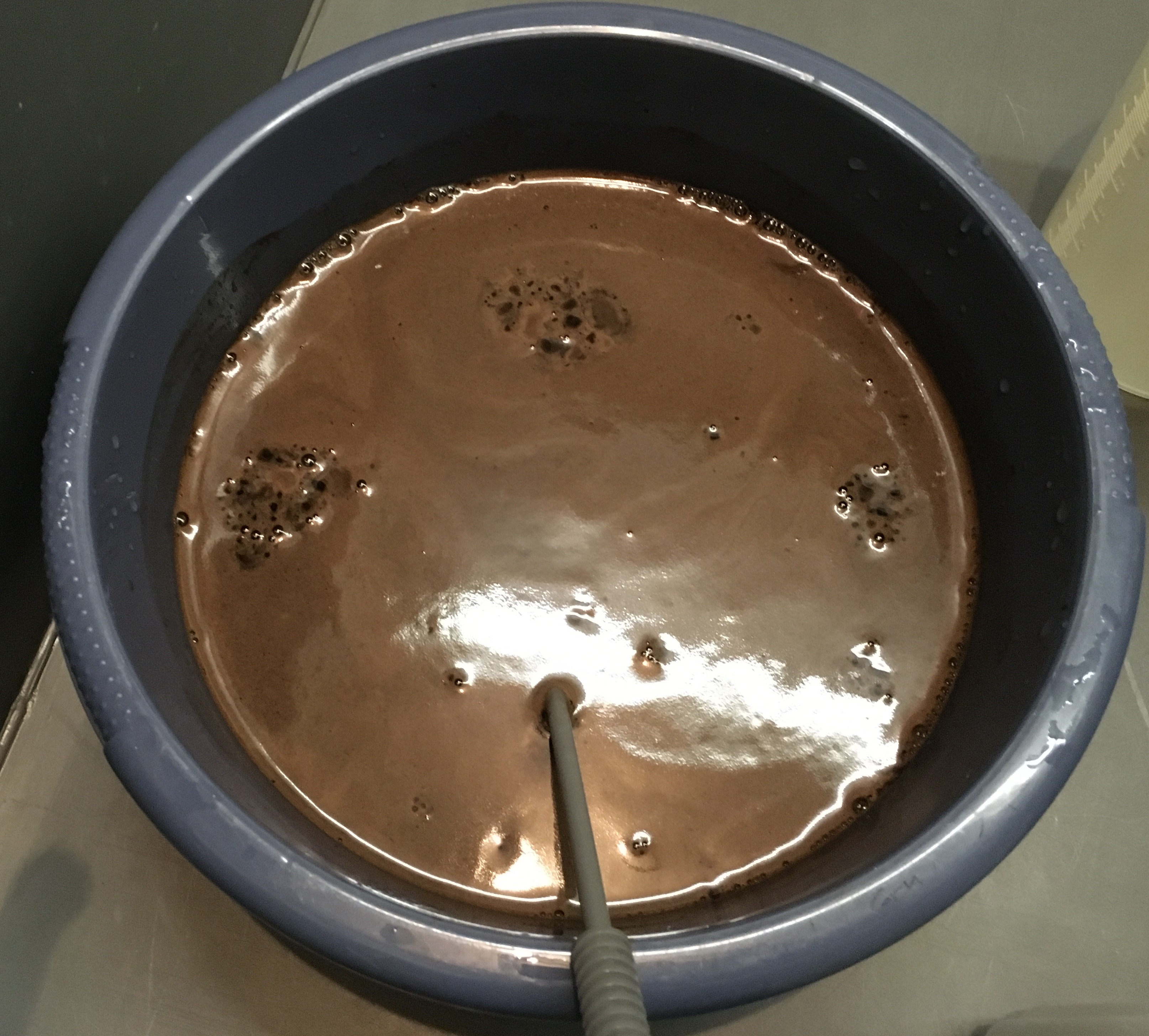

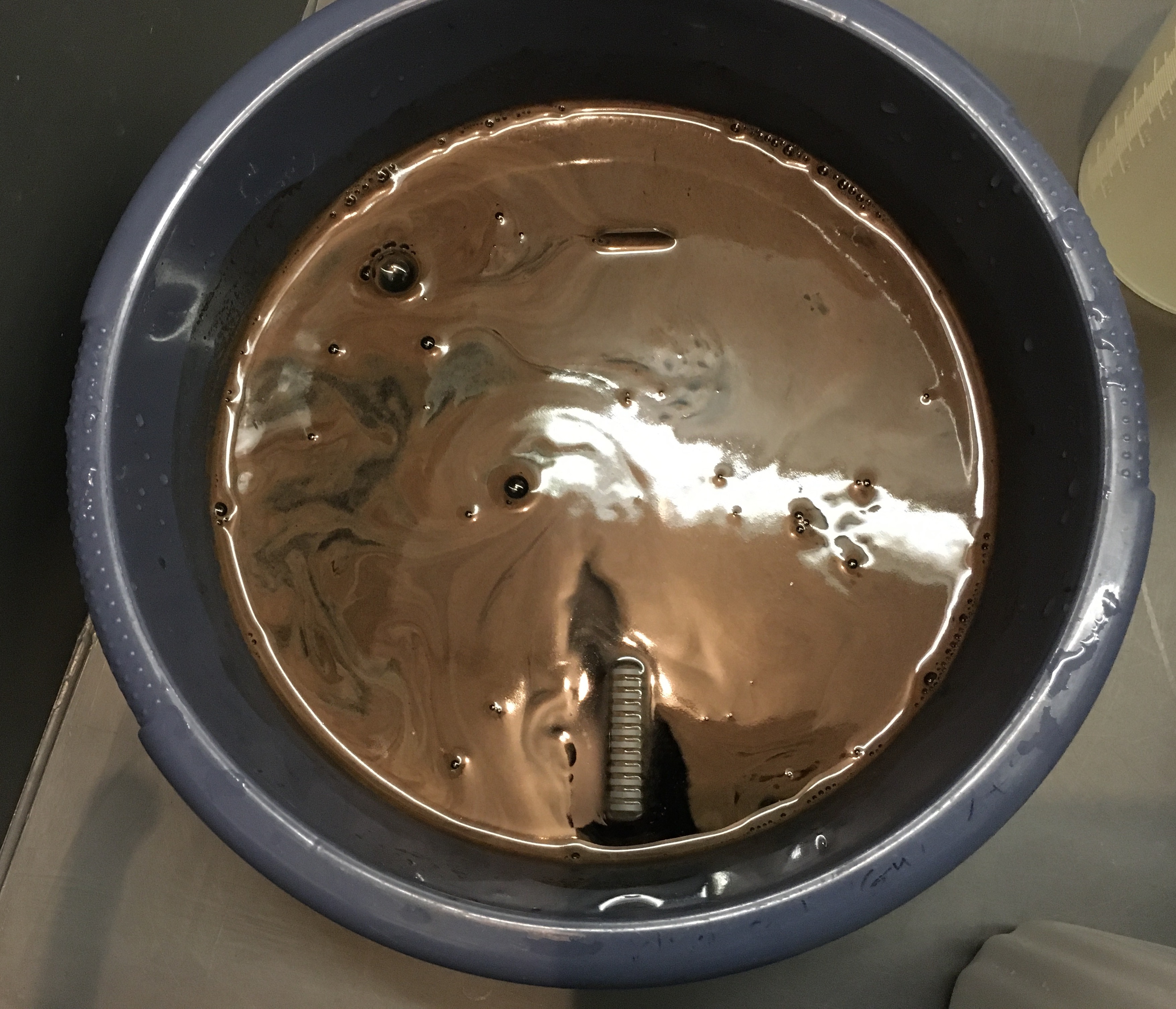

for those who can't imagine the Dektol mud, here the color of the package I mixed in 2021.

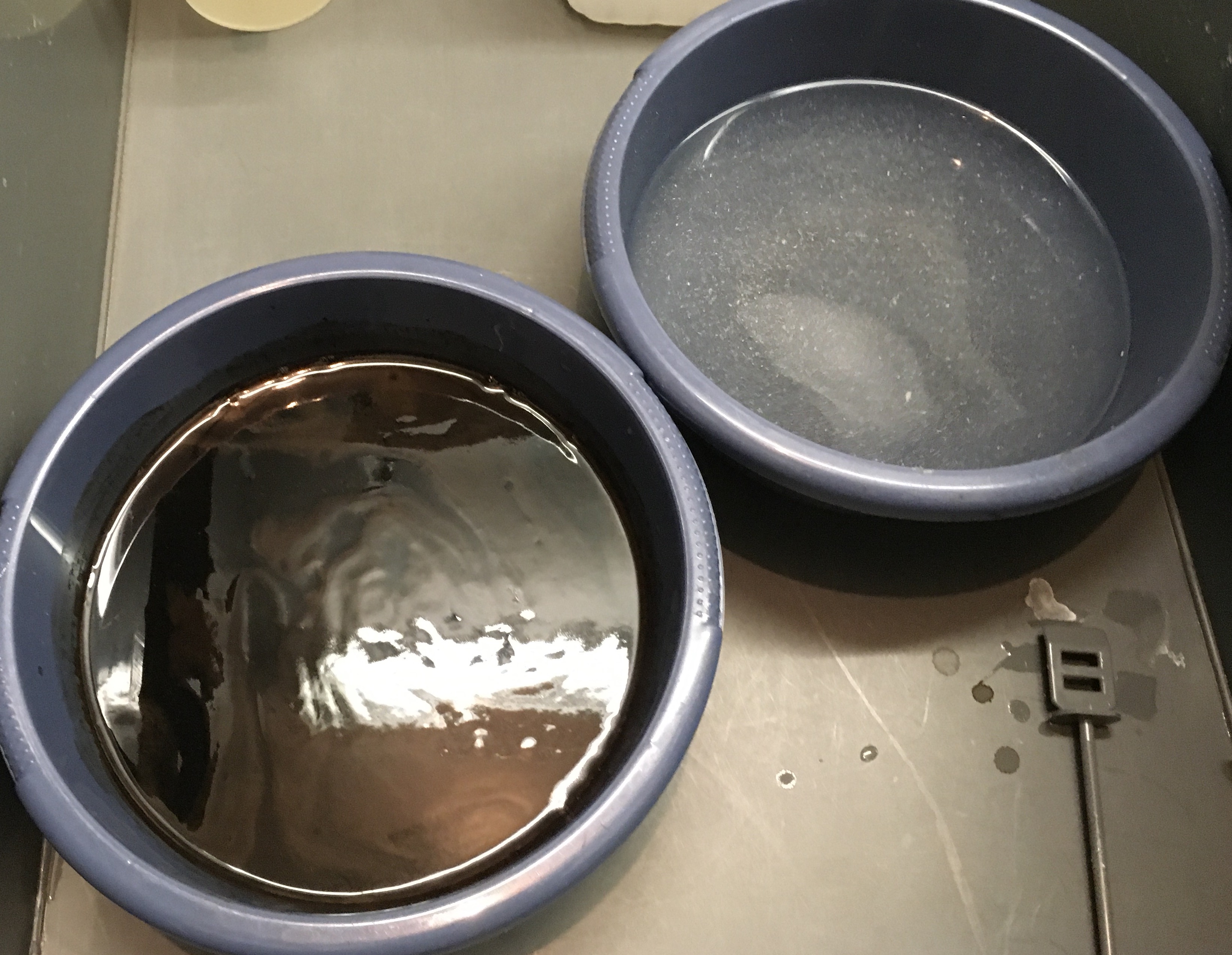

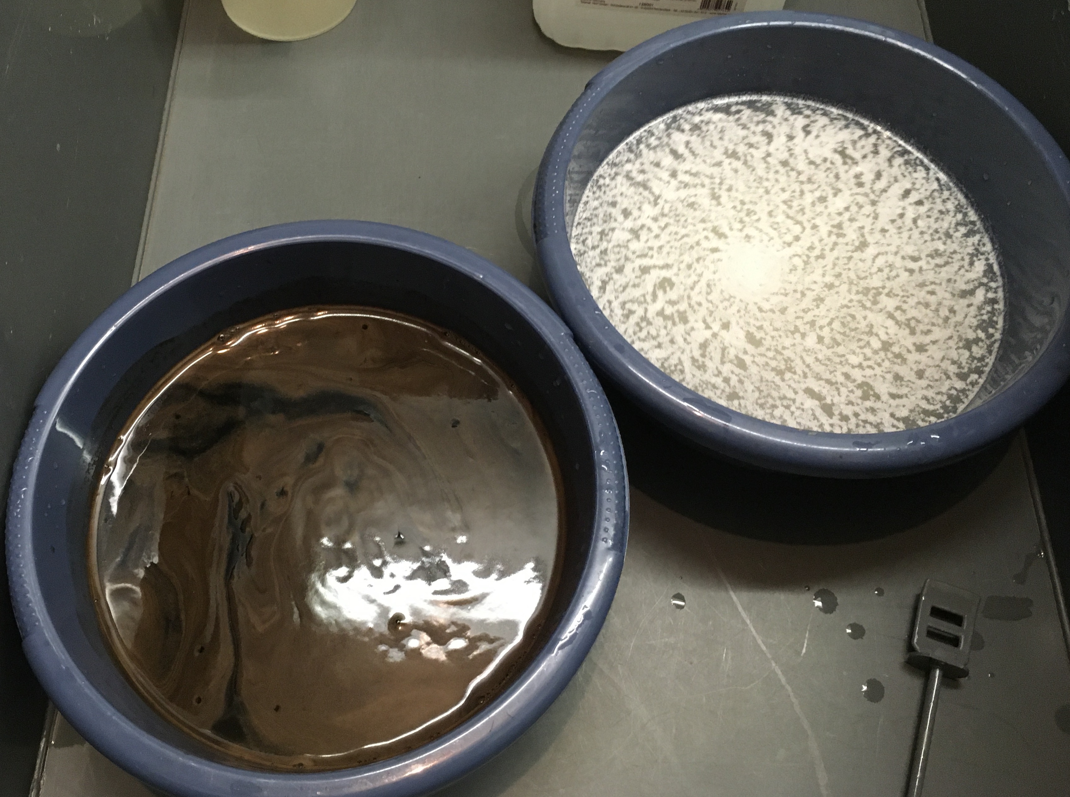

and the color of a second package bought at a different time for comparison (immediately after mixing and about 5 minutes stirring)

Exactly! It looks like a big pot of Espresso. Here's the odd thing to me. In my case, the really dark stuff at least dissolved properly, while my "whisky and water" batch had all kinds of particulate matter that never broke down.
Thanks for the pictures, I can't even get my phone images sized right for the forums. Sheesh!
