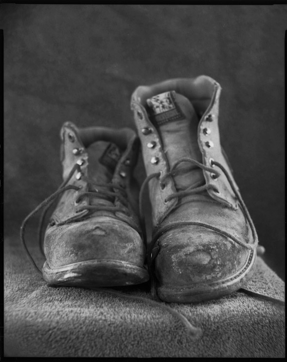

Gotta love the boots! I woke up this morning feeling just like the boots look. They also look like they gotta have a good "bokeh".

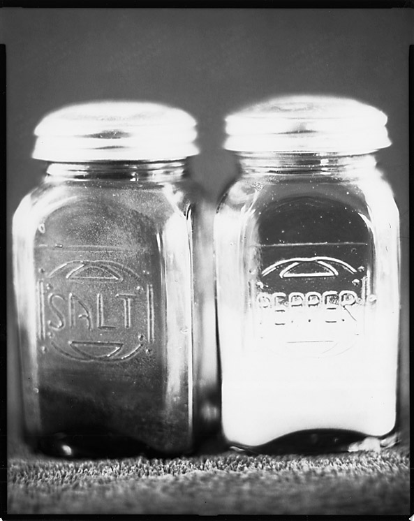

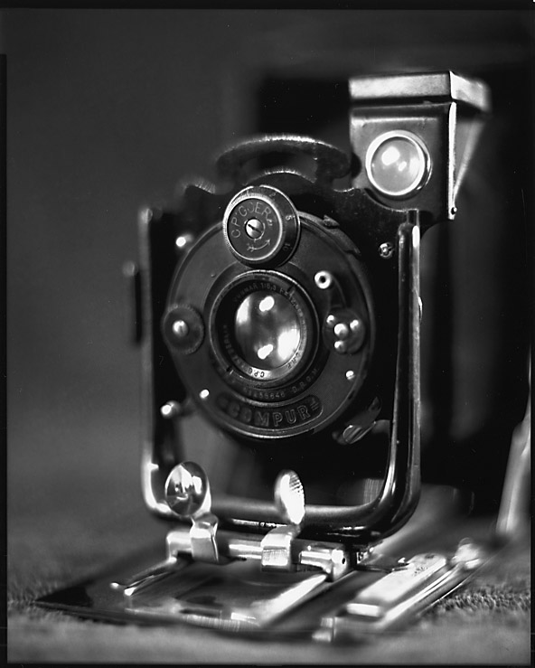

I should have listened to John Nanian. He told me printing paper negs was addicting but I jumped right in anyways. I'd never made a print from a paper neg before. I was stunned at the results! The resulting prints are beautiful. Better than the PS scans. I'll tag a couple on here but I doubt you'll see much difference from the inverted scans at 32kb. The highlights blocking is a little more apparent in the print scans only because they are more "truthful" than the inverted scans where you can set your highlights a bit lower. But I also figure that's the nature of the beast with this type of photography. One thing I did notice in the prints that I liked a lot. Where the petzval had left a glowing edge on an out of focus highlight, the prints made it even more "glowy". A result of the extra diffusion the light gets traveling through the paper. I also discovered that a paper that prints slow can have a dramatic effect on the contrast at the printing stage. Kind of works in reverse. You can gain contrast with the slower paper.

This is very revealing,
1. the photos are lovely
2. a less expensive way to introduce large format to students
3. the paper photos have their own charm, which can be exploited with further experimentation.....I think the qualities we "Galliites" have grown to appreciate in the old classic lenses could be further enhanced with the paper negs etc....make 'em glow, Jim! :smile:
