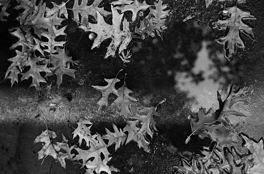

I just finished off a 1 liter stock with replenishment, running 22 36 exp rolls of double-X. I can report that it was economical. The replenishing was simple and stable, I tracked the pH over 6 months with replenishment and it increased only 0.08, less variable than D76 or D23 stock. Development was consistent between first and last films, also more so than D23 or D76 stock. The grain was more pronounced than D23 or D76 imho but with somewhat better edge sharpness. Example of D96 Double-X on overcast, late afternoon, late fall day.
thanks for the hand-on report, and the sample images (the leaf looks great).
seems that your experience matches what the theory would suggest. better buffering due to the higher borax content and lightly more grain and better sharpness because of the lower Sulfite content.

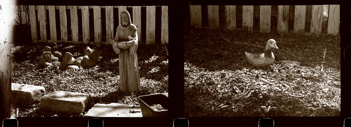

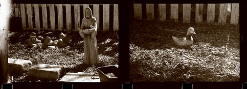

Here's a bit of 16mm Eastman Double-X in stock D-96.
Minolta 16ii, yellow filter
XX D-96 stock 7'
V800 scan
It's a great combo and I recommend anyone using D-96 to pair it with Double-X and vice versa.
XX D-96 stock 7'
V800 scan
I agree! I was quite pleased with my results:
Now I'm going to have to give 1+1 a go!
