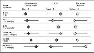

I guess this chart is known by most of you:
