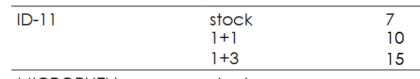

That suggests that D76 is somewhat more active than ID11 at higher dilutions. Perhaps the Ph is higher. Maybe Ilford skimps on the borax. Or perhaps the times could be the same and the results virtually identical. Maybe they think, if you use D76, you want your film to be lower-contrast - especially if you water it down.
(Times shown from Delta 100).
Keep in mind when it comes to pushing or any EI other than ISO speed, there are no standardized criteria so recommendations can be quite different for identical materials / developers.
Ilford’s and Kodak’s standard agitation recommendations are also a little different, which could have minor effects on recommended development times.
Then there’s just the fact we don’t really know what each manufacturer does to determine recommended times for other manufacturers’ products. Some of it could simply be extrapolation. It could also be plain wrong. Consider (one example) for a long time Ilford’s recommended development time for its own Delta 100/DD-X combination was wrong. Etc.
I did not look at the other times, not sure why at stock same times but not a bit, quite of difference with 1:1 1:3 and push.
I would assume that, since it's Ilford's data sheet, their times for their own film in the numerous developer listed are using their own agitation scheme. They almost certainly did the testing themselves.

Is there a posted ILford ID 11 formula? I've always been old that ID11 and D76 are the same, while Ansco GAF 17 is different . I asked a couple of AI that I have access to and both reported that the formulas are Identical in terms of active ingredients with Kodak having anti clumping additives but could not ID what those are. Must have addressed in an older threads, when I have time I will plow my though them. If the same, still no sure whey ILford recommends more time in ID 11 at 1:1 1:3 and pushed to 800.
