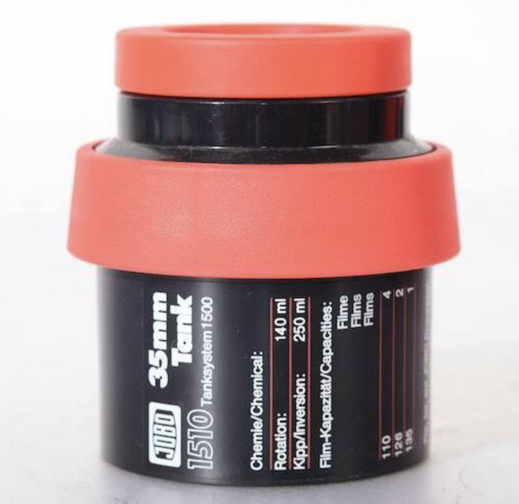

I have had consistent results using 100ml of D76 stock in a roller drum loaded with four 5x4 TMX-100. Just lucky I guess.
