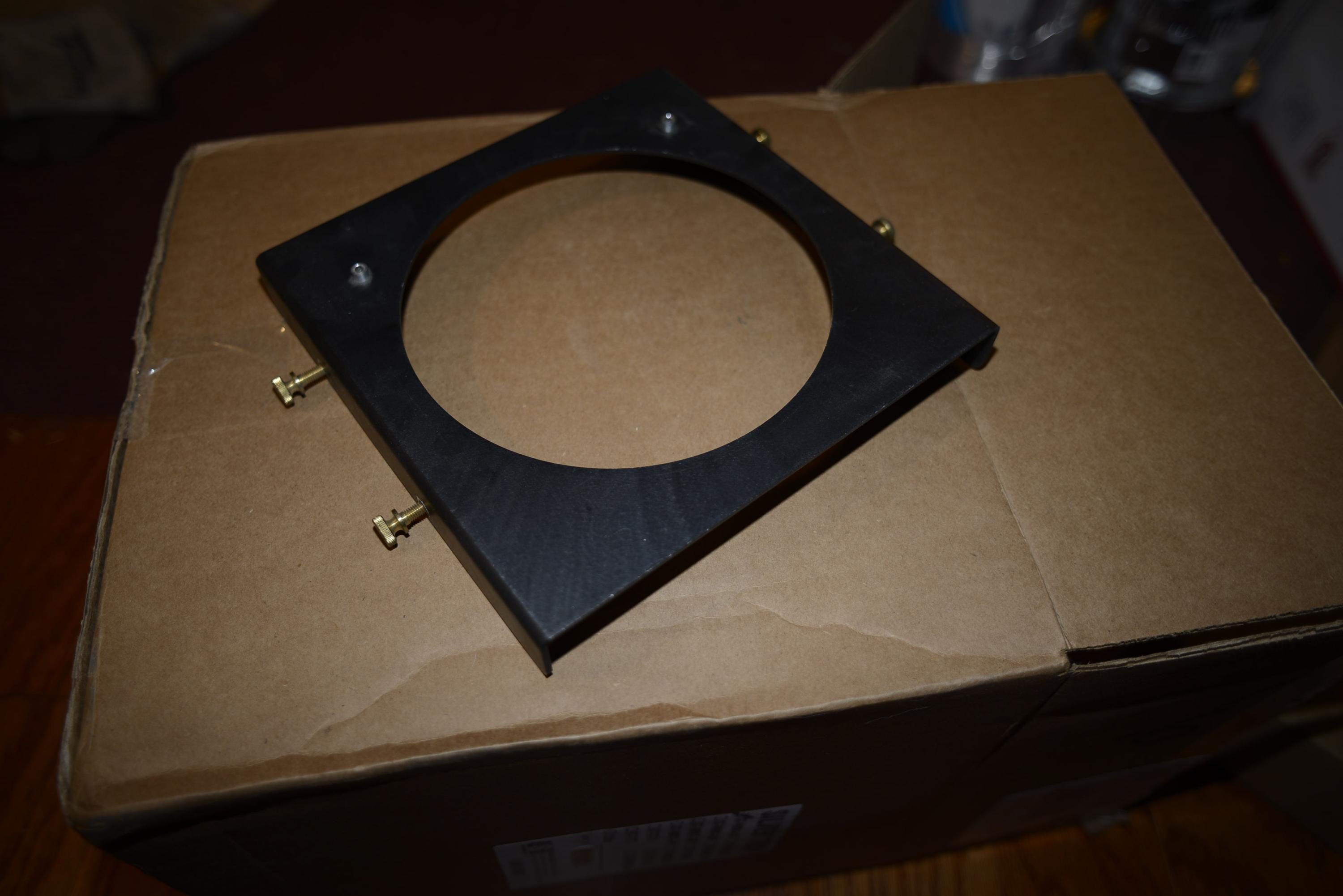

You could get Alistair Inglis's (Dead Link Removed) Omega carrier to enlarger registration plate. This has pins installed to allow the negative holders to be removed and installed in the same place. It's very useful for masking work. It also mounts above the existing plate, so if it's a little bent it won't matter.

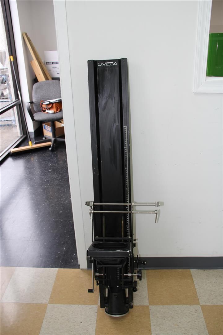

Where are you? I have a D5XL with a dicro II head, a turret, and all the neg carriers (eleven of them) and lens mounts one would ever need and I cannot hardly give the thing away in a metro area of six million people.
Seriously, I am not saying you need to buy mine, but in ten years, I could have found you 15-20 for anywhere from $50 to free. And, yes, some people want $500 for them, but they don't sell. You are going to go to a lot of trouble, and just as much expense to try and repair the thing as just getting another chassis - if not a whole enlarger. Just my opinion ... :wink:

Mr. Gebhart, I am not sure what device you have there, but how am I to properly align the whole enlarger with a bent negative stage?
In any event, I'm probably a year away from building out the room so there is some time for something to fall in my lap.
It sits on the negative stage, but if it's slightly bent it won't matter. It will give you a smooth surface for the negative carrier to sit. The screws on the side provide a pressure fit against the frame of the enlarger.
Gotta agree with David here. There was a guy in greenville who had four of these he had pulled out of a lab, put them on craigslist and couldn't get rid of them. They even had Ilford 500 MG heads. I thought about driving to greenville just to grab the heads. I think he finally junked them. I probably see at least one if these every two months popping up locally. I cant believe you cant find one. Its so sad that no one wants this stuff anymore.
