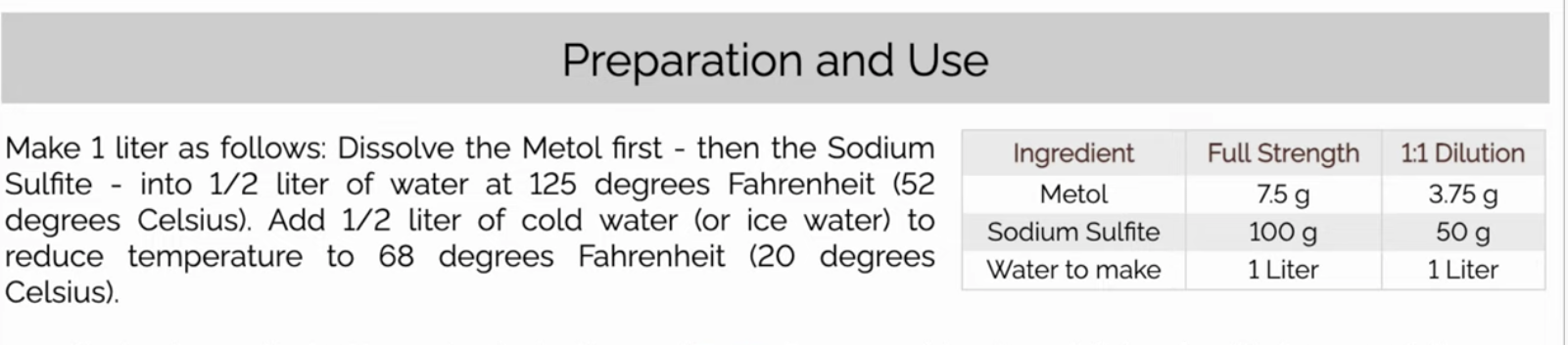

I am trying to mix some D23 developer. I am going to use this recipe:
Then I found another YouTuber saying instead of Sodium Sulfite, it should be Sodium Sulfate Andydrous !!
Now I am confused. Which is the correct one?
Could some experts here help me with a definite answer before I mix my first D23 please. TIA

Hi Yossi,
The correct chemical is Sodium SULFITE, anhydrous.
to be clear, Sodium Sulfate and Sodium Sulfite are very different.
Sodium sulfite, whether anhydrous or crystaline is NOT the same as sodium sulfate.
anhydrous just means, 'dry'. If left in air, sodium sulfite will absorb some small about of water from the air and no longer be anhydrous. Whether you use the anhydrous form of Sodium sulfit or not when mixing D23 will make little difference. If you're feeling pedantic, you can adjust the weight to account for the added water...but, again, it doesn't really matter in D23.
but definitely use sulfite NOT sulfate.

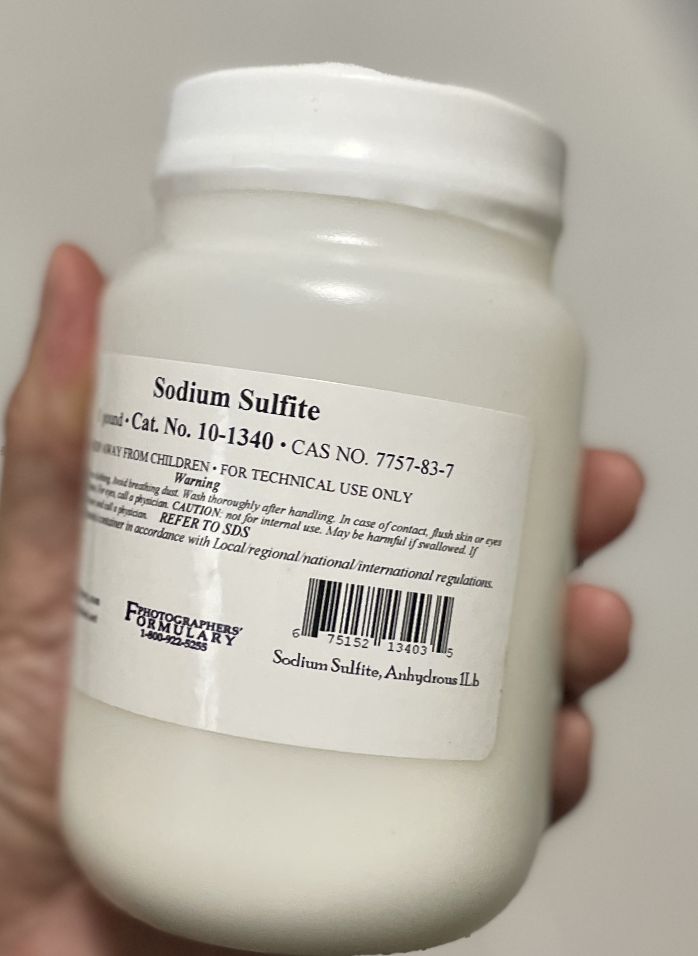

Yay! I got the correct one, luckily.
Thanks Zathras & BradS for the confirmation. D23 here I come :D
