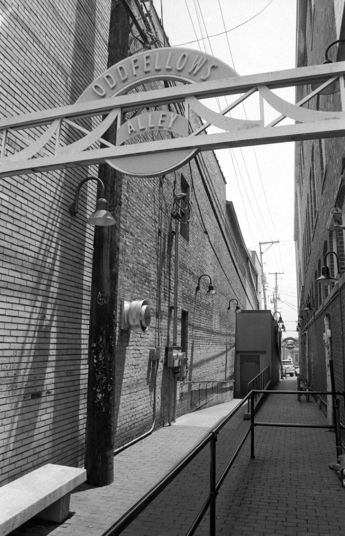

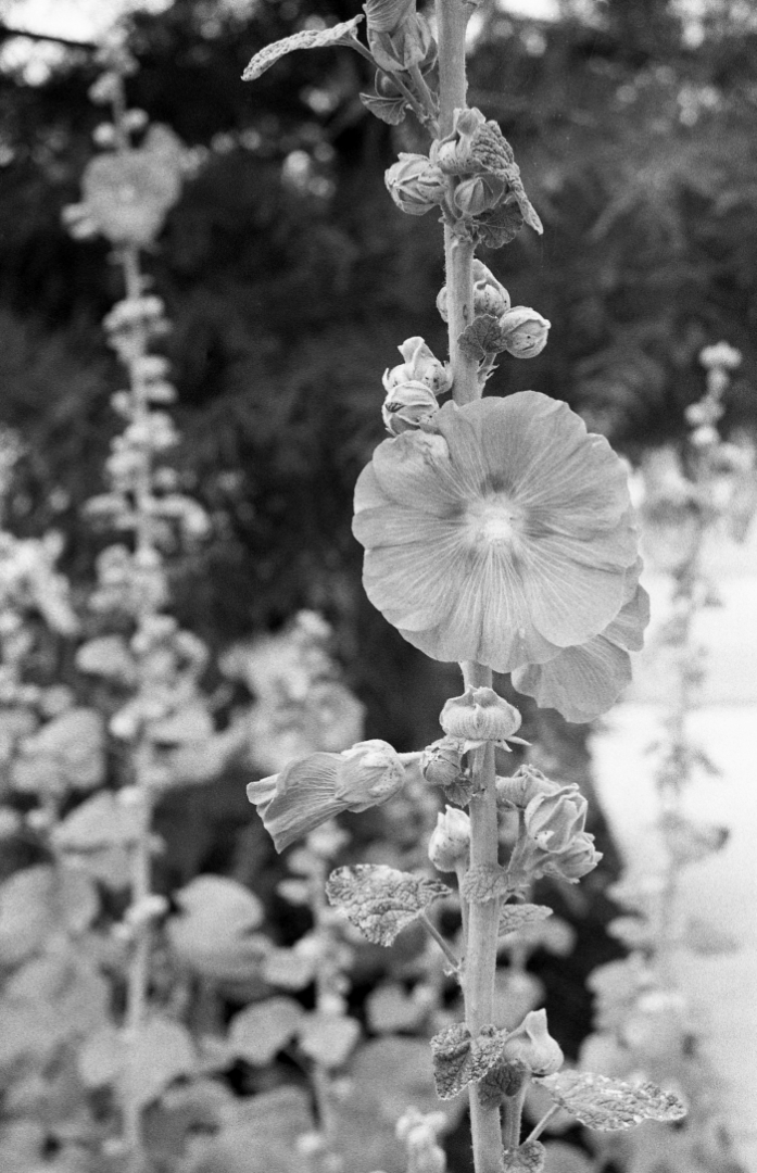

D-23 is an excellent choice for DIY compounding and an extremely flexible developer especially when considering its usage at higher dilutions with contrasty technical films (cms 20, hr-21, copex, etc).
I'm getting some Deja-Vu vibes going on here because the quality of this negative takes me back to four years ago when I was playing around with Pyrocat-HD. The scale of tones look visually compressed, soft, like Pyrocat developed film yet without the coloration and with a boatload of detail. I am now very excited to see how these frames print.
Using it at 1+1 in 35mm does indeed give that 'soft working' feel. Legendary stuff, that Metol.
N75, 28-80mm f/3.5-5.6
Kentmere 400, D-23 1+1 14'
V800 negative scan
Edit: D-19 is another interesting developer in the Kodak range, albeit a more complex formulation. Pretty much the exact opposite of D-23, D-19 produces extremely high contrast negatives... best suited for reversal processing! đź‘˝

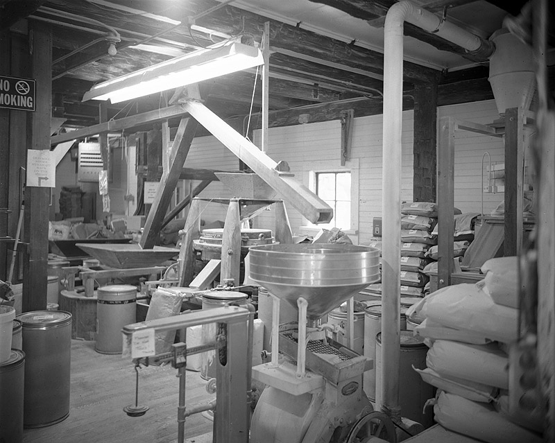

Anniversary Speed Graphic, 150 mm Componon, .EDU Ultra 400, D-23 replenished stock.
Wow! the details are everywhere in this image. Was the film overexposed a little or was this at box speed?
V800 negative scan
View attachment 358490View attachment 358491
Delicate tone results with the flower and then a retro feel with the alley image. Very cool. D23 has that retro feel to it that I like.
I used D19 a few times back in the early 90s. Pretty stark stuff.
I noticed Kentmere in the description. I'm going to be transitioning for a little while to that film. Recently received some 100 speed versions of it.

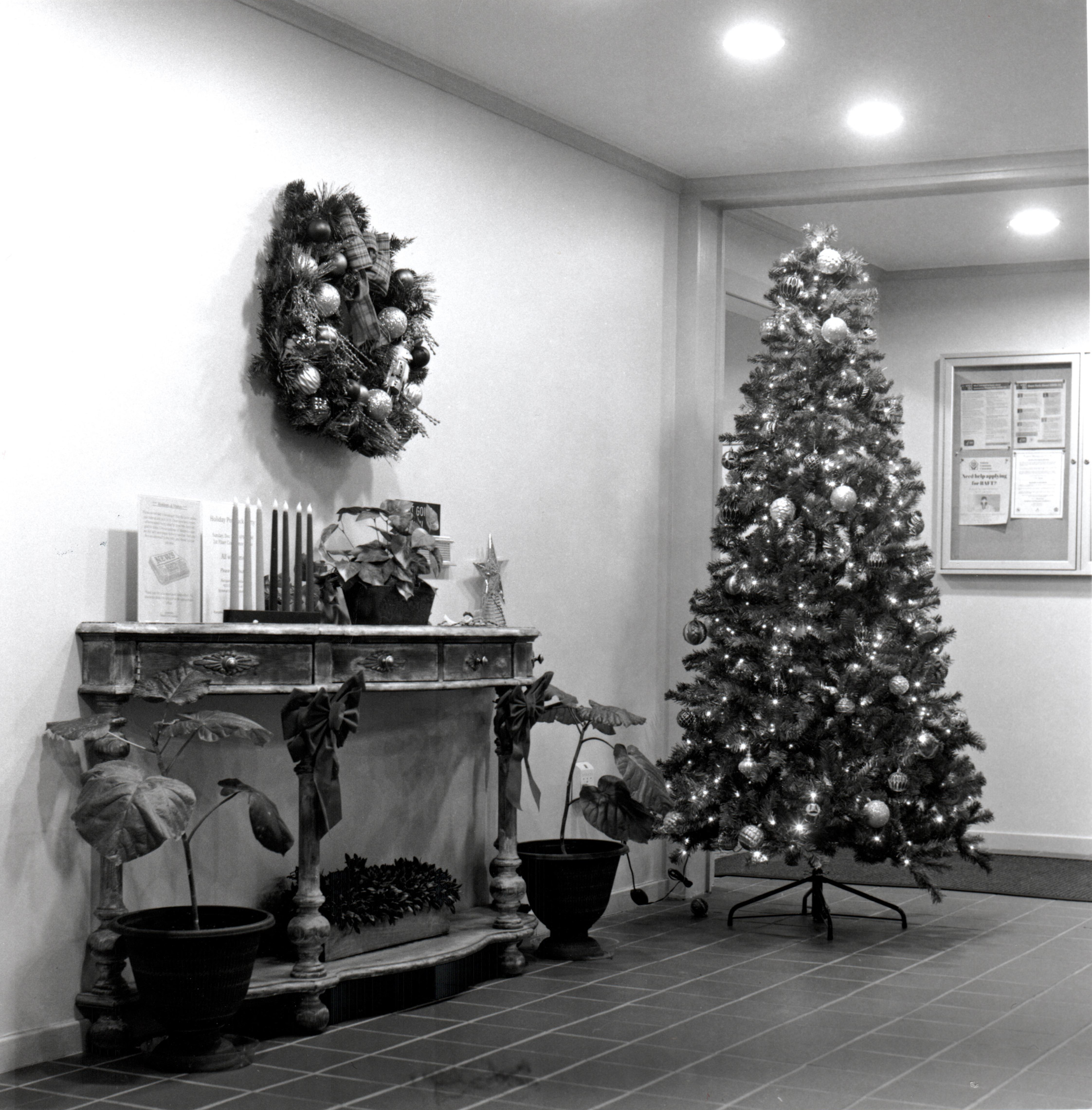

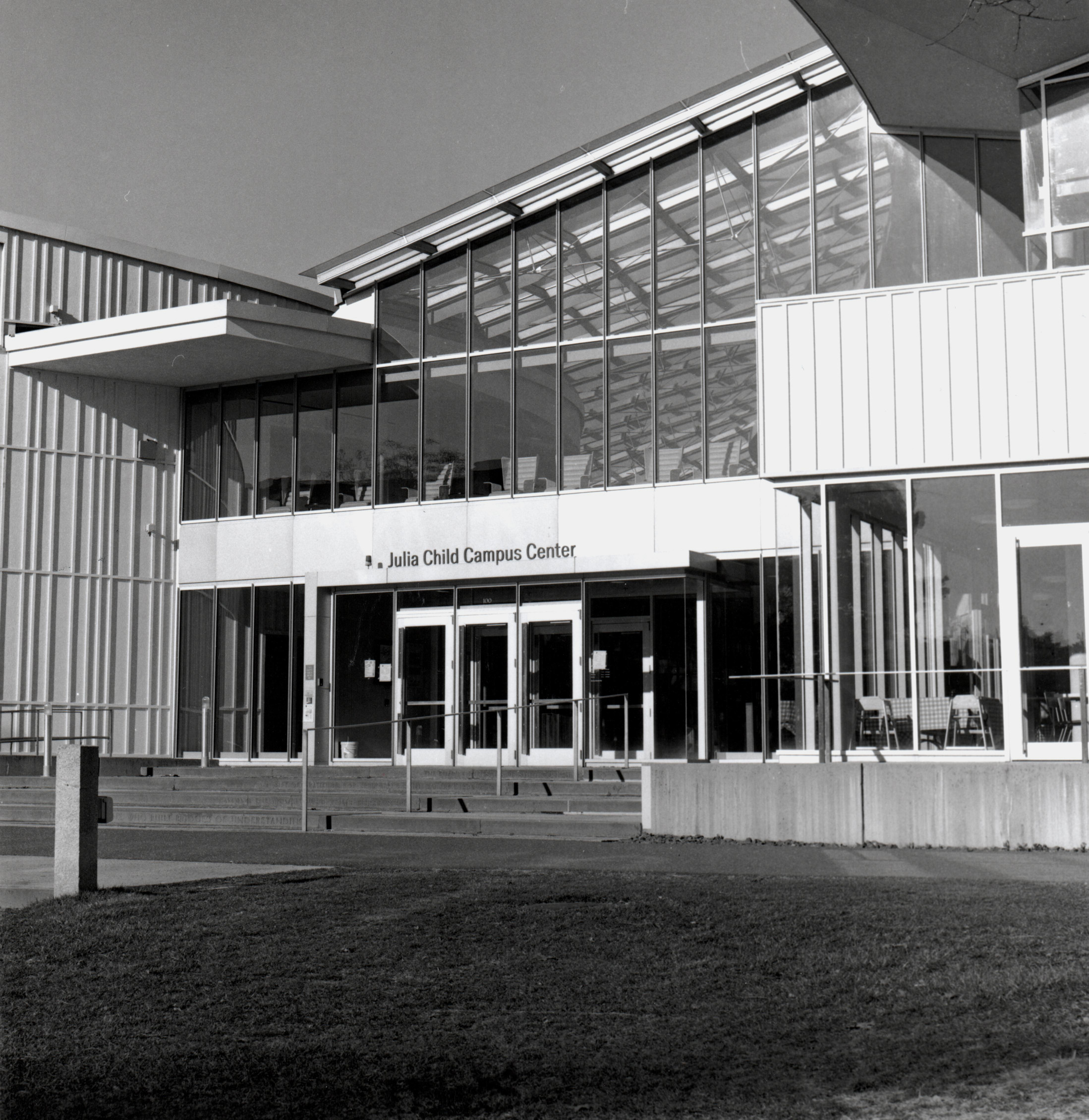

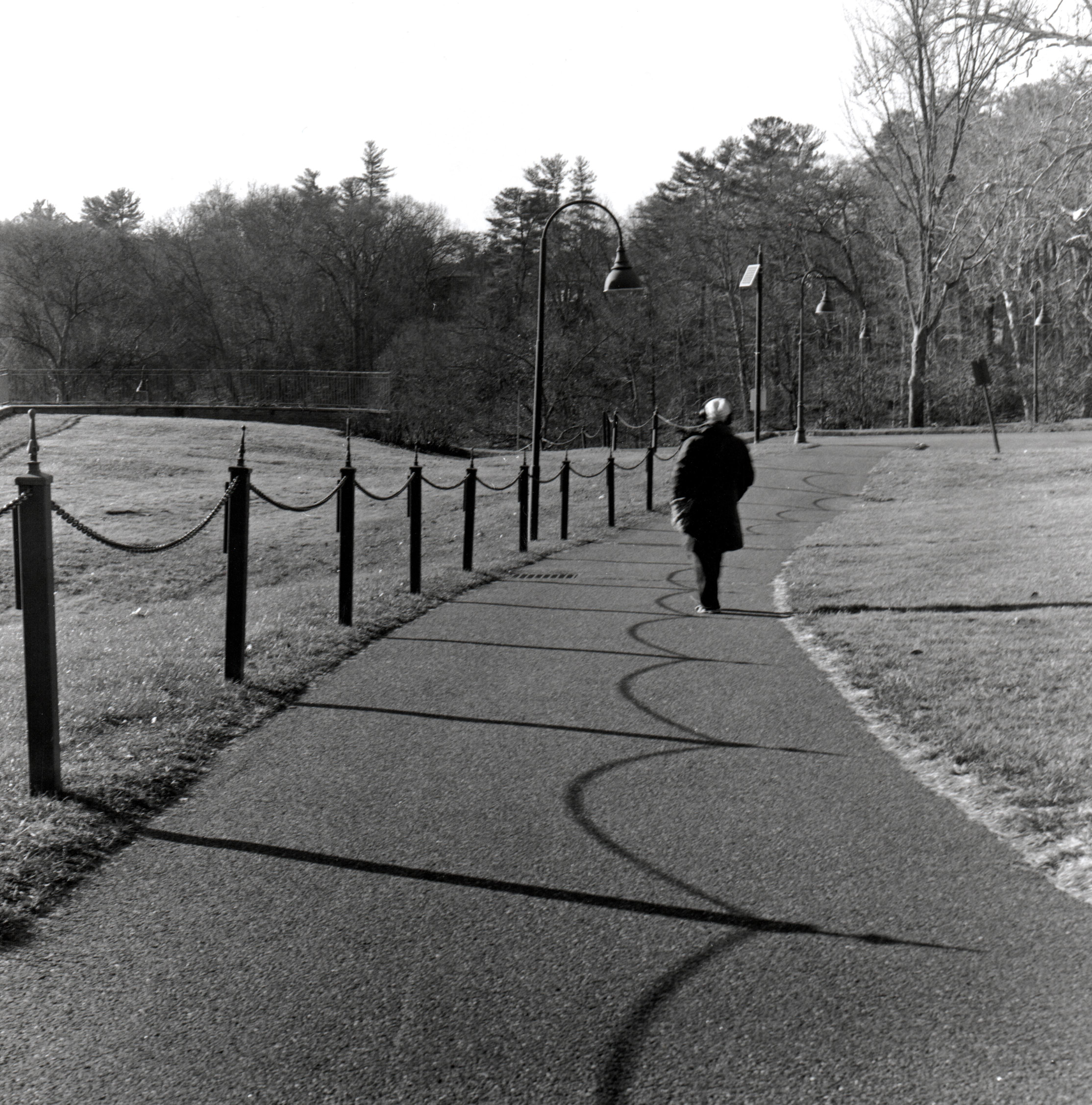

My flatbed scanner sometimes has issues with scan lines. I finished printing last night and came up with these images from the D23 negative:
Rolleicord TLR, Ilford FP4 plus at 100 ISO, D23 1:1 for 11 minutes at 68F/20C
Ilford Multigrade IV, pearl surface, 8X10 printed as 8X8, Lens height 16in, F:11, around 7.5 - 9 seconds, Liquidol for 2 minutes at around 70F/21.6C
1. Julia Child Center at Smith College. Partly sunny that day. 100th at F:11.5. - Did a slight dodge on the grass for 3 seconds.
2. Lady came right out in front of me on path. Quickly did a reading and made the shot. 1/25th at F:16
3. Repeat of the Christmas tree scene. 1 second at F:8

When I got to 40- or so 8x10 equivalents processed, I dumped half of the working developer, and refilled with fresh 1:1 stock.
And this is why you never had trouble. You were effectively just reusing the developer within the usual limits and keeping it about halfway through the reuse limits.
I metered at box speed (true speed for Fomapan is widely given as EI 160-200) and placed the shadows on Zone III.
Is this all from that one light which somehow has managed to light the whole room or has the replenished D23 contributed to such an openness, or are there other sources of light ?
It's been fifteen years since this was exposed, but I recall there being a window out of view, no direct sun through the window but some sky lighting. D-23 is a speed losing developer, so I doubt it's just because of D-23. As I recall, this was soon after I started using reduced agitation (every third minute) and developing with time as if a 2 stop push, which seems to pull up the shadows about 2/3 stop compared to what you'd get from the same developer with normal 30 second or one minute agitation cycles.
Thanks An interesting way to pull up shadows and useful with a developer that may be similar to Perceptol in terms of speed losing
