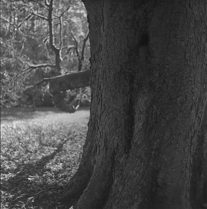

Shot a roll of Pan F at EI 25 and developed it in D-23 1+10 for a total working solution of 500ml, with the addition of 0.2g of Sodium Hydroxide. Total development time was 18 minutes at 20C. Agitation was three seconds every two minutes. Here is an example from the roll. These shots were all shot with my Rolleicord, handheld. The increase in acutance is impressive. Thank you Raghu, for the tip!

I'm quite pleased with this combination. Pan F is wonderful in this on bright, sunny days it seems. Once again, thanks for the tip.
