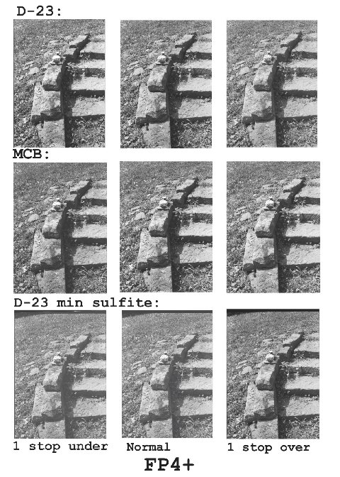

These developers respond to FP4+ (or the other way round) in much the same way as for the faster film. I don't know from personal experience about FX-1. When I have finished the FP4+ series, I will post results as another ring around.
gainer
Sep 20, 2002
3,699
So here they are. The ring around pictures were scanned directly from the negs. I used the Phot Shop Pro stretch function on each one so differences in contrast would not get in the way of the comparison. The detail was scanned from an 8x10 real photographic print from an MCB negative and is a sample of what one would see in a 16x20 print. I used the MCB neg because there is no sulfite in that developer. I don't know what kind of treatment would produce grain in an FP4+ negative, but sulfite pretty surely will not reduce it.
One can see detail in the shadows of the enlarged sample that are lost in the coarser resolution of the ring around.

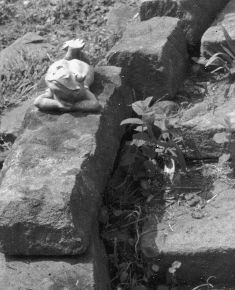

It seems the shadow detail in the enlarged sample was lost as well, along with the rest of it.
