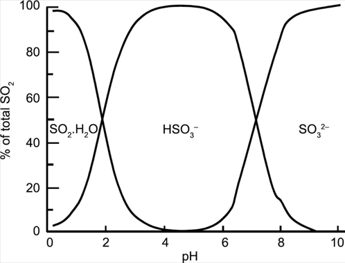

... What does happen is if you use a fairly strong stop bath after a high-sulfite developer like D23, is that sulfur dioxide will be formed. At a low pH (<4.0 IIRC), sulfite will break down into sulfur dioxide....
Is it possible that you are confusing Sodium thiosulfate with Sodium sulfite?
Sodium sulfite (Na2 S O3) protects hypo (Na2 S2 O3) against acids and prevents sulfur formation.
No. Please see this diagram:
Indeed. And you now perhaps understand also why acid fixers tend to be buffered at pH4 or a little higher.
Please note also there is a difference between:
1: Breakdown of thiosulfate in, among others, elemental/solid sulfur, a.k.a. 'sulfuring out', visible as a white to very pale yellow precipitate in a bottle of fixer and/or caked against the walls of the bottle
2: Breakdown of sulfite into sulfur dioxide, in gaseous form, which is evidenced by a pungent/stingy smell.
We're talking about #2 here.
