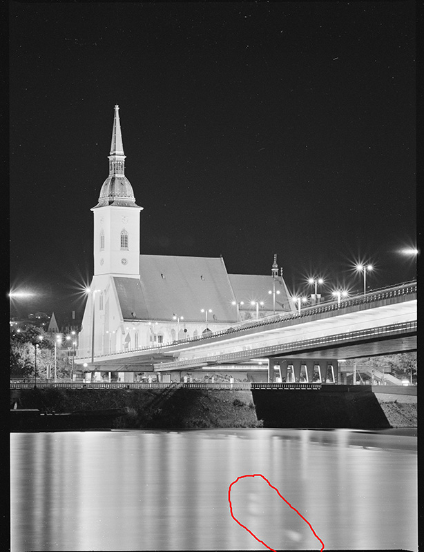

I bought CZJ Sonnar 180/2.8 without MC. In front glass element of this lens I see three little bubbles. Are this bubbles problem for image quality?
I see spots in the photo with this lens. Are this spots caused by bubbles in lens? Could you see attached picture, please? Thak you very much.

Even without having seen them, I think there is no chance that these bubbles will effect image quality in any way.
Did these spots occur in other pictures as well? (Nice shot, by the way!) To be 100% sure, you can post a picture of your front element so we can have a look on the bubbles, but as I said, I would not bother but enjoy this great lens!

Optical glass is difficult and expensive to make. Hence a few small bubbles are not considered to be a defect. Artifects on the surface of a lens or interior to it cannot be imaged by the lens so you will not see any spots.

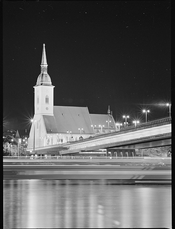

Second picture is here, same place, little-bit later, from same camera position on tripod, moving boat on the river, exposure time 1 minute, f16.

I can attribute each of those spots to particular street lamps. Do not start tearing a lens apart based on one photograph, especially when a few rolls of film could thoroughly test the lens.

Last night, I was at the same place. I did two photos of same object. After inspecting negative, I see nearly same spots on the water. I think, that spots are not on water in real eveview (exposure on the film was 4 minutes, my eyes are not possible to record this long time to one frame :D). I think, that spots are from bubbles or lens flare, but I used lens shade. I want to scan other pictures from this lens and I will check spots. I will post results later.

Those spots are not from bubbles--if bubbles cause image defects that severe, then the many thousands of Zeiss, Leica, Angenieux etc lenses that were made with a few bubbles in the glass are horribly defective and no one should buy them. Bubbles used to be considered a sign of quality in glass lenses. They are also not lens flare. If you look carefully, there are two sets of street lights that would not make a reflection across the entirety of the water as most of them do because the bridge would block part of the light. Those two lights line up exactly with the spots.

It is very unlikely there is a relation between bubbles in the glass and the artifact of your picture as these bubblle are very far from the focal plane.

Everything is OK. On another images I dont see any spots. Thank you, all.
