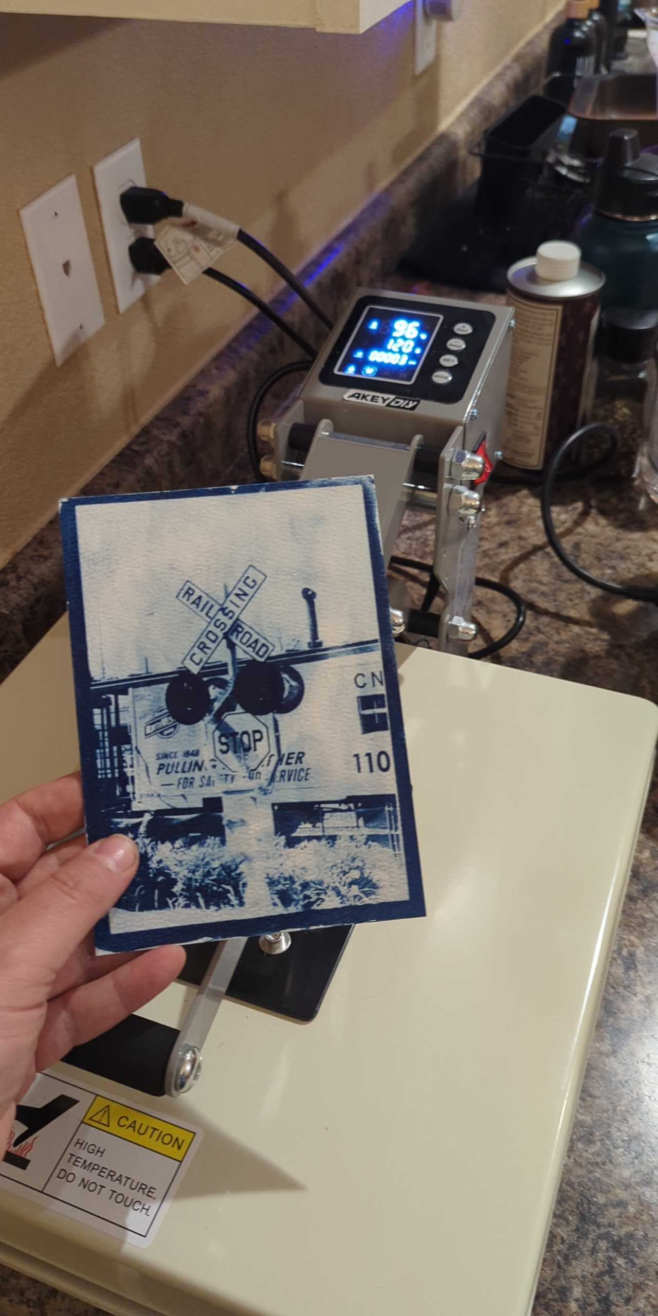

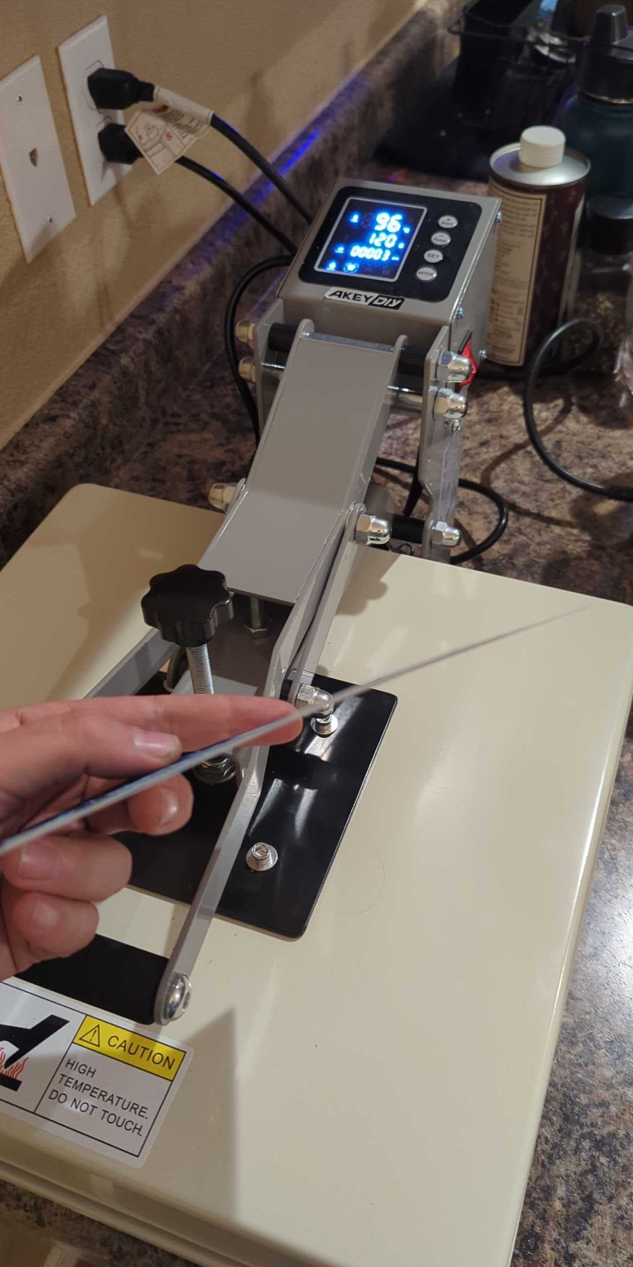

I just bought myself a t-shirt press to flatten cyanotypes and it arrived today! Here's a sample print. Man... I wish I had taken a "before" photo because it was a mess. My biggest annoyance with cyanotype was that I couldn't get them flat. With this thing I get them flat in 2 minutes.
I got this idea from a couple of YouTubers that use a similar t-shirt press to flatten FB prints. I don't currently print FB paper, but I thought it might work well for wet watercolor paper. I tried 2 minutes at 90°C and I'm really happy with the result.

I have a press like that one. I never need to flatten fb prints, since they come off my drum drier flat, but it does mount photos way better than an iron does. When you use an iron, you almost always have wrinkles at the edges. You don't get those with the t-shirt press. And it's also way faster - I mounted a dozen 8x10 fb prints in about 15 minutes with it.
