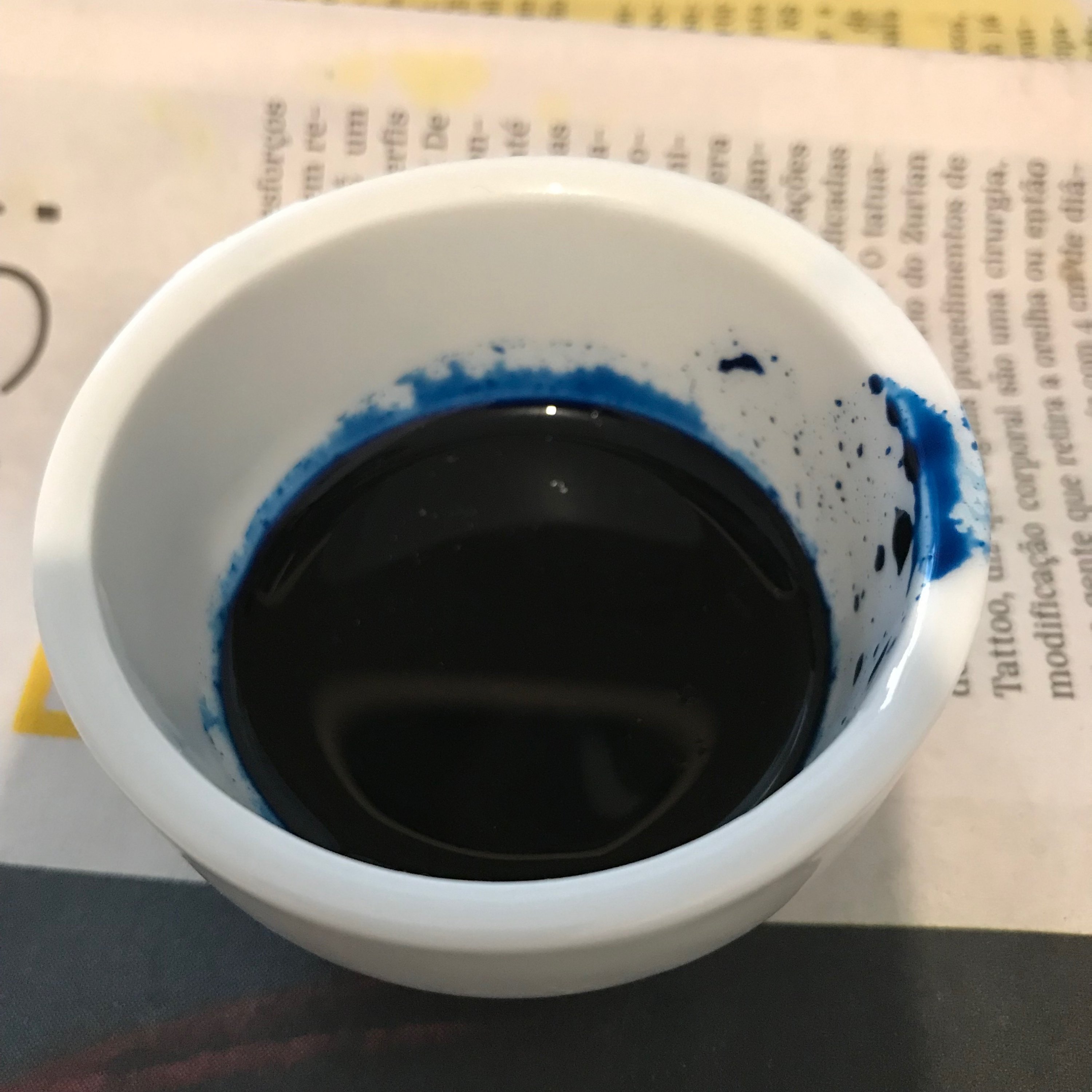

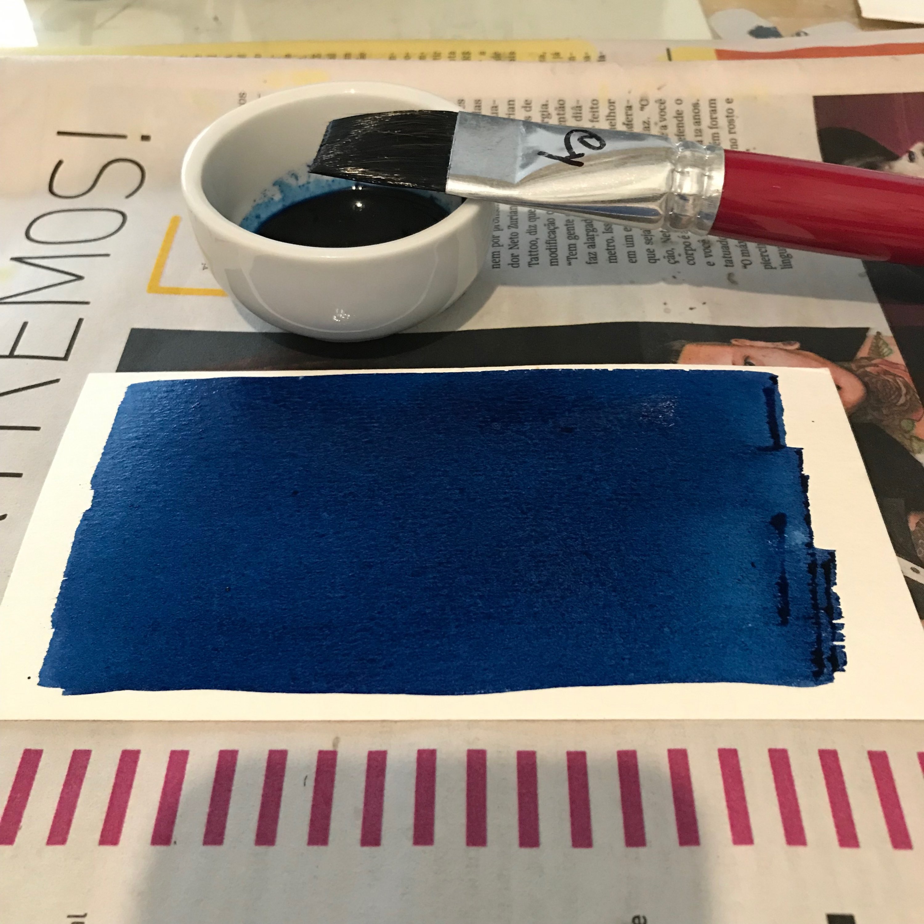

Much to my surprise, the "yellow-green coloured solution", as described by Ware, did never show up; instead, I got a bold, dark Prussian blue solution (see pictures).

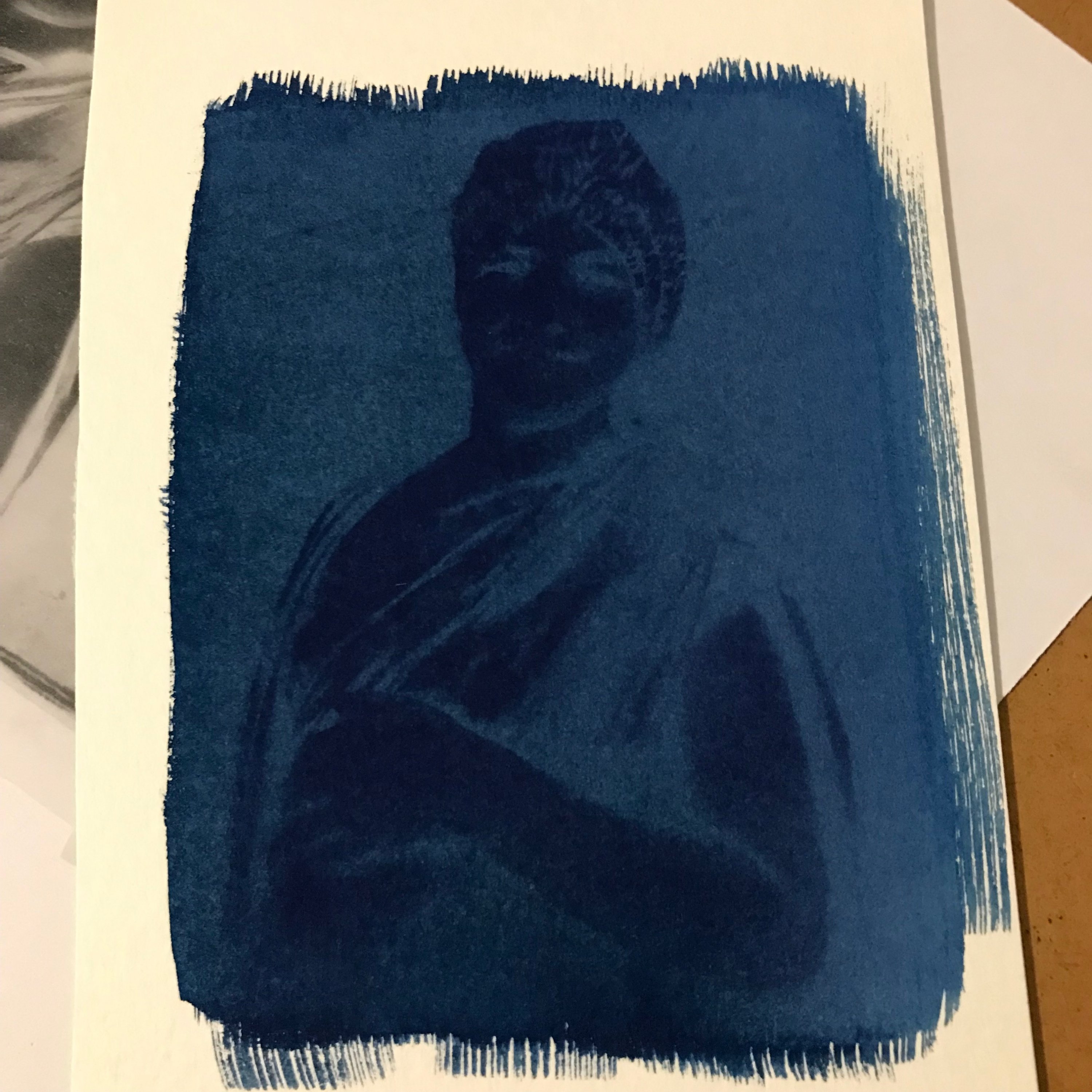

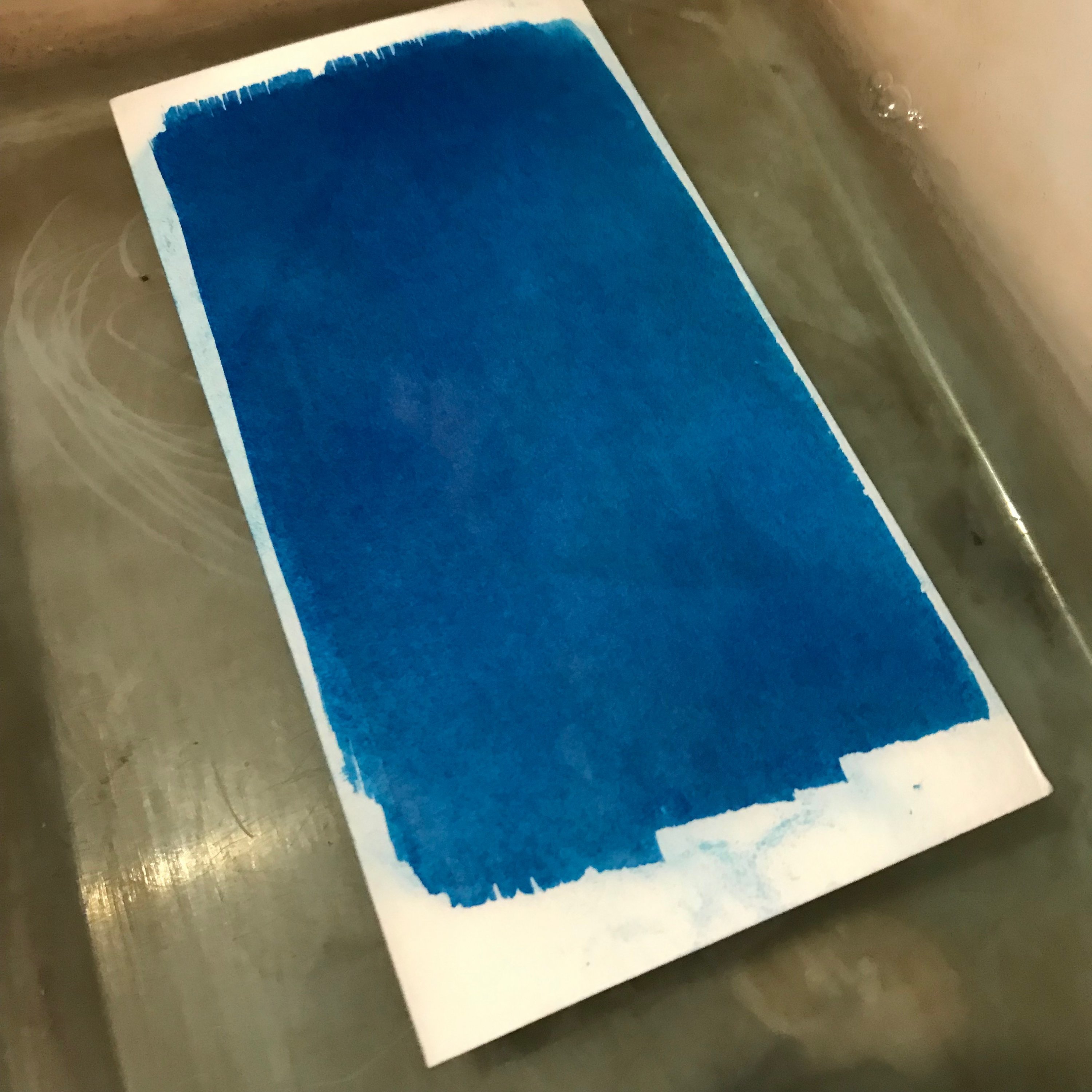

I tried this blue emulsion anyway, and: 1. printout image is negative (see picture), and washing out is near zero; 2. image slowly turns to positive, but so faint (no matter what the exposure time has been) it's barely visible (see picture).
Bottom line is, I made a strange emulsion, completely unsuitable for cyanotype printing. Please, any clue of what is happening?

I started by dissolving 10g ferricianate in 20 ml of hot destilled water; I kept the ready solution inside a thermal box.
Then, I dissolved the FAO (30g) in 30 ml of hot water (not an easy task). I had no means of measuring the temperatures, so I just used a pretty hot destilled water. I added ammonium dichromate (20%, 0.5ml), mixed 1 to 2 (with stirring).
That moment, the blue color appeared immediately, and letting it sit in a dark place for 1 1/2 hour to cool down and cristalize did not change anything.
