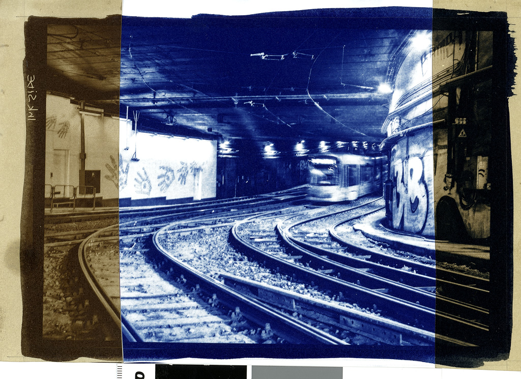

The print I linked to shows the paper as untouched by staining which isn't the case when I tone with tea, coffee, tannic acid or tannin for red wine from chestnuts.
I think scanning in greyscale and claiming that is the result from toning would really be disgusting.

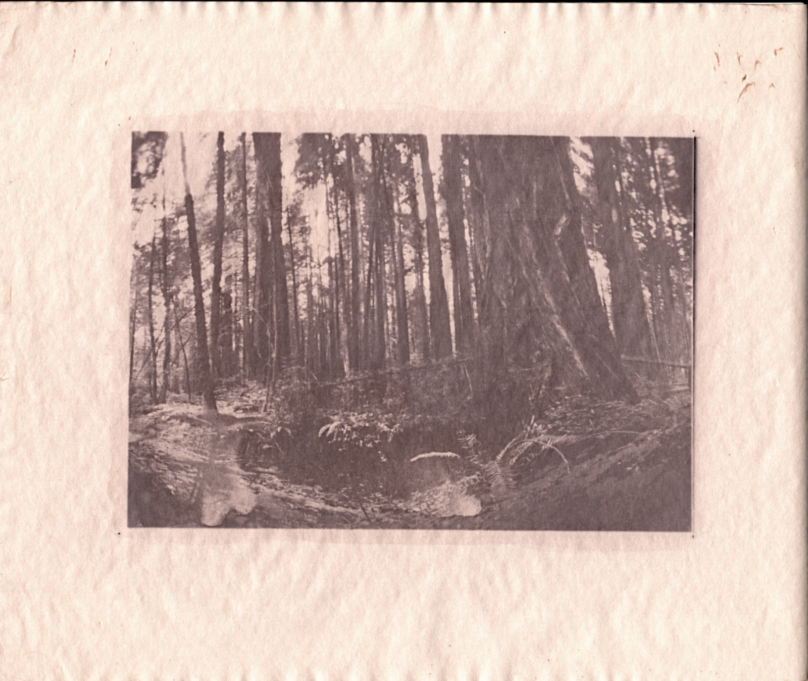

Sorry to report, so far it looks like you will be disappointed. So far the results seem to be similar to tea-toning.
But my test was not fair and needs to be done again, I've coated another sheet this morning and will try again.
Notes:
I left it in the toner for about an hour, and the tone did increase a little, but not very much after the first 12 minutes, and the paper did stain a lot more after that.
I've noticed green tea does not have very much capacity and this behaved similarly... so this was an unfair test of nusol.
It's possible it will work much better, with less staining, if I use a stronger solution and don't let it sit in the toner for so long.
For today's test I'll overprint a little more and then use the nusol full strength. And I'll extend the washing before bleaching.
The print did not change much during dry-down, but it's very interesting that the stain around the border, where there was cyanotype coating under the rubylith mask, became visible during drying. I thought I washed it long enough before toning, it appeared perfectly white, but obviously there was something around the border left to tone. I'll extend the wash on today's test.
The color looks very similar to toning in green tea, a kind of pinkish or purplish gray... my scan below shows too much brown. The fact that the color is so similar makes me think that is the color of this kind of ferric tannate and it's not likely to become more neutral, but we'll see!
Notes about the scan:
  • I'm not very good at getting colors right on a scan. It's less brown and more gray, but not neutral at all.
  • The contrast in the print is worse than the scan suggests... the blue print had nice "pop" and contrast, it looked really nice. The foreground was not muddy, I was impressed! The toned print is flat and weak looking. I decreased the contrast of the digital image to try to match the print, but the print really looks much worse than this scan.
  • The scan exaggerates the paper stain... it's not as bad as it looks and is actually a nice warm color. But it's not paper white at all!

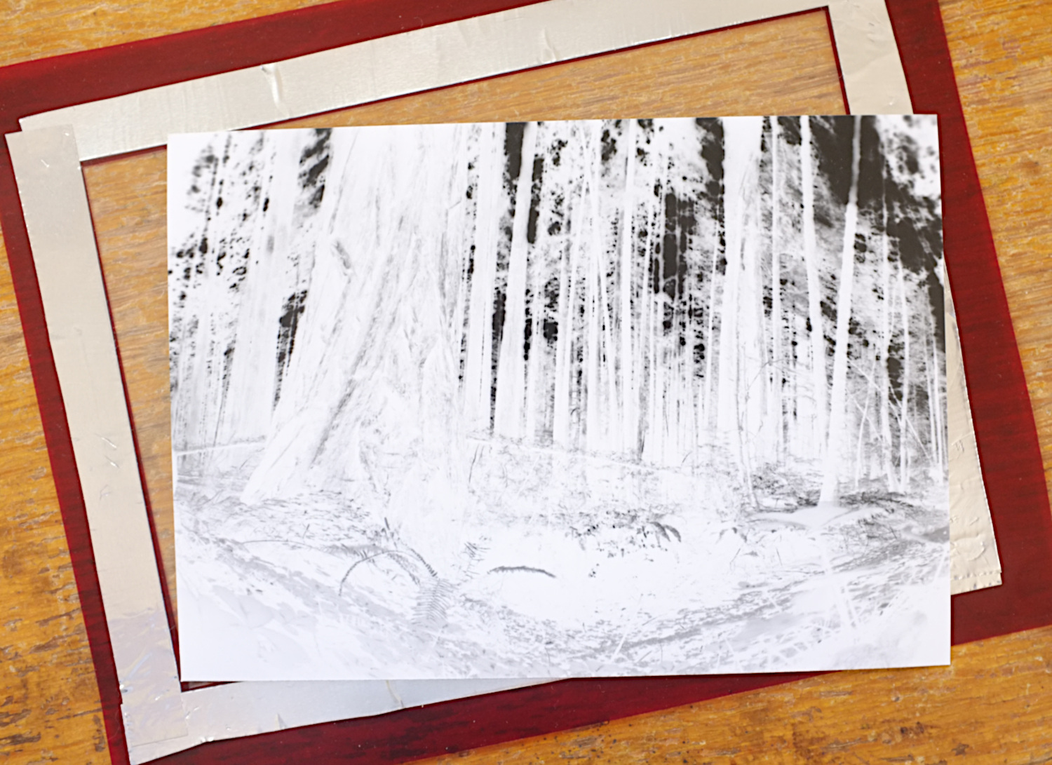

pinhole paper negative and rubylith mask:

One last note, not related to cyanotypes. When I used nusol to develop paper negatives a few years ago, the stain was much more extreme... a sort of orange-yellow tan color in all the places the negative should have been white. It did not stain the paper used here ( canson marker ) anywhere near as much. I think this probably means that either the nusol stains gelatin, or that it reacts with unexposed silver bromide. If it stains gelatin, then gelatin-sized paper might stain a lot more than what I'm showing here.

I never expect to get a black from cyanotype, it might be dark and deep but I don't expect it to be a black of a carbon print. I am quite curious what is in that magic developer soup. Lack of paper stain is heartening.
Hi Ned,
That is my experience too when toning cyanotypes. Masked edges become apparent after toning. Longer washes or acidic washes didn't changed that. I don't exactly know what it is, may be residual iron is left which would be quite a big problem. May be it is an intermediate form like prussian white, it is definitely hydrolysed in alkaline condition and then it is toned to produce some iron-tannin salt (Dr. Mike Ware would be the one to know it. ).

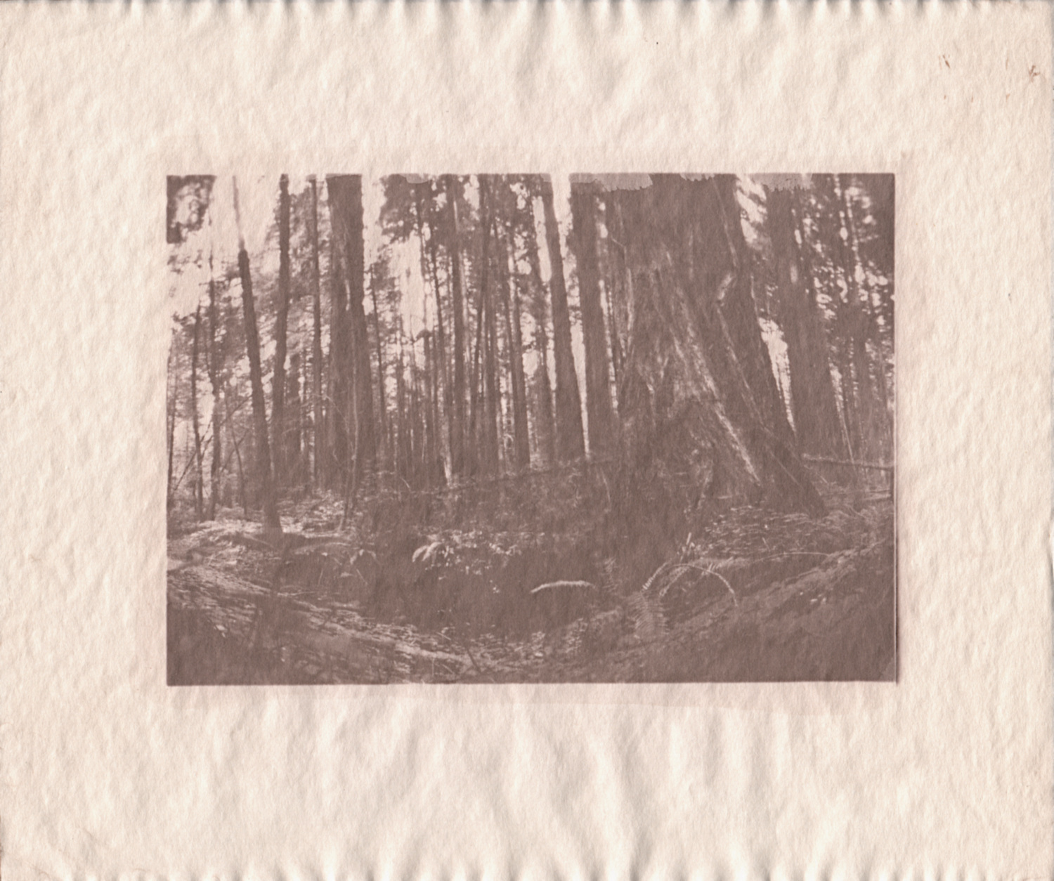

I put white, black and neutral grey cards into the scanner, used them with the "droppers", then removed them and made the scan. On my laptop this looks pretty close to the right color.
I knew there were coating defects at the bottom but went ahead with it since it is just a test.
I washed this for a long time before bleaching it... about 45 minutes in many changes of water w/ a little CA.
I think Serdar is right that the stain might be unavoidable... probably best to coat the whole visible margin, so at least it will all be the same stained color!

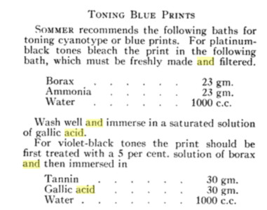

Here's a different idea:
From "The Photographic Journal of America, Vol 52" 1915, page 544:

Ned so what I see is that the image has more punch & alongside paper discolouration increase too.
The result is still not very black or at least not neutral. This then might not be the right direction sadly.
Interesting that gallic acid is used in the 1915 PJA. Maybe Gallnut tannin could also be an option for toning.
