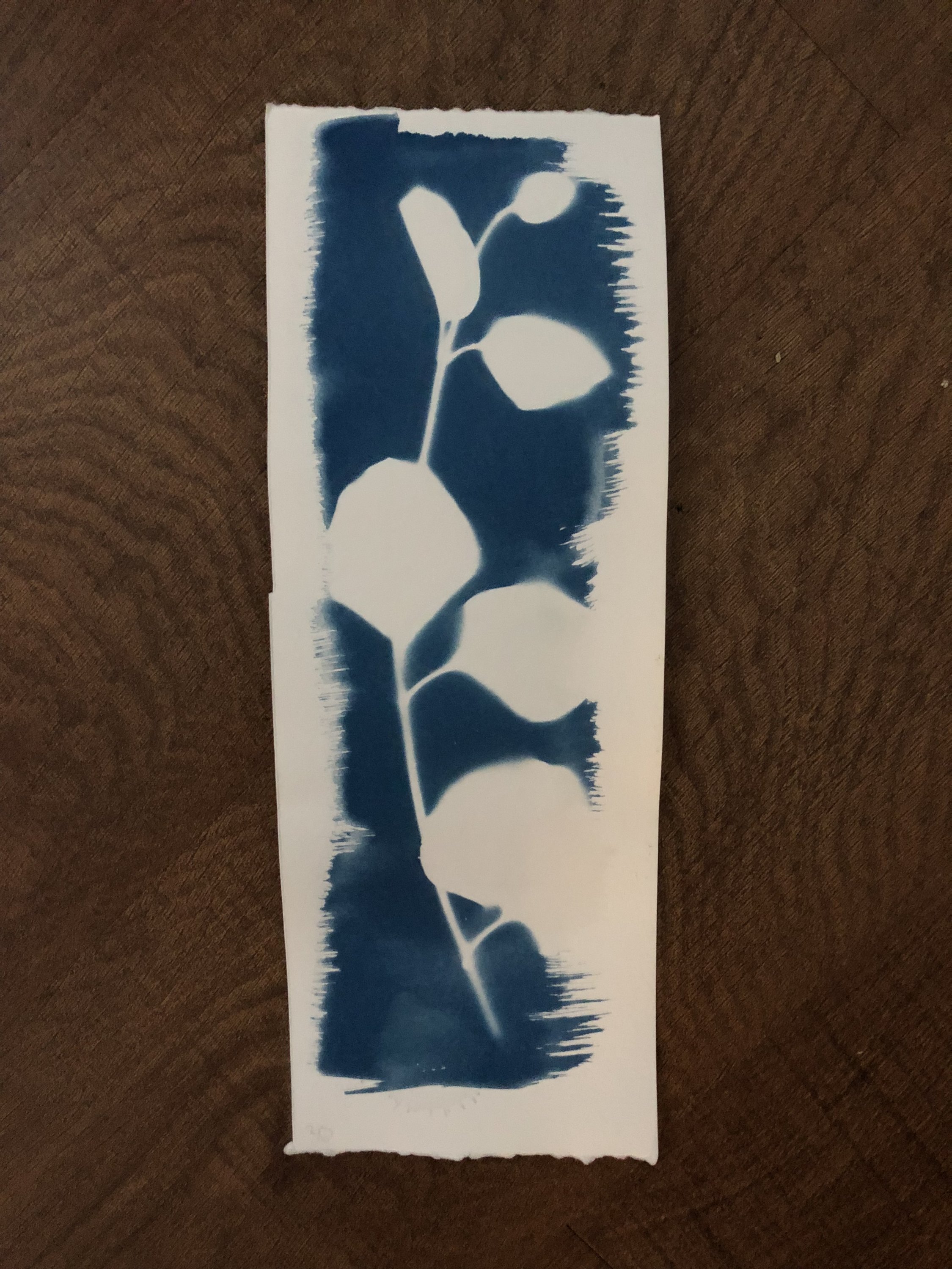

Hi all,
This is my second time trying photogram cyanotypes using foliage and flowers. The first time I was exposing in bright sunlight. I liked the prints and got some cool midtones on some, so I wanted to play with exposing on a more overcast day so I could do longer exposures and achieve more midtones.
Yesterday I tried some test exposures and got a print with some nice midtones. It was a 30 minute exposure and the foliage I was using must have had enough transparency to get some of those midtone values, which I saw after I was done rinsing.
I dried the print on a drying rack in a cellar with very little sunlight getting in (if that matters). When I went back later to look at the dry print, all of those midtones had disappeared.
Any ideas why some of the tones seen after rinsing would disappear after drying?
I tried a second batch of prints after that test. There was less light - there was more cloud cover and it was later in the day, so no direct sun. Once I rinsed those prints, all of the blue washed off and the paper is light gray with very faint images of what I was printing. I was wondering if there just wasn't enough UV to properly expose the paper, or if I rinsed too vigorously, or both. Those prints also faded more after drying. When I was printing that second batch, they looked exposed (visible emulsion was darker greenish-blue, underneath the foliage was still yellow.
Is there a possibility that something is preventing the blue from adhering to the paper?
Or I'm wondering if I either needed a MUCH longer exposure, or if cyanotype just doesn't respond to super long exposures (over 45 minutes)?
Images below of the disappearing midtones.

My first impression is that the coated paper was not sufficiemtly dry before the exposure was made. I have seen that color (purple) in my print highlights before with too-wet paper and have seen those values disappear upon developing.
Vaughn
Dec 13, 2006
10,255
Humboldt Co.
And it might be due to the moisture in the plant material. For that, try placing a very thin sheet of mylar as a vapor barrier between your coated paper and the plant material.
Also, try open shade on a northside of a wall or building, with the contact-printing frame towards the sky. Lots of UV to expose the cyanotye without over-heating the glass of the contact-printing frame (over-heating brings the moisture out of the plant material). Some like to kick-start the exposure in the sun and transfer to shade before it warms up too much.
Edited to add: Another thought -- the prints that had mid-tone values that disappeared while drying (not previously in the wash). The chemicals probably did not disappear/leave the paper -- I wonder if any image would return by using one of the many toning methods.

For the OP. I've noticed cyanotype chemicals losing some of their range after they get old. I recently had an issue with my cyanotypes losing their highlights. My chemicals are about a year old as well, and they've been stored in a cool, dark place. They still work, but I'm finding I have to adjust the exposure times and paper treatments to get the similar results as I used to, with much less effort. You might also try using some vinegar in your clearing bath. That's supposed to up the contrast, which might help you in your case. Also, since you're using the sun, exposure times are always unpredictable. You might try longer exposures. And like Vaughn suggested, you likely have some moisture problems as well.

Do you make a photogram https://en.wikipedia.org/wiki/Photogram
If yes and you use plants as object, than in my experience it´s normal that "the midtones" are disapperaing. see the cyanotypes of Anna Atkins for example.
Or I am wrong?
For midtones you need a digital negative and not an object which blocks the UV.

That violet colour you are getting in the midtones reminds me of the colour they go initially when you use washing soda to bleach prior to toning. Could you have alkaline water that is continuing to bleach the image slightly as it dries? If so acidifying the clearing bath could help.
J 3
Feb 1, 2016
147
P.S. Exposure matters though of course. In order to get midtones the area below the leaf has to be in the exact right exposure range and that is dependent on how much UV gets through the leaf. Even the mildest of overcasts can change the relative balance of visible vs UV light making it hard to meter for cyanotype.

I'm not an expert in cyanotypes but I have made quite a few using the traditional formula. I mix up the solutions from the dry chemicals and use them within a few days. I tried various papers, some more successful than others. I tend to coat the paper quite thickly and then hang the paper to dry in the darkroom overnight. I wonder whether a little tween would help (it helped me get the coating to soak in better). I also wonder whether your midtones are just a bit too underexposed so that they wash off. There is always some detail that is lost in the wash. Do be gentle when you wash.
