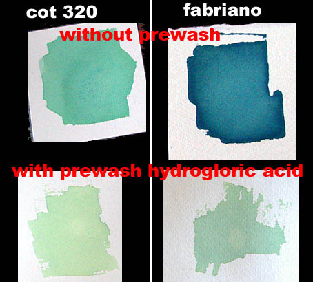

photos where taken after 24 hours of drying (dark).
Lukas Werth
Oct 26, 2005
285
Pakistan
Thank you, this is instructive!
Well, the Bergger paper seems to be better than the Fabriano without prewash.
However, 24 hours before exposure seem far too long in any case. Even the prewashed ones would not be fit anymore for exposure. When you expose the paper, the colour of the sensitizer should be yellow. A very light greenish tinge *in the yellow* may be aceptable - may happen with a sensitizer with much citric acid added for very low contrast, or when the gods of the blues are not with you - but no more.

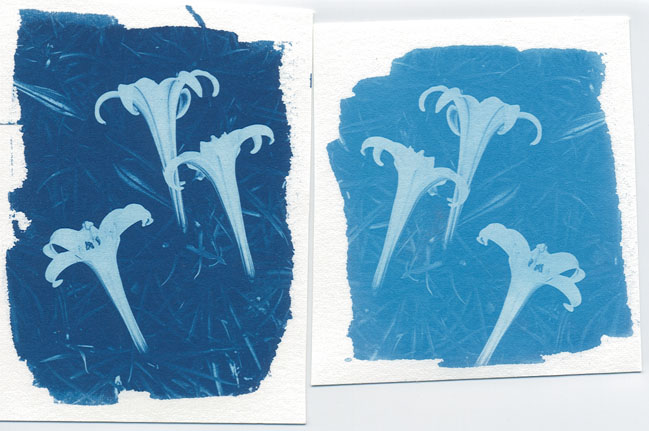

Lukas,
i did a test where two test strips were lighted the same time for the same negative.
First one was washed in a vinegar solution and the second in hydrogloric.
the hydrogloric one turned full blue, the vinegar one showed light blue.
I will post the result here end of the day.
Willie Jan
Willie Jan
Jun 11, 2004
950
Best/The Netherlands
here is the test.
the darker image is after the lightning processed with hydrogloric acid. the other one with water & vinegar.
Both papers were lighted at the same time and for the same duration.
I left them for +/- 48 hours before i scanned them.
Willie Jan.
Lukas Werth
Oct 26, 2005
285
Pakistan
Yes, the difference is obvious. Willie Jan, have you used a 1% solution of hydrochloric?
This test strip result shows the virtue of mineral acid for New Cyanotypes. Bear in mind that Mike Ware in these days recommends nitric acid, though I don't think this makes a difference to hcl for the final result.
Let me ask a few more questions, just to make sure:
Have you used a contrast agent (am di) in your test strip, or citric acid to lower contrast?
Was the dried sensitizer yellow on the paper when you exposed it?
Did you expect these flowers to be white/would they be near-white in a normal bromide print, or are you happy with the light blue?
I ask because, to be perfectly honest, as far as I can see on my screen, the test strip still looks a bit veiled, and the blues in the shadows could be darker. But to state anything further here, it is necessary to know the artist's intentions/the whole picture/about the quality of the negative.
