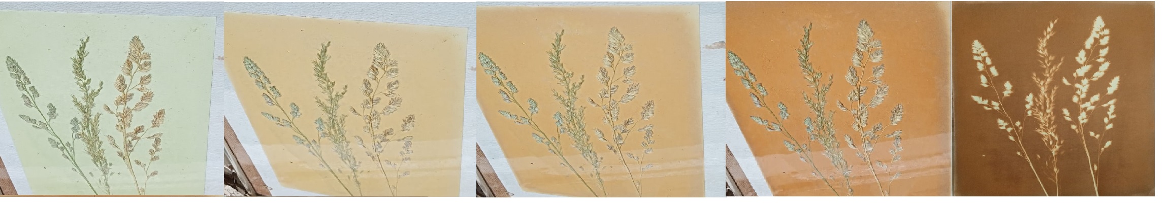

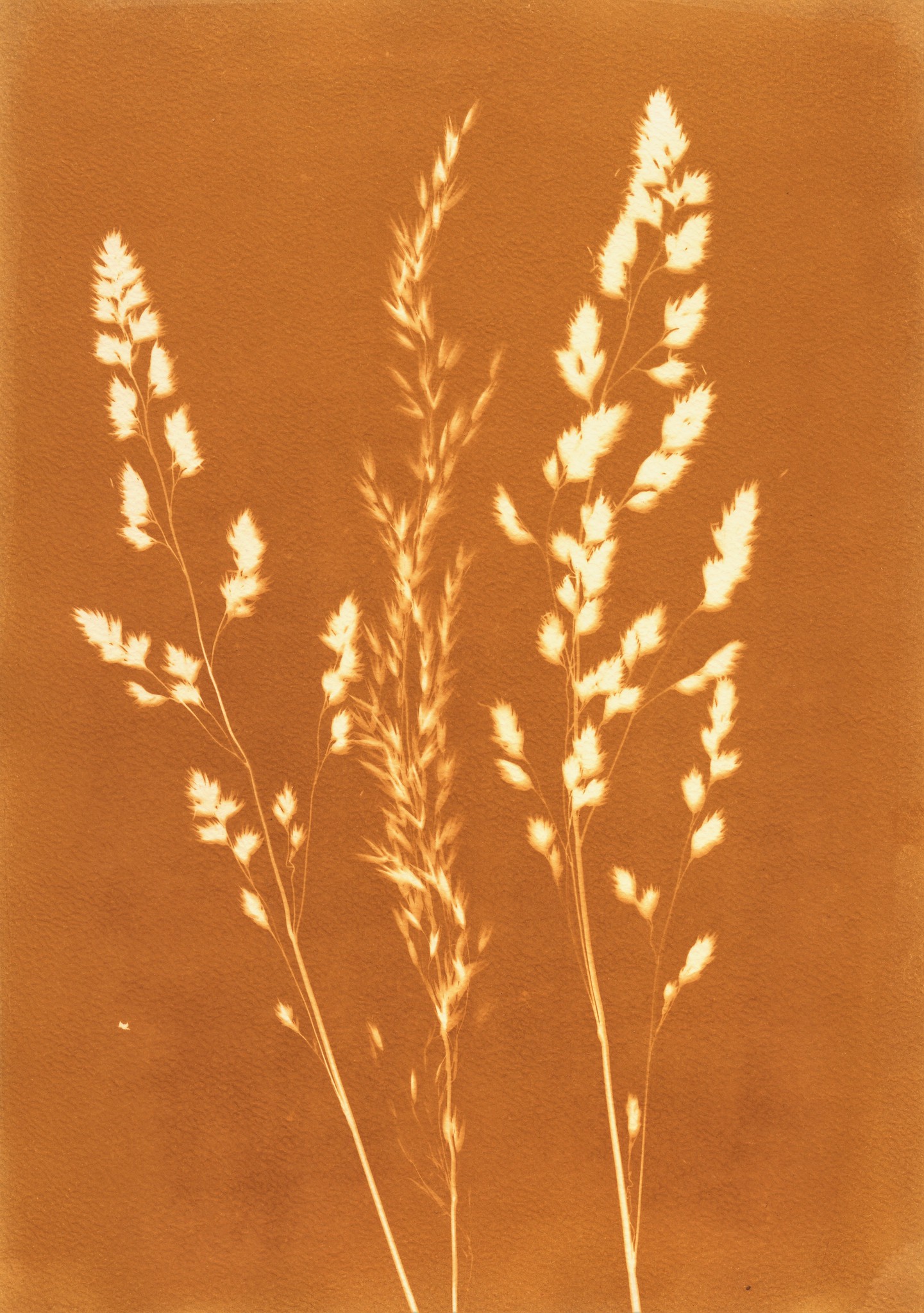

Finally tried following:
- a few ml of used fixer
- add some Copper Sulfate (not much)
- wait till it has reacted (it will become brown or dark)
- add same volume of 25gr/100ml concentration Ferric ammonium citrate (same as used for Cyanotype.
Paint on paper or linen
- let dry for short time
Expose in UV or Sun (about same time as normal cyanotype.
- The paper will have before exposing almost white / light green color
- after 3 minutes it will turn yellow
- after 10-50 minutes it will become coffee with milk color.
Contrast seems to have more gradations (see the middle grass halm)
Development:
- I rinsed it in water with a drop of vinegar (pH of my water is 8 so i have to bring it down slightly)
- Dry.
^any tips or suggestions for further experiments welcome.

It could be my eyes, but the final developed image seems to lack the fine details that are in the intermediate images. Is this what you also find in the prints?
Typical for Van Dyke Brown is the pretty drastic changes the print goes through upon processing, and the rather steep S-curve. Testing with a proper negative would be the first step ahead.

Indeed very interesting and yes it was my very first post. I have been reading and getting information though for many years already from Apug and Photrio.
I have been trying on and off to get some use out of the used fixer which is by the way normal Ilford Rapid fix in 1 to 4 dilution and was used for many bw films to clear.
I was not able to get direct results but very faint image after long exposure in the sun. The idea for the copper sulfate was because it sounded like a good combination. After the try I found some article about thio complex and copper sulfate also.
article thio and copper sulfate
Thank you already for all the comments, let me try to answer the questions and good stuff for some further experiments.
- the used fixer = IlFord Rapid fixer in dilution for film 1:4 and used for many films
- the copper sulfate is the normal blue crystaline CuSO4.5H2O
- after mixing in the Ferric ammonium citrate the color is dark green
- after painting this on paper it is light green and does not darken later if kept in dark
- the paper with emulsion seems to loose its sensitivity after some days, only slight darkening then is seen while exposing in full sun
- the rinsed prints do not seem to change (yet after 1 week) I have not tried to put one of them in full bright light yet neither.
- i have "developed" on of the sample in diluted Potassium ferricyanide - which makes it a mix between the brown and blue, with some pink (see below the picture with the feathers)
- regarding sharpness, I think it is very sharp, see the middle grass in detail, it shows nice tonal range and lots of detail.
- indeed it took many tries to get something that is of any use...
My goal was to have a photographic use of using the used fixer for the silver, but yes i should try if taking unused fixer has the same result, same for leaving out the copper sulfate.
About the Cuprotype, if have tried copper sulfate + Ferric ammonium citrate but this did not really do much, perhaps at most a faint picture. I did not pursue that but will have a look at that again now that i have read-up on it a bit.
below some links to the results sofar which I like.
Thanks again for all the comments and suggestions!

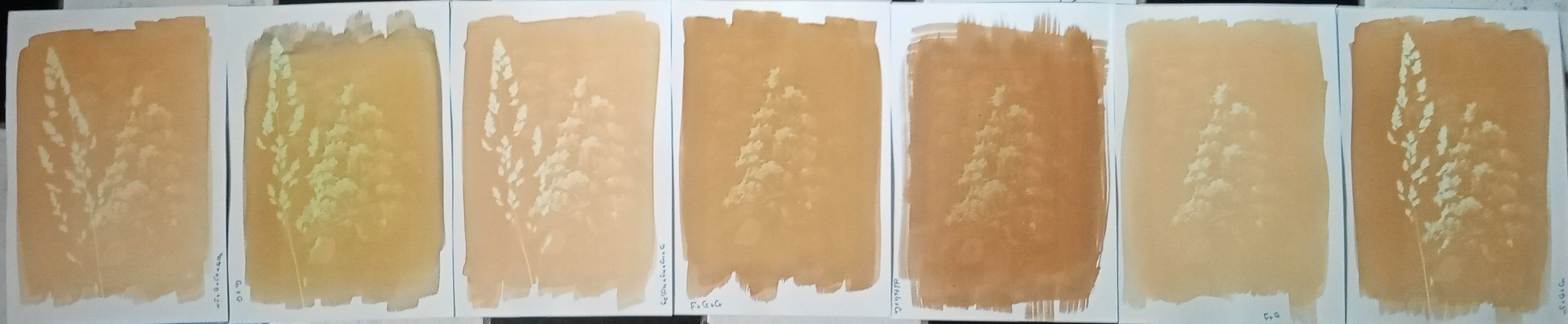

Some result with different combinations after 30 minute UV lamp exposure and the image below after wash in water with drop of vinegar while drying in the sun. This drying in the sun should show if further fading or coloring takes place. (which was not the case)
note the order of the pictures is not the same. Once dry and darkened (if) i will add full description. top row nr 4 and 5 contain the used Fixer corresponding bottom row 2 and 1.
Since for the test I first was using an inkjet negative but found density not enough on the later tests i added a straw which is having more density.

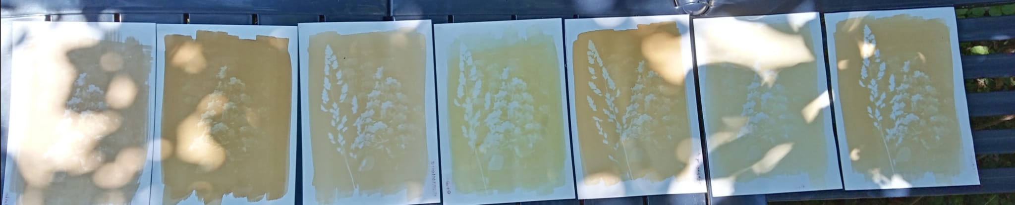

My conclusion for now, the Rapid fixer used or new does work with all combination. It stays on the paper after washing.
After washing the colors do not darken or fade in the sun. (about 2 hours exposure during drying)
When the used fixer used with copper sulfate it does seem to leave darker image and retaining more details after washing.
From what i have read in the past there is only 1-4 grams of Silver in 1 Liter of used fixer so that would magnitude lower than the normal vanDyke recipe in any case.
So what is forming the brown color on the paper?
- washing with water seems to make it somehow lightproof (short term at least)
- washing with diluted Potassium ferricyanide as first wash - gives blue Cyano color but with pink/copper colored highlights
- washing first with water, then leaving it in Potassium ferricyanide, changes the whole print to pink/copper colored print - this can still be toned darker with green tea.
The prints containing some silver seems to be sharper (detail scans to follow)
So overall i think some Iron Sulfur and perhaps Copper and traces of Silver on the paper. What is good that it stay and does not rinse off. (Specially those containing the used Fixer)
thank you all for your contributions. Some end point for me would be to have some stable brown print and it seems the used photo fixer can help with that. Would be nice to have some not toxic way to darken the overall print.
