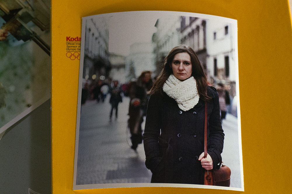

Today I Printed a frame from a roll of kodak portra 400 exposed and processed at 1600. The frame was shot in the shade. I had to use 5C to get the colours right. The filter pack at the end was 40M 5C
Seems extreme but not impossible. The point is you dialed yellow down to zero and still had a blue cast. At which point, the only way to correct it would be to dial up cyan and magenta (=blue) in tandem.

This is the straight print, no dodge, no burning. Filter pack was 40M 5C.
