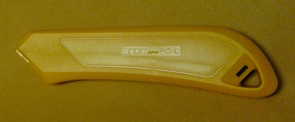

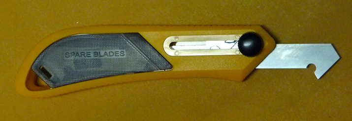

Gentlemen, thank you for your suggestions, most helpful. I have obtained the needed tool, and I was told this one is among the better models. Wish me luck and a steady hand.
