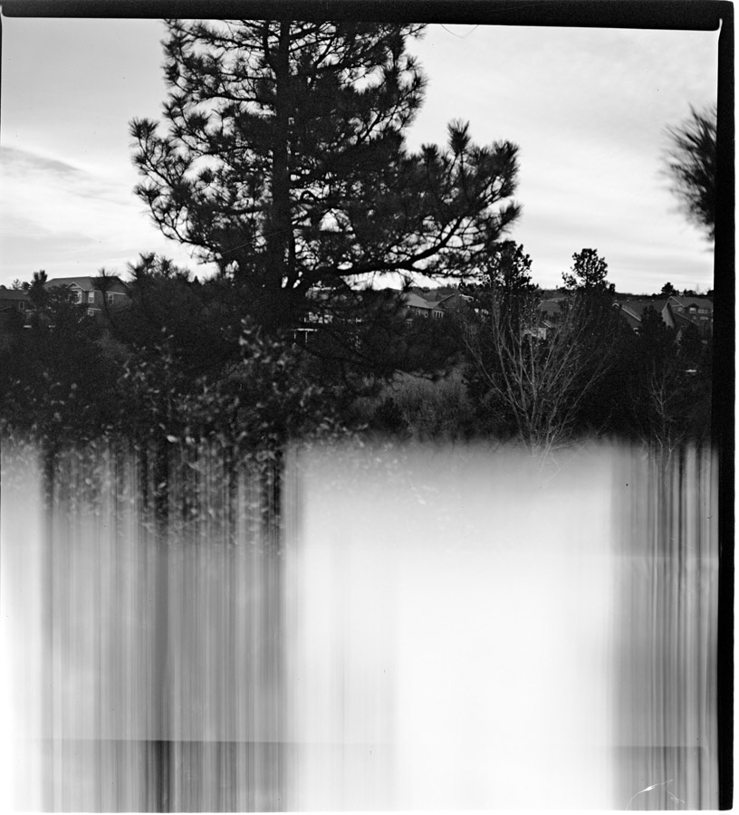

Here is an example I did with preflash at ISO 3:

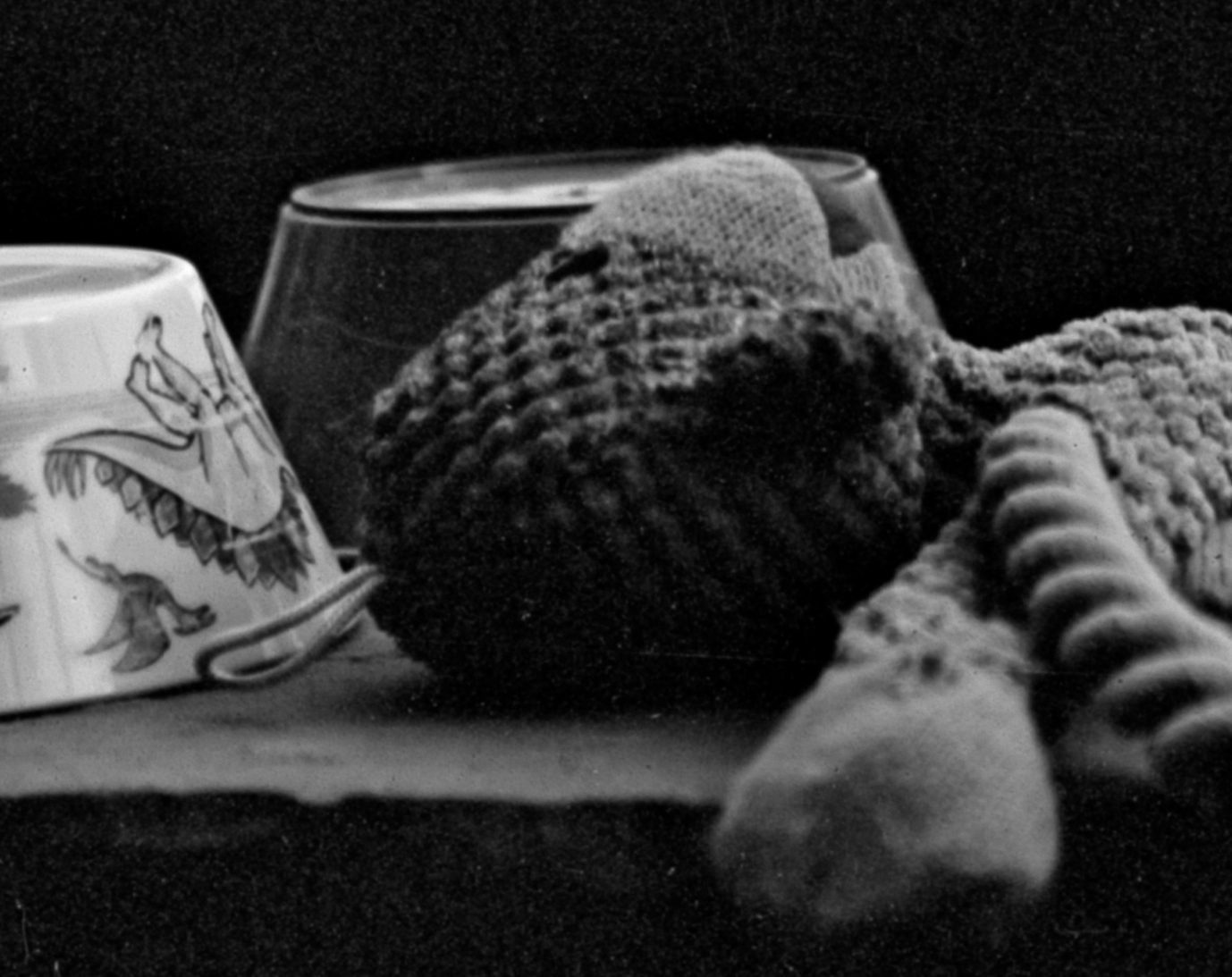

Also, received the film, no good way of cutting it yet, but did hack together something that works good enough for testing. Here's some of the cool results (shutter stuck on my Mat 124G resulting in the blurred images
Shot at 3 ISO, developed in Pyro PMK 1+1+100, 5 minutes total, 15s initial agitation, 4x agitation every 2 minutes after. I love the somewhat ghostly look of this stuff with it's weird response to color and contrast, and the grain is easily fine enough for some great pictures at 120... not sure I'd like it at 35mm though. I want to try this stuff in Rodinal at some point, as I think the grain looks pretty attractive. Similar in structure to FP4+ or other slower speed classic films. I think this would actually look better at 1.5 ISO, but that pretty much eliminates any ability to go handheld outside of the very brightest of days.
Also, here is a 100% crop (from 6300x6300px) to show how nice the grain and edges on this is:

I cut my first successful batch of 7 rolls last night (only wasted 13 rolls worth of film figuring it out!) and was careful with gloves, clean surface, no airflow etc so I'm hoping that these have at least minimal dust, and no image compromising scratches. The back of this film is very fragile, scratched even by felt, but luckily in testing I found these minor scratches, despite being visible when inspecting the back of the negative, do not affect scanning or printing
