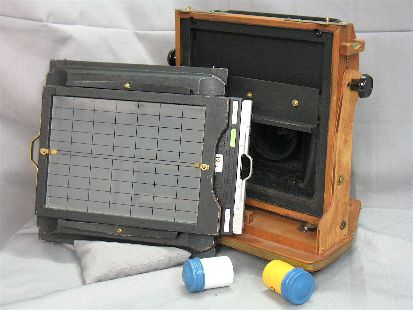

This fellow designed a camera having a septum to split a 5x7 sheet into two 2.5x7" images on one Reversible 5x7 sheet film holder...
Why not adapt the idea with a removable insert for your 8x10?
https://www.photrio.com/forum/threads/two-617-negs-on-a-5x7-camera-built-june-’93.155715/
