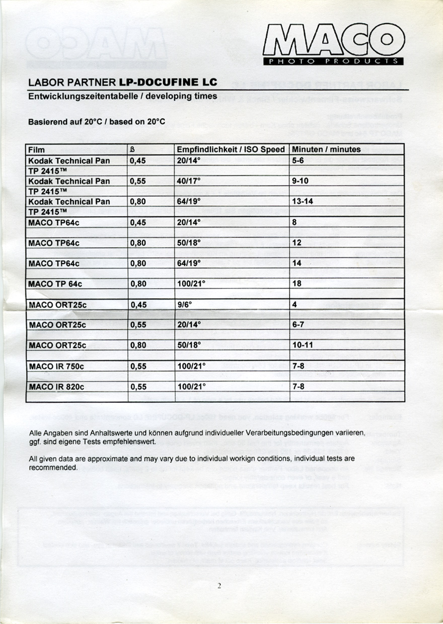

Ideally would like a technidol substitute for 0.5 to 0.6 contrast index times/etc. ISO 16-32.
Must either be something off the shelf from the follow:
Current Kodak (excluding HC-110) or Ilford developers, Rodinal, Adotech II, LP Docufine
Or something mixed up. Have phenidone, metol, hydroquinone, the usual.
Must give times, must have even development without issue (pre-soak no pre-soak?).
No test roll to run through, only a single roll.
edit: Just found the info sheet for the LP Docufine, which has times for Tech Pan at different ISOs and gives the gamma for each one, so this is probably the choice for now (iirc its the same developer as Rollei RLC?)

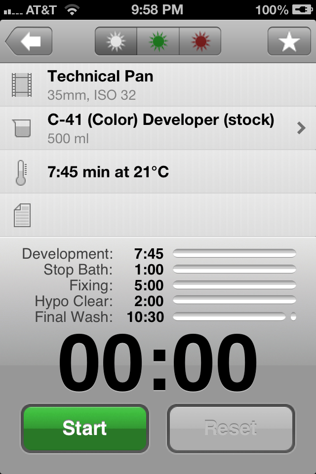

Dear Athril,
I use C-41 developer for 8-1/2 minutes in my Jobo (10 minutes using Kodak normal agitation technique). This was stolen from an old Photo Techniques Mastering Black-And-White Photography Vol 1 and it works wonderfully.
Neal Wydra

Guys, again. Only whats listed above, or formulas. Nothing else. Especially from an overseas store. Seriously, why do people have a hard time sticking to the outlined requirements?
Regardless, went with Docufine 1+4, 7 minutes, 20c. No idea what the shot speed was, had no information, was a found roll. Assumed ISO 25 was most likely. Though given the density, appears more like it was shot at ISO 12, but still otherwise useable.

Here's the docufine times with contrast index in case anyone was interested
Also attached locally for preservation

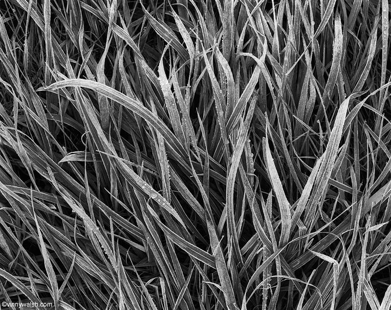

Here's how I've been doing it.
25asa (sheet film)
2 minutes presoak
68 degrees
rodinal 1:100 in jobo expert drum speed 3 for 5-6 minutes depending on the contrast range
I print with chromega heads on vc paper. The results blow my mind every time.
Untitled by vinnywalsh.com, on Flickr
