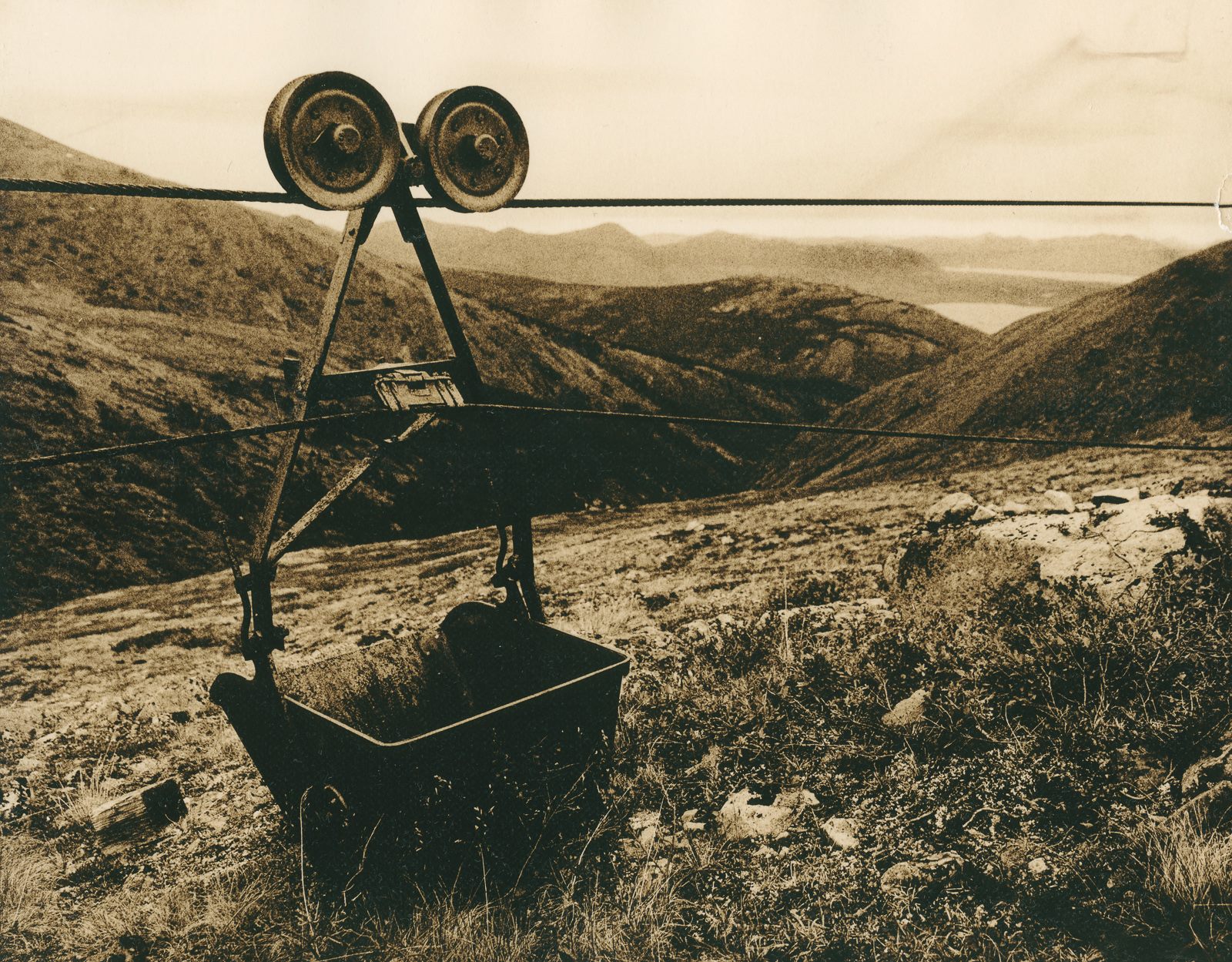

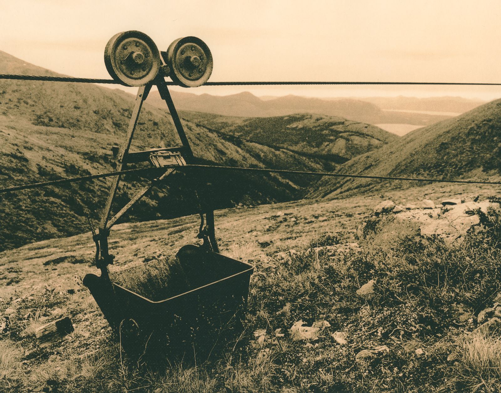

Hi Bob,
Fomatone papers are my choice for lith. I've tried the 131 (glossy) and 132 (matt) papers and also have a box of the 532 I haven't tried yet with is matt paper with a 'nature' base whatever that means. I use Moersch Easy Lith.
The natural color is yellow/peach which goes more neutral in selenium and then becomes progressively redder with longer toning. I've also bleached this paper to help brighten highlights and it works great. Haven't tried any sepia toners yet.
Sorry these aren't the best prints but I'm not at home right now to scan anything else.
Fomatone 131 overexposed 2 stops
Moersch Easy Lith 1:1:50 approx 6-7 mins
#1 is untoned
#2 is toned in Moersch Carbon Toner 1:20 for around 10 minutes -- I get similar results with selenium toner

Hi Bob,
#1 is untoned
View attachment 176652 View attachment 176653
