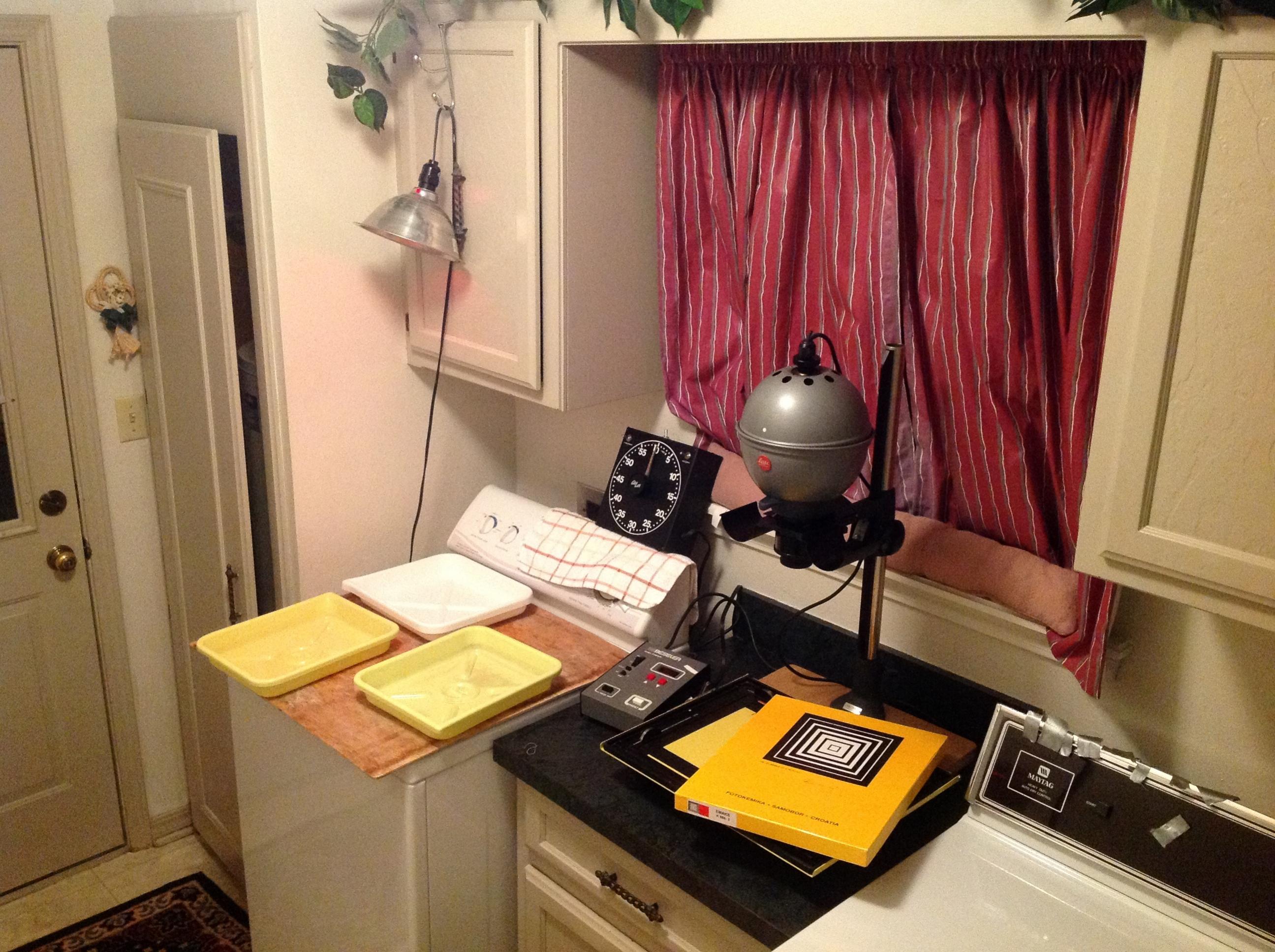

My DR lacks the space for two developing trays. I often run a two tray fix line or single tray process using 11x14 tray or larger. After I have a working print 1/2 grade tweaks can be accomplished using 130 vs LPD, pulling the print or deciding to tone or not to. If I had space, I would likely use LPD and 120.

I use a LPL 670 for MF. The enlarger is modular. I infrequently change heads on the column if needing to adjust contrast.
