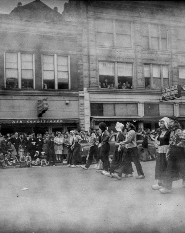

This roll of film was in a bunch of stuff I bought. It was Tri-X 35mm, shot who-knows-when. I developed it - but the problem was it was likely pushed and the negatives ended up very thin. If I'd developed it a few minutes longer, it would have been much better.
I also developed a film pack that was shot in the mid 50s. The images were on there fine but the emulsion suffered from exposure to the paper and age fog.
Great shot. Well worth having even if it looks like this. Reminds me of similar pix I have of myself back in the mid-70's.
Here's an example of Kodak Verichrome type 127 with the process-before date of November 1946. Developed in April 2022 in HC-110 dilution B at 7 degrees Celsius for 10 minutes. I did a strip test and aimed for lower density but the negatives are still pretty dense due to fog.
I would not recommend storing unprocessed film for more than 50 years.
lol, noted!
Great 'found' image. I assume you did not take it originally...
