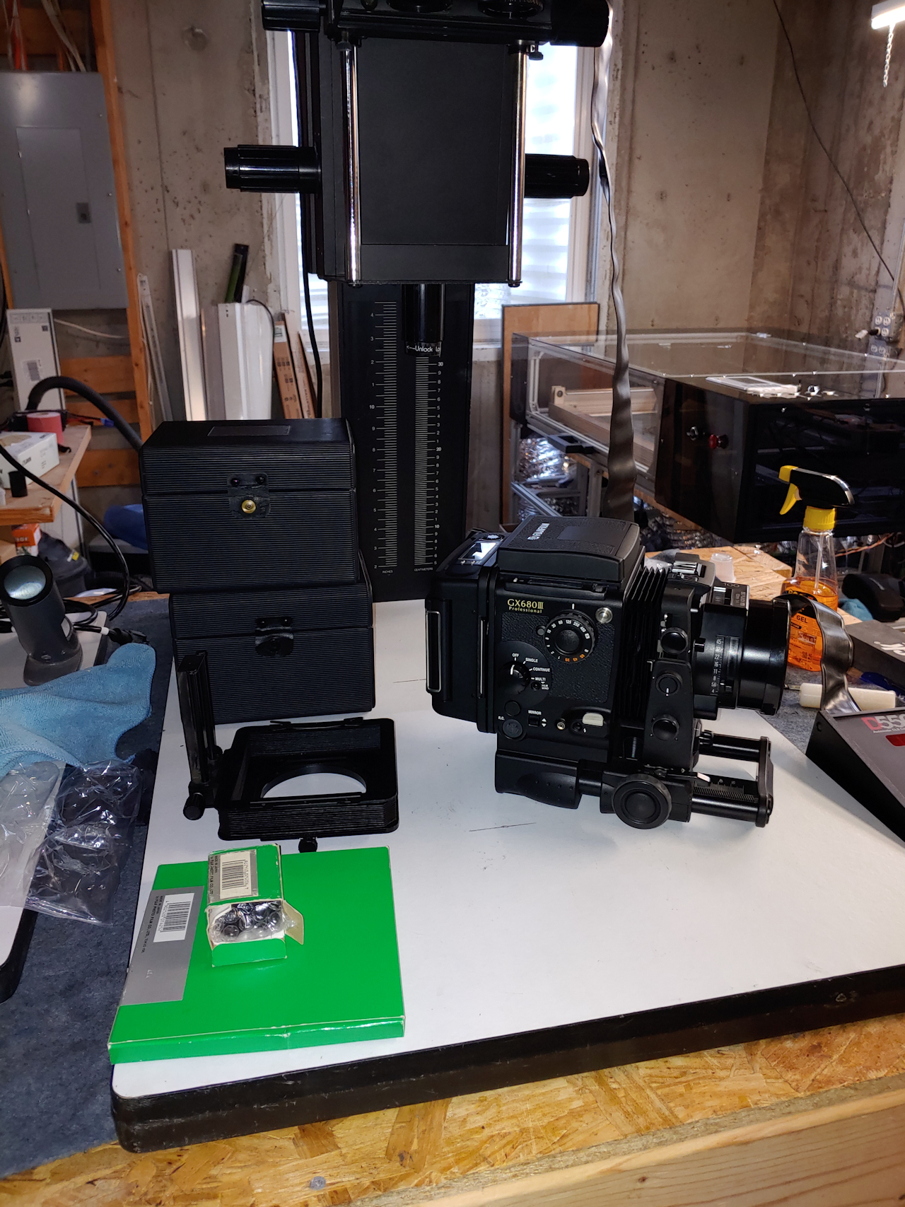

My camera showed up today, three days from Japan to Colorado. Camera is in fabulous condition. I just put a roll through it and about to process it.

Nice. And you got the boxes for your lenses.
I am of two minds about those boxes. They take up a lot of space in my dry box (I got quite the collection with mine), but they're REALLY well built items. Gives it a totally different feel than modern cameras where you just get a sock or the lens shipped in styrofoam and nothing to store it in.
