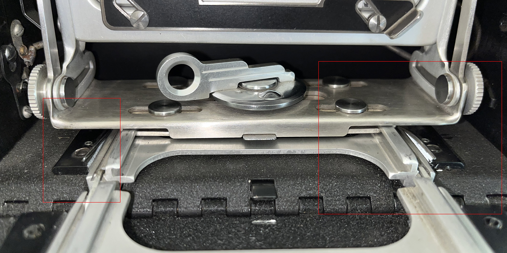

Something similar is happening to me on my Crown Graphic. I was trying to see if my rangefinder was accurate and for whatever reason had the bellows extended far and I dropped the bed, the rail linkages became stuck. And that's when I probably messed things up trying to get things back to normal.
In any event it looks like I toasted my rear rail yoke guides? It seems some of the metal has slivered off and is now just hanging.
I still seem to be able to use the camera if I'm careful not to extend the bellows too far - otherwise things get stuck and maybe are allowed to extend beyond where they once did? I'm not really sure. Other than keeping the rear inside rails held down, what else do these rear rail yoke guides do?
Thanks for any advice!
P.S. I found the following:
https://lommen9.home.xs4all.nl/broken rear guides/index.html
and think I can flip these guides but probably would like to get some new ones.
I wasn't able to remove the shutter actuator from the front standard - the thumb wheel doesn't seem to move very much at all in either direction maybe only 1 to 2 mm in either direction before it's tight again - the site above mentions perhaps a retaining ring rivet type thing but I don't see it. I don't think it's necessary to remove this from the front standard though to get at the the yoke guides, I didn't need to anyway. The bellows removal from inside the back isn't something I want to do so much again - so maybe I'll just replace these instead of reversing them. One thing the site mentioned about removing the bellows that I didn't see was 2 retaining clips. I only saw the 8 corner folded metal tabs.
