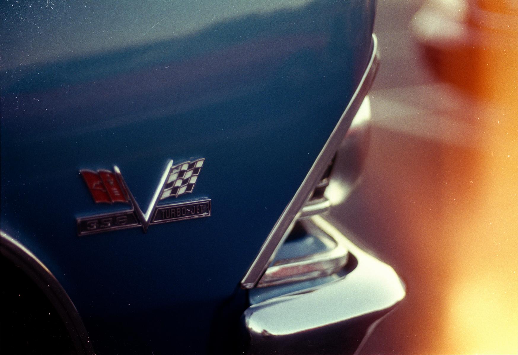

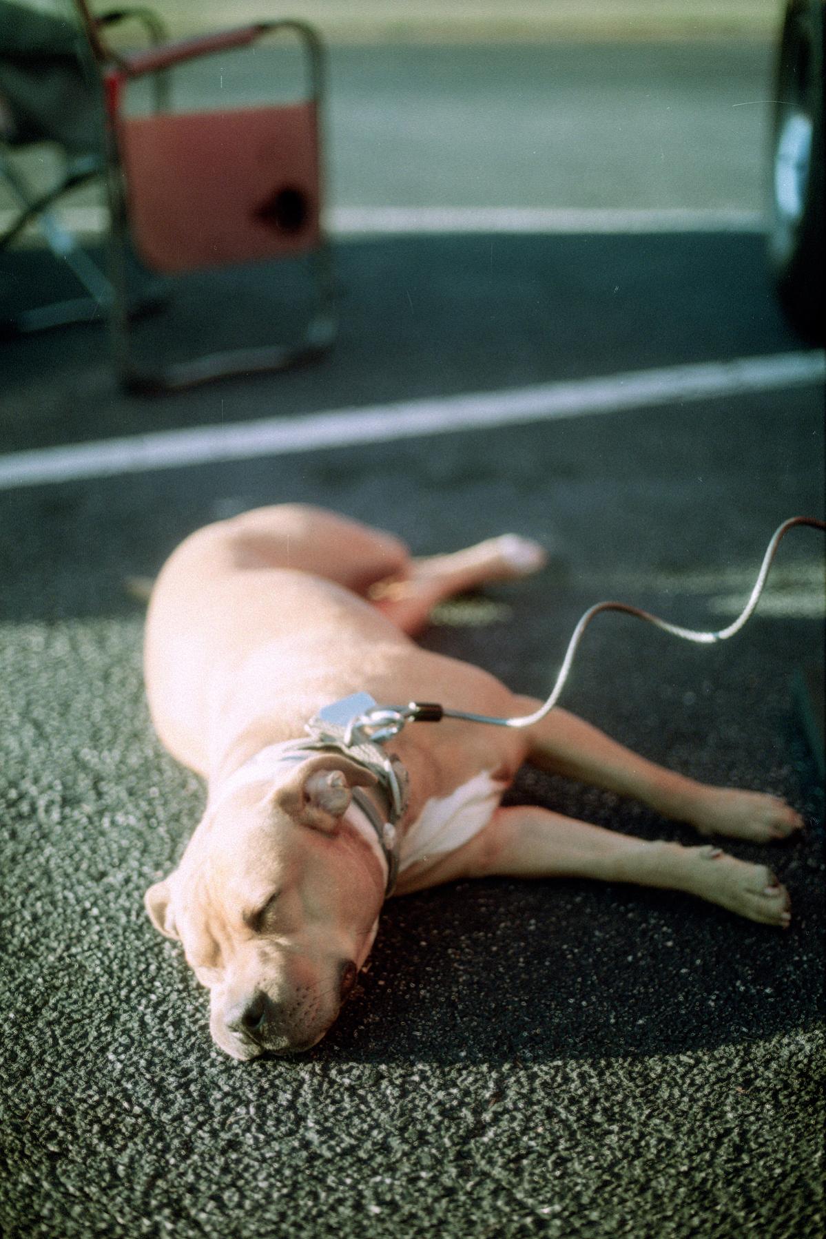

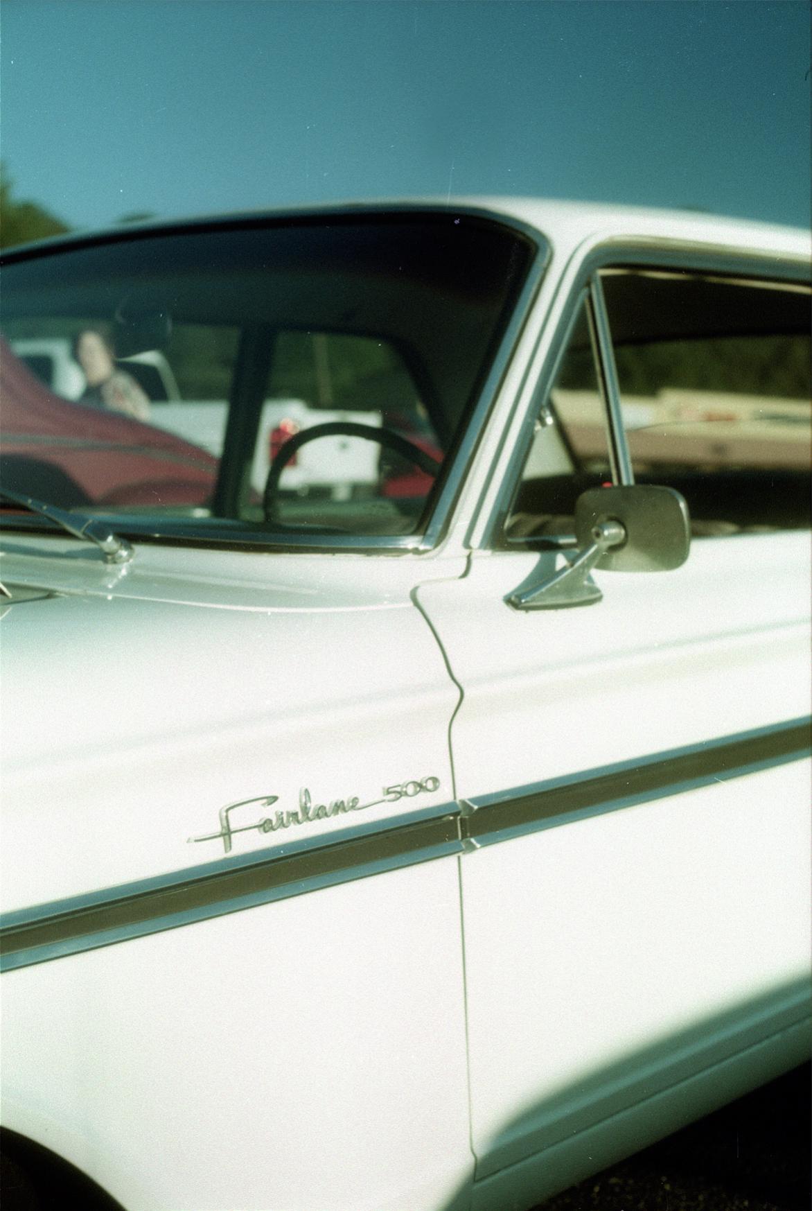

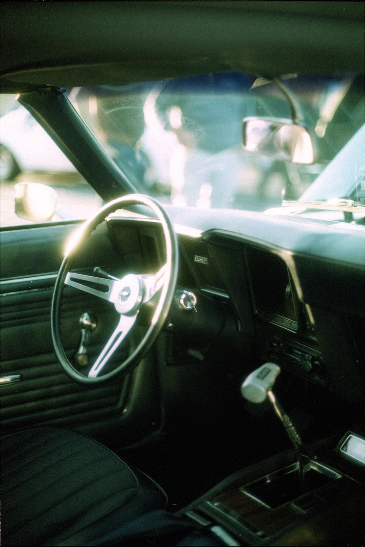

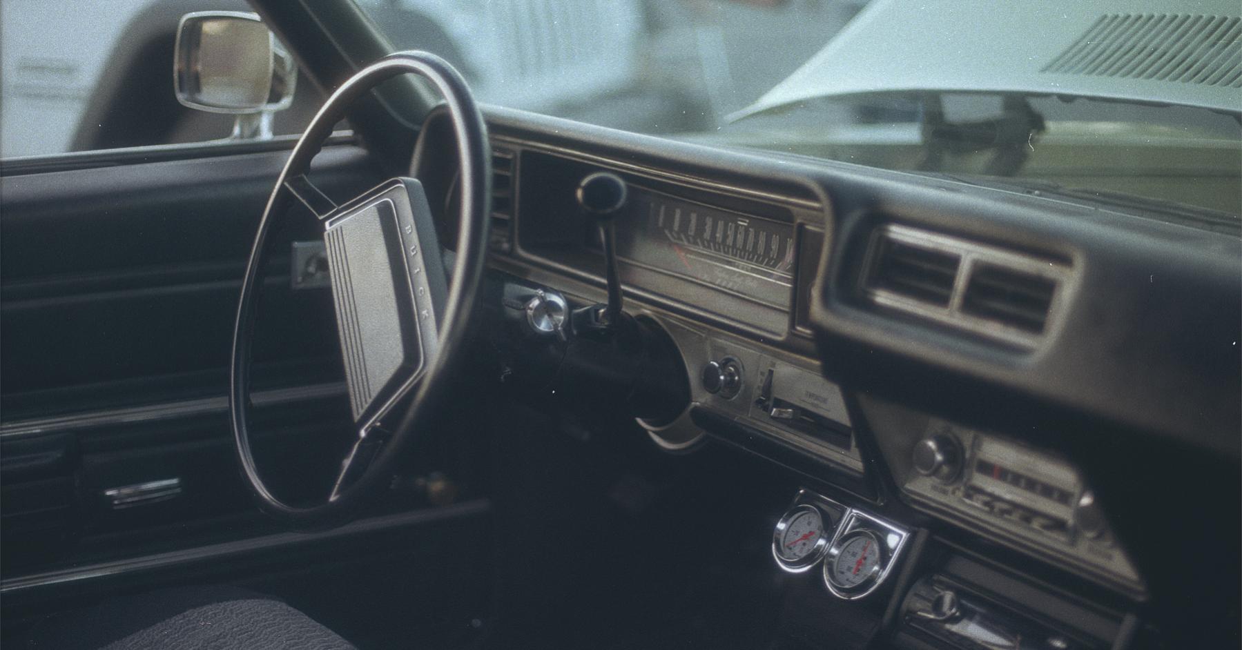

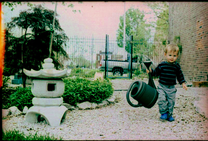

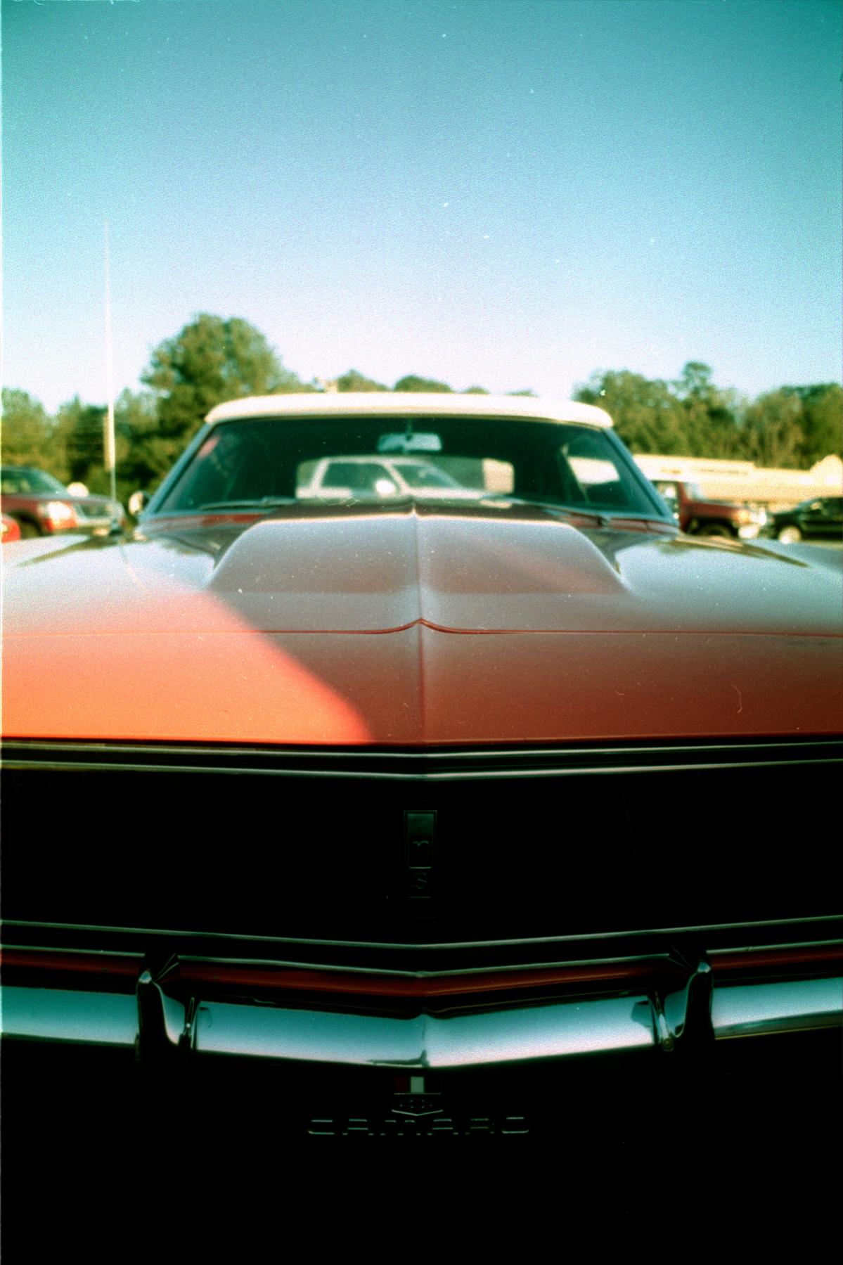

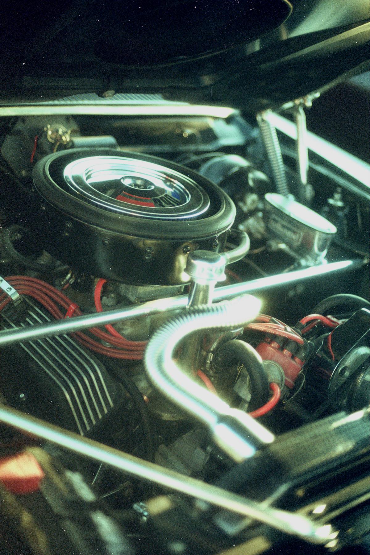

My first foray into shooting slide film rendered interesting results. I couldn't find any local e6 shops so I settled for cross processing the roll of (expired) elite
chrome I shot at my local photo shop.
Now am I crazy or do these look like they aren't x-processed? I was expecting the typical heavy green/blue cast, but these have relatively natural colors. I used
vuescan to get the images but scanned them as print film (not slides). I didn't do any correction to the colors.
My question is, is e6 film really that unpredictable? What are the factors that contribute to the look of x-pro? Age? Chemicals?
If this is what I can get from slide film then I'm sold. I like the look of these pics way more than anything I've shot digitally or on print film. It really sucks that no
one seems to do e6 processing anymore, and even more that Kodak quit making the film, but I guess that's old news.

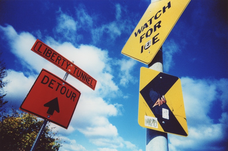

Doesnt look anything like xpro that I have gotten or seen.
Here is what I got from xpro using E100VS slide film:

Scanning negs is notoriously difficult, no matter what program you use.
The biggest thing is that the software will automatically try to set the 'correct' white balance based on the colours in the film. So whether you include the rebate (or even worse, sprocket holes) in the scan area will greatly affect the range of colours that it will scan and output.
If you include just the image with no borders or holes, the white balance comes fairly close to neutral, so whatever 'quirks' you may get from being expired or cross-processing are smoothed out and the result is what you've got, some fairly 'normal' looking pictures.
Of course, if you RA4 print them, you do the white-balancing yourself with CMY dials and end up with the same thing, give or take.
But hey, if it ain't broke, don't fix it? I reckon you've got some great shots there, of course it may not have been what you were going for. If you want weird and funky washed-out or just 'wrong' colours, try scanning them 'wrong' too. Or throw weird chemicals in your developer, or microwave the films first or something, that'll give you weird results too...
What you've got is more of a lomography look. For E6, cross processing is not so much unpredictable, but the effects it introduces, some of which are not desirable e.g. a zealous increase in contrast and a fall-off in highlight control, in addition to gross palette shifts (e.g. the colour will bear no resemblance to known E6 emulsion characteristics). If it rows your boat, that's fine. I think though to also use straight E6 so you have an understanding of what is happenig to the film in the cross-process — put the straight E6 on a lightbox beside an E6-XPro and make comparisons of what has been gained and lost, and what was unexpected. This is a valuable learning experience.
I'd say those are GREAT results. I'll try that Elitechrome (i have some in stock). Was it the standard Elitechrome, or the "Extra Color" version?
The biggest thing is that the software will automatically try to set the 'correct' white balance based on the colours in the film. So whether you include the rebate (or even worse, sprocket holes) in the scan area will greatly affect the range of colours that it will scan and output. <snip> Of course, if you RA4 print them, you do the white-balancing yourself with CMY dials and end up with the same thing, give or take.
Exactly, the scanner software is trying to make the film look 'normal', and the true cross processed results will not be visible until optically printed using the RA-4 method.
You can also scan the files in as 'raw' positives without having the software convert the images to a positive. Then the files can be converted to positives using software with far more accuracy than the automatic settings in the scanner software. But that's for a different forum, isn't it?
Guys;
If you cross process E6, you scan the result as a negative to get a positive image. After all, cross processed E6 gives you a negative and that is what to expect. So, trythis has exactly what is to be expected if you scan with the wrong settings.
PE
You need to scan the cross processed slide film as a negative, convert it to a positive using software, or print it using RA-4 paper and chemicals.

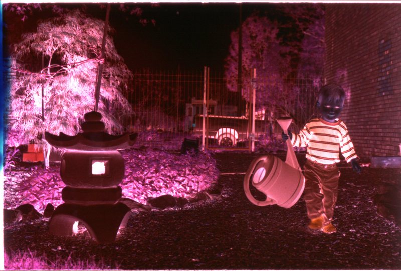

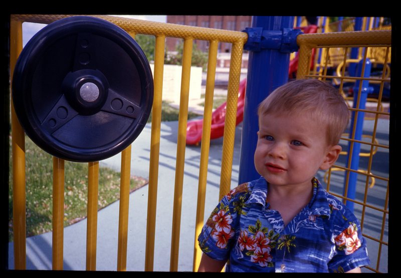

This is the same film processed in E6
What film were you shooting with exactly?

I did the corrections as well I was just presenting a worse case for the OP to see that his scanner was either doing a lot or his lab sent it out for E6 and didn't tell him. I (not having seen the Elite Chrome reference) was also exploring the idea that he may have been shooting Ektar 1000 or other C41 film and mistook it for an ektachrome of one sort of another due to name similarity.

I can't offer any advice, or knowledge, however, I enjoy these photo's, especially the 2nd and 3rd! Lovely Pontiac by the way! If my father were alive to see these, he'd go on hours about the many awesome vehicle's he owned, and drove! I needed no reminder, I still recall the cherry blue 1964 Chevy Impala he owned when I was 9! Thanks for sharing! :smile:
Scanning is unpredictable and inconsistent. Regularly processed and scanned Kodak Profoto XL gave me weirder color casts than cross-processed and scanned Provia. Printing is much easier and repeatable. I try to balance the whites and let the rest speak for itself.
Cross-processed Provia/RA-4 print
Cross-processed Ektachrome/RA-4 print

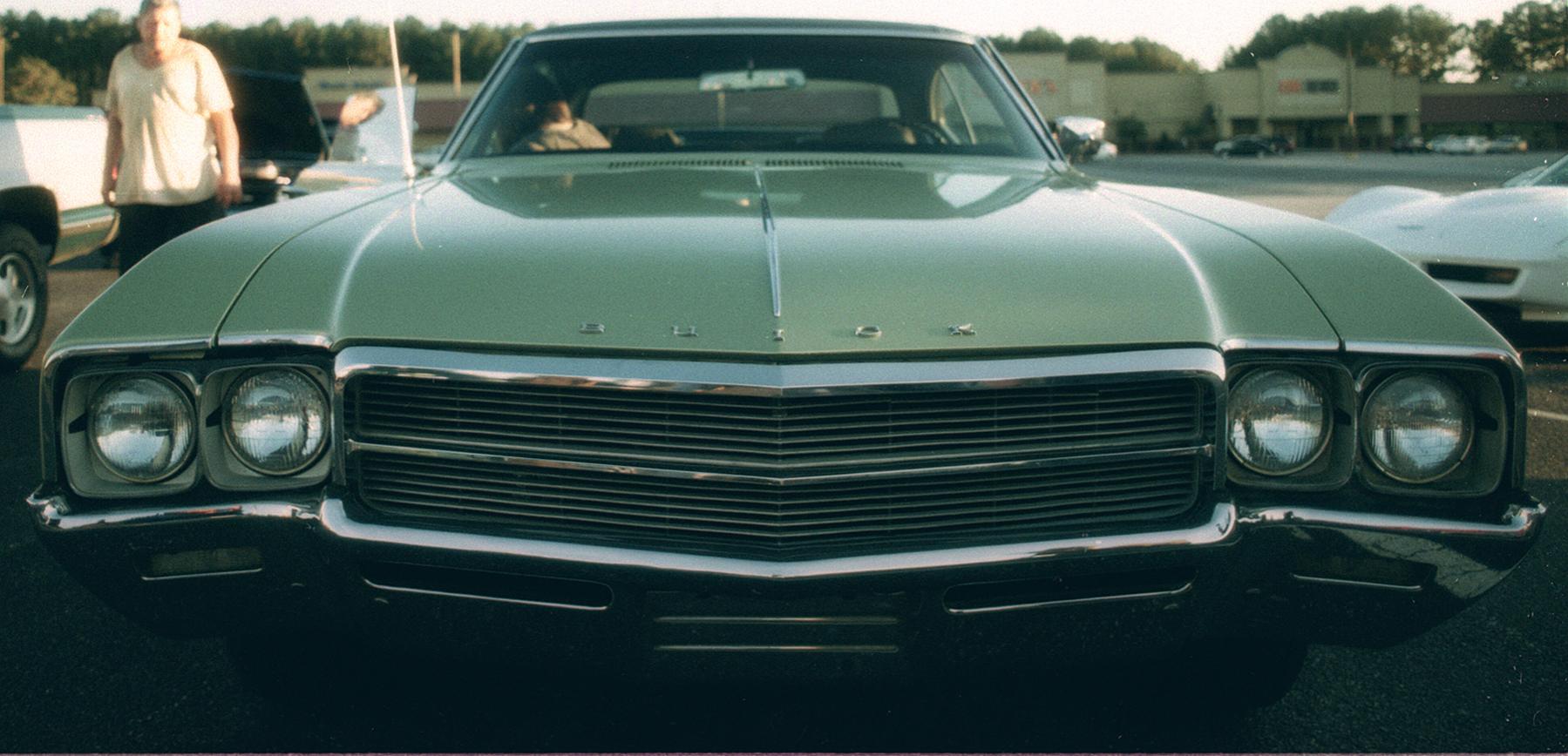

As for the pics, my man at the camera shop said his e6 machine was 'acting up' but I think there's an off chance he did process these in e6 and just didn't tell me. I really don't know. He's an old conspiracy theorist with a penchant for trickery, so there's no telling. They certainly don't look x-pro'd to me, but like I said, I'm a bit of a novice. Thanks for all the replies btw.
You mean you're not sure if the lab processed them in normal E6 or cross-processed them in C41?
That's easy, hold the filmstrip up to the light.
Is it a positive image? E6.
Is it a negative image? Cross-processed in C41.
It's the chemicals that decide whether it's pos or neg, not the stock.
The images are negs, so yes it was run in C41.

Eeeeerm..you do need to scan it as negative film since you just processed it as such!
Not that anyone cares: Again, I scanned them as both, neg and as transparency so I could compare the effect of inverting within photo editing software vs scanning as a neg. I only posted this here as the horrible dark transparency scan as an example of what a Xpro slide or neg looks like as seen by the eye, not as a processed neg.
