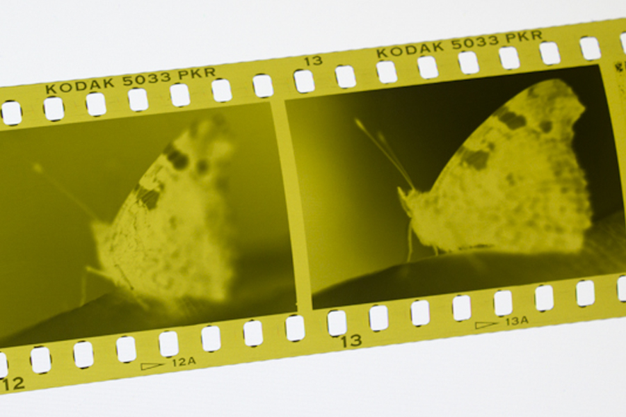

I have developed [135] Kodachrome PK 25, 64 and 200 (M, R & L), in B&W and with B&W Direct Positive, all of them successfully.

I have also developed Kodachrome 64 in Rodinal 1+40 for 20 minutes with success
