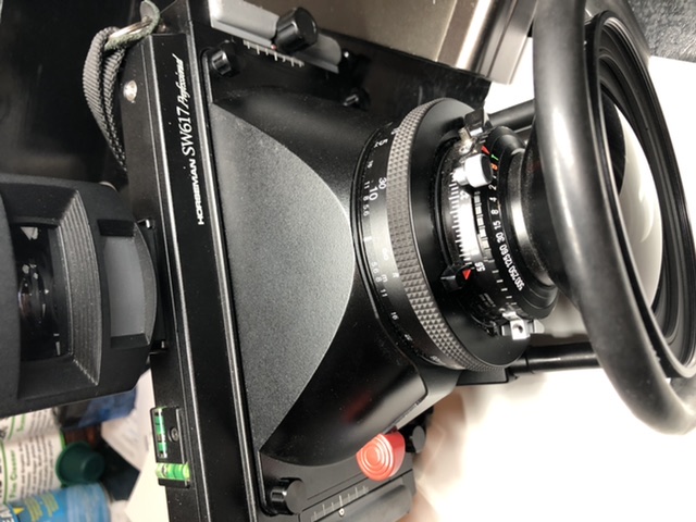

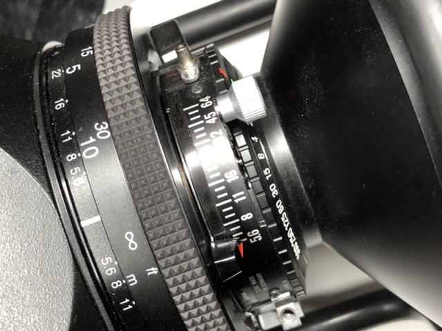

Here are a few images of the camera lens and ground glass :

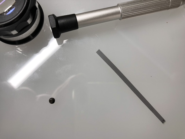

I ended up taping two pieces of film together with double stick tape and measured 0.29mm with a micrometer and cut 2 strips to fit between the ground glass and the frame. Infinity now appears in perfect focus on the ground glass - with all my lenses including the 180mm.
