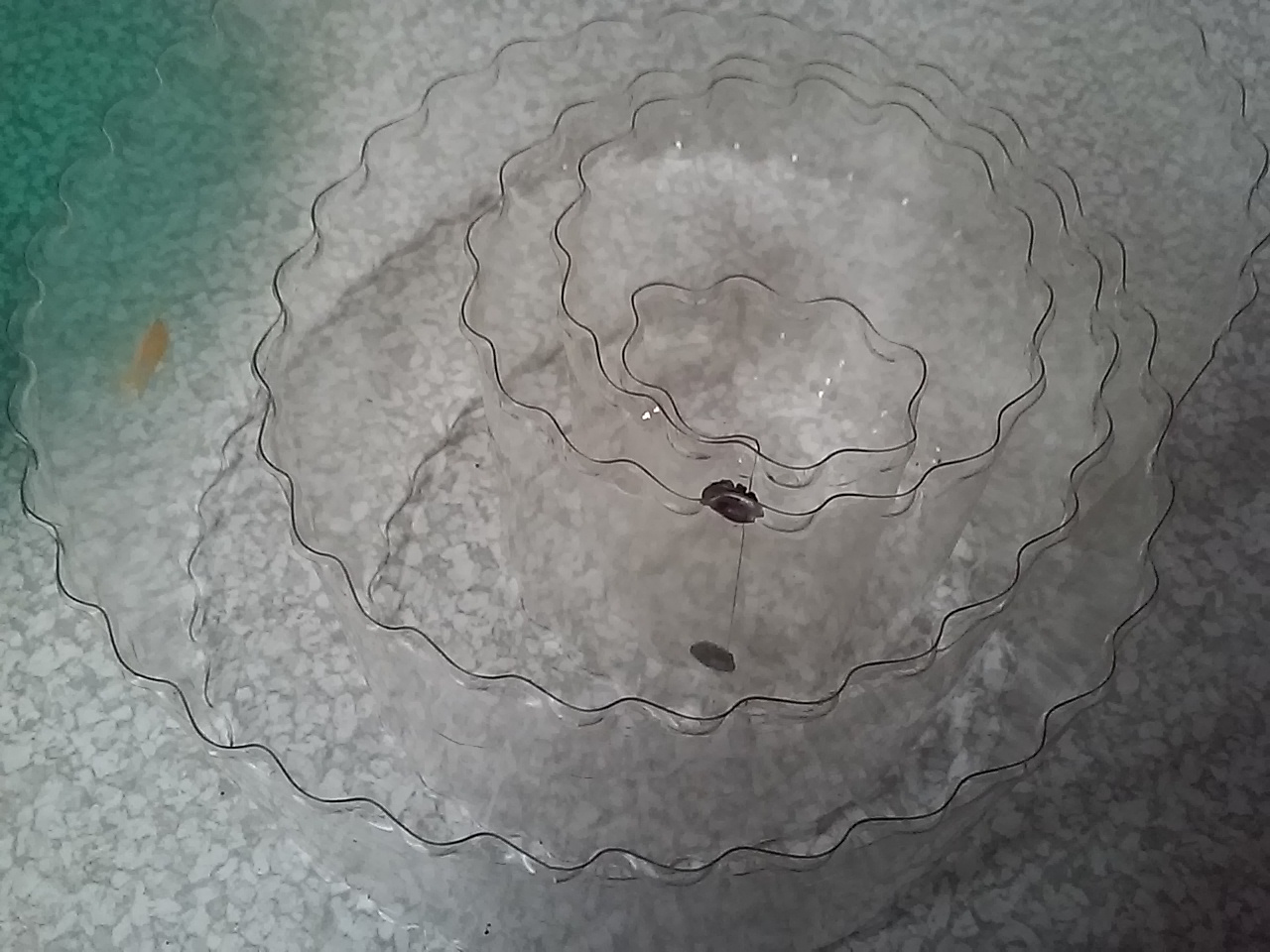

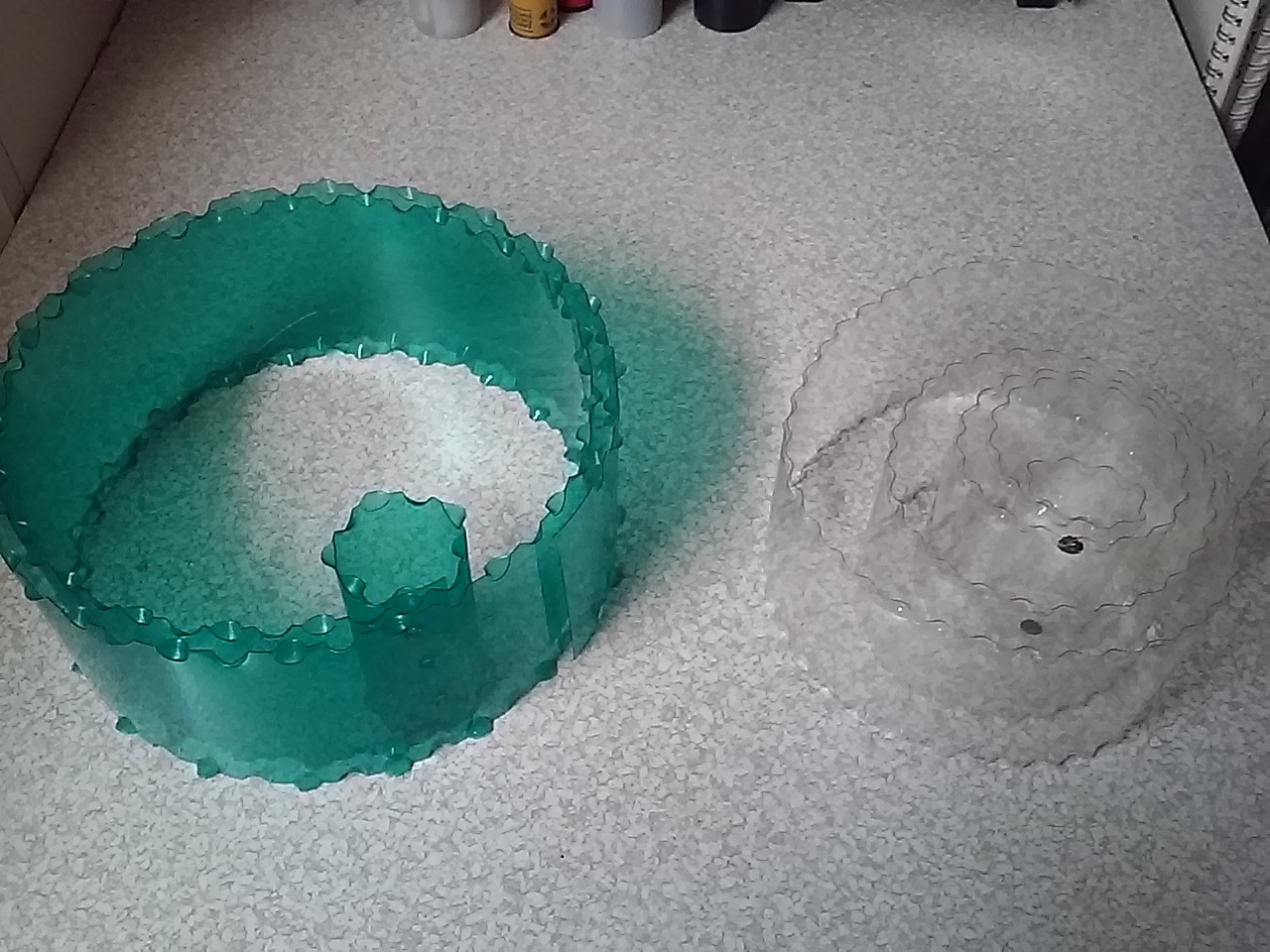

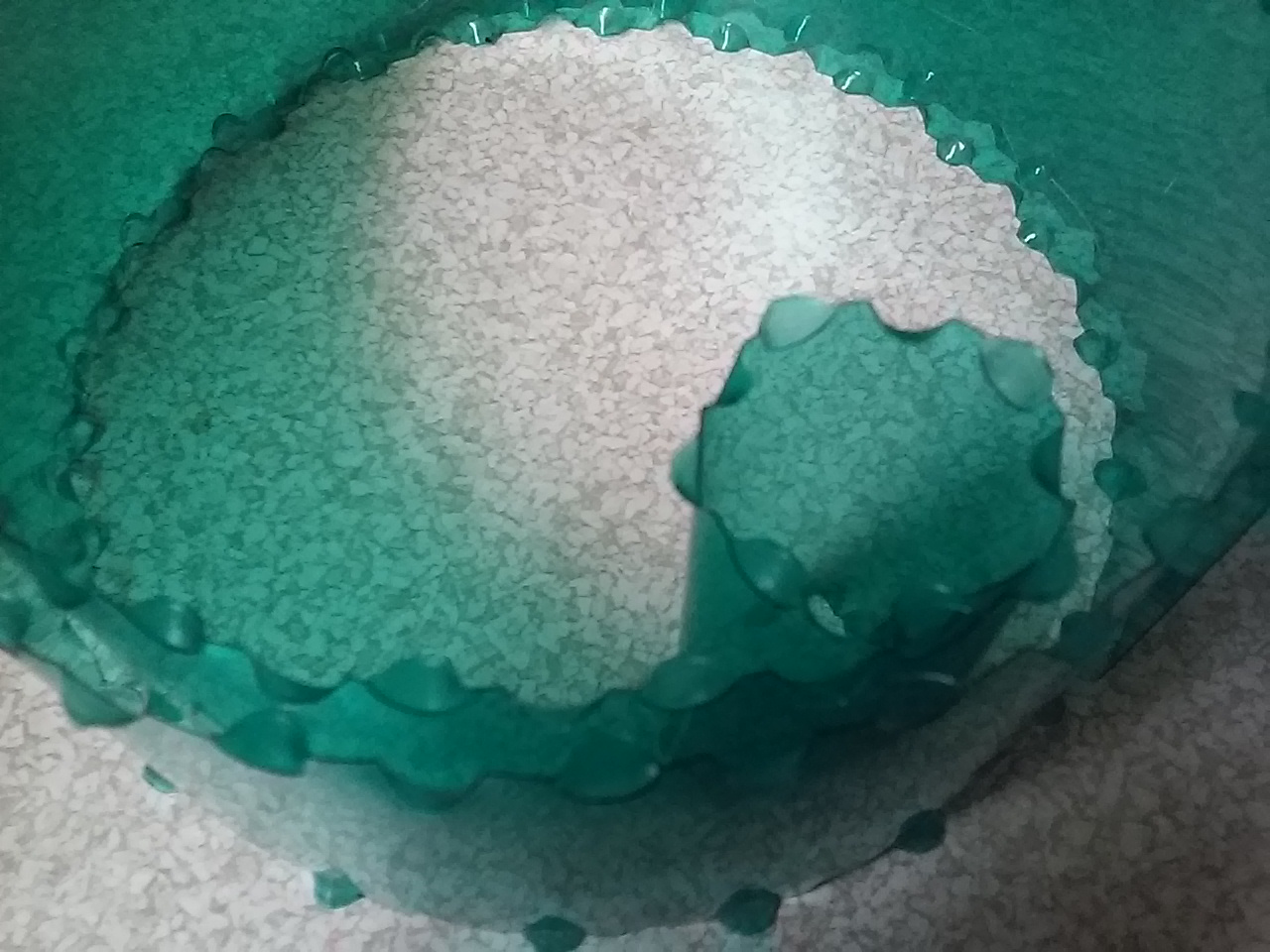

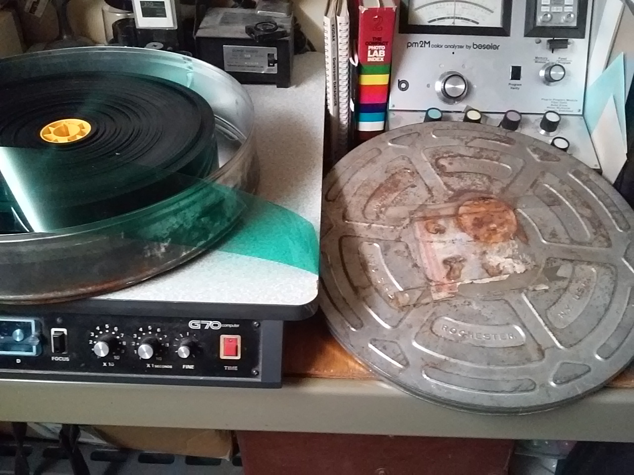

I've found my reel of EK 70mm leader for the old Pakor processor. Here is an original Kodak 120 and one I just made using a soldering iron set at 600 deg. F. It takes about 5 seconds per bump. I'm open to part with some.
Very neat job! Well done.
Very nice and good to know, thanks for sharing,.
I'm sure others will also appreciate your sharing this.
I have plenty. A roll of b&w 120 per 10 foot length, plus 5 bux shipping will get you un- crinkled 70mm leader. If you want pre-crinkled, pm me.
