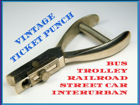

I normally just clip the corners depending on how many sheets I need to identify. Other than that I use a vintage McBee Railroad Conductor Ticket Punch. It punches an oval about 3/16" deep and the nice thing about it is that it has a small box under the punch to collect the waste so you don't have to worry about where little pieces have ended up. You can pick one of these up off the big auction site for around $20.
aha! That opened up another angle of search--ticket punches. That found me something interesting. A ticket punch with a built in adjustable depth gauge:
I like the McBee too, but I'm guessing the 3/16 will be a little big. Though the design of the McBee makes it looks easy to jury rig something to keep it from going too deep.
