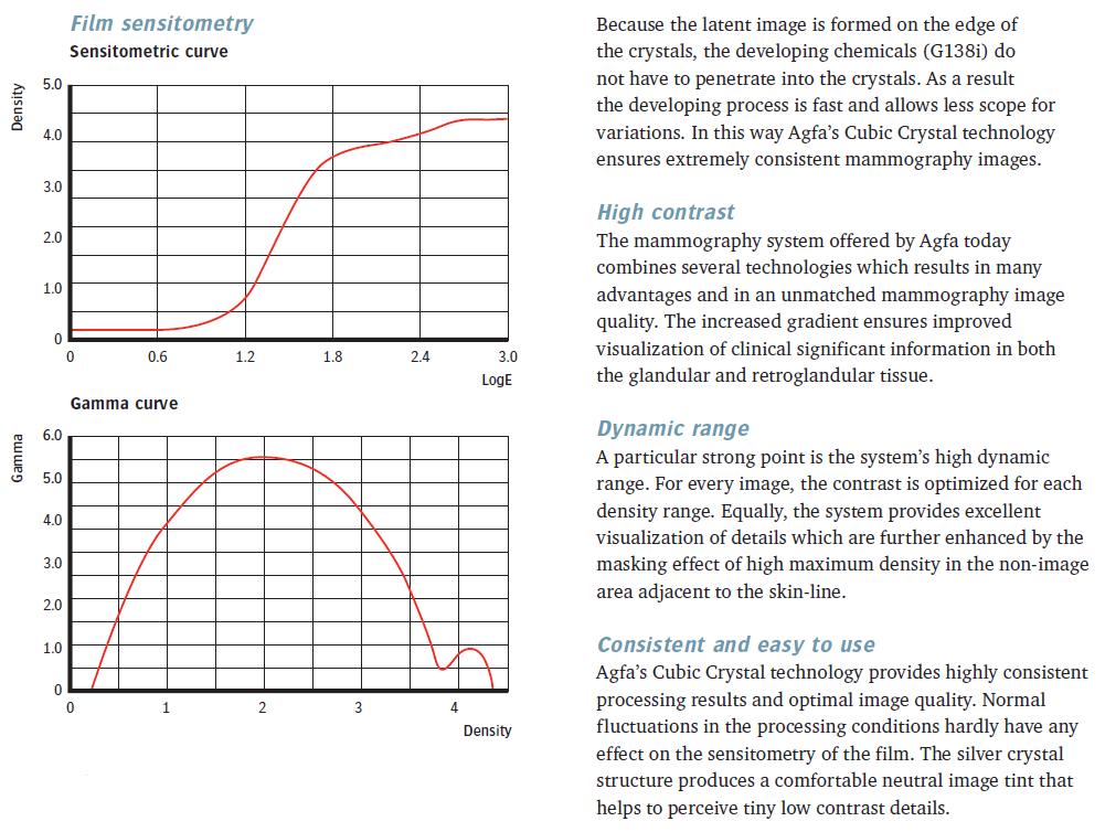

So I'm seconds away from buying some of this film. Look at the gamma curve though, is that unusual or am I just unfamiliar with gamma curves?
I'm also not sure what this line means, "A particular strong point is the systemÂ’s high dynamic
range. For every image, the contrast is optimized for each
density range. Equally, the system provides excellent
visualization of details which are further enhanced by the
masking effect of high maximum density in the non-image
area
adjacent to the skin-line.
Any opinion would be most appreciated.

Hmm, that link doesn't work all the time. Here's what the gamma curve looks like...
It just seems, well, odd to me. But I only know enough to be dangerous when it comes to sensitometry.

Well, all I'm trying to determine is if I'm gonna get a normal looking image. The way the graph dips back down makes me think it's some kind of strange film like Agfacontour.
I basically just don't understand how to read gamma curves.

Ok, so from what little I've read thus far in the sensitometry handbook, is this xray film going to have incredibly high contrast in the middle range and decreasing contrast on the outer limits? (great show by the way.. Outer Limits)
It's hard to extrapolate, since the kodak handbuch (that's german for handbook) doesn't actually show a gamma curve, and does this xray film even have a straight line portion? yuk yuk yuk...

The "sensitometric [or H&D] curve" on the Agfa literature shows pretty extreme contrast; the straight line portion goes from d=0.5 to d=3.5+ in only two stops of exposure (log E=1.2 ---> log E=1.8, and one stop is 0.3 log exposure units). However, this is for x-ray use and you would presumably be using a much less active developer, and see far lower contrast.
The "gamma curve" is the slope of the density curve, plotted against the film density; notice that it goes to zero near d=0 and again near d=4.5, which is where the H&D curve goes flat, and peaks where the straight-line portion of the sensitometric curve is found. All of the funny business is up above d=3.5, which is a pretty dense negative.
I seem to recall that the Kodak publication mentioned a maximum density of something like 2.5 for color separations, so your problem would be to get the density range of your original (probably something like d=0.1 to d=1.5 or so) to translate to d=0.1 ---> d=2.5 in the separations. The problem with the x-ray film would appear to be that really long "toe"; you might have to pre-expose in order to get up onto the linear portion, and then you would have a lot of base density to print through. But the developer will have a lot to do with this. The x-ray film curve is actually very gentle compared to a lithographic film (in lith developer) which goes from nothing to dead black with a negligible exposure change, and folks successfully tame that stuff for analog photography.
So I would suggest getting the smallest sample possible, and doing some experiments; after all "one clean experiment is worth a thousand dirty calculations" and the Kodak pub should give some idea of the targets that you are shooting for.
