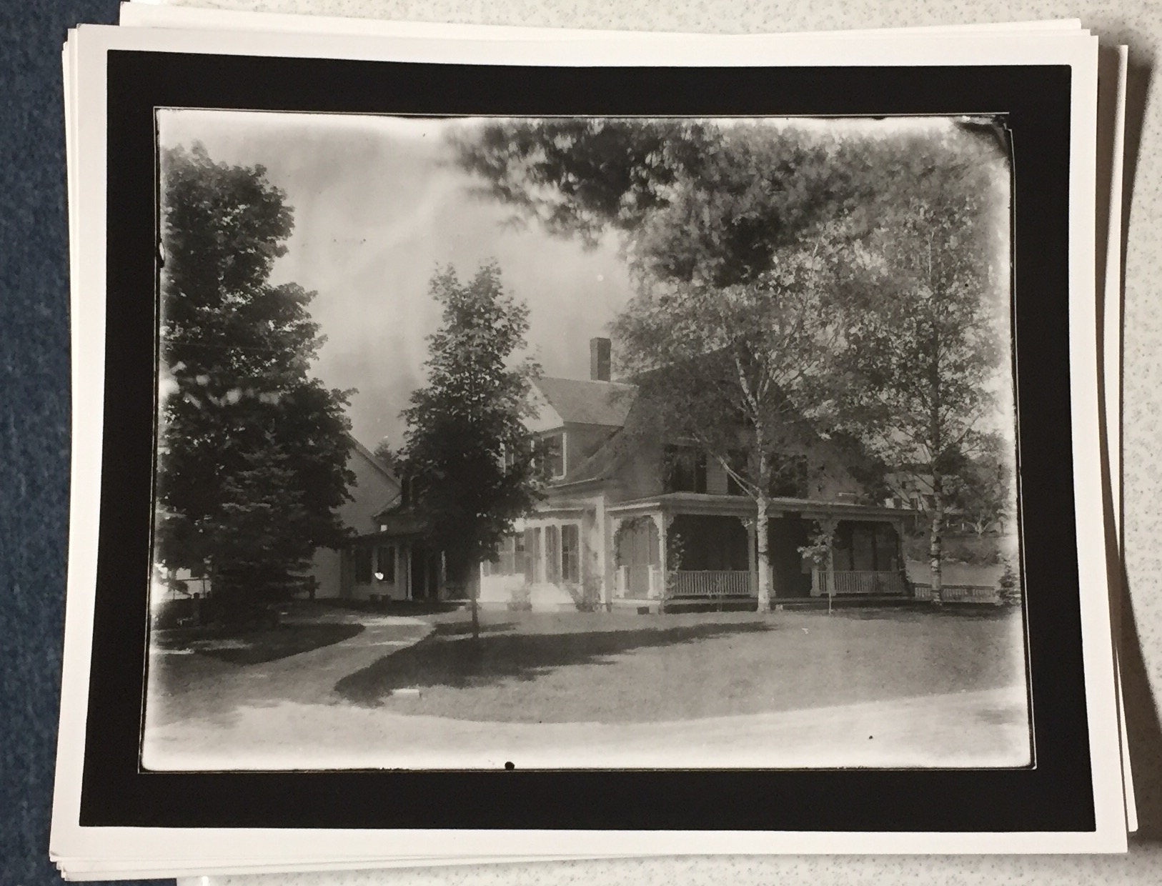

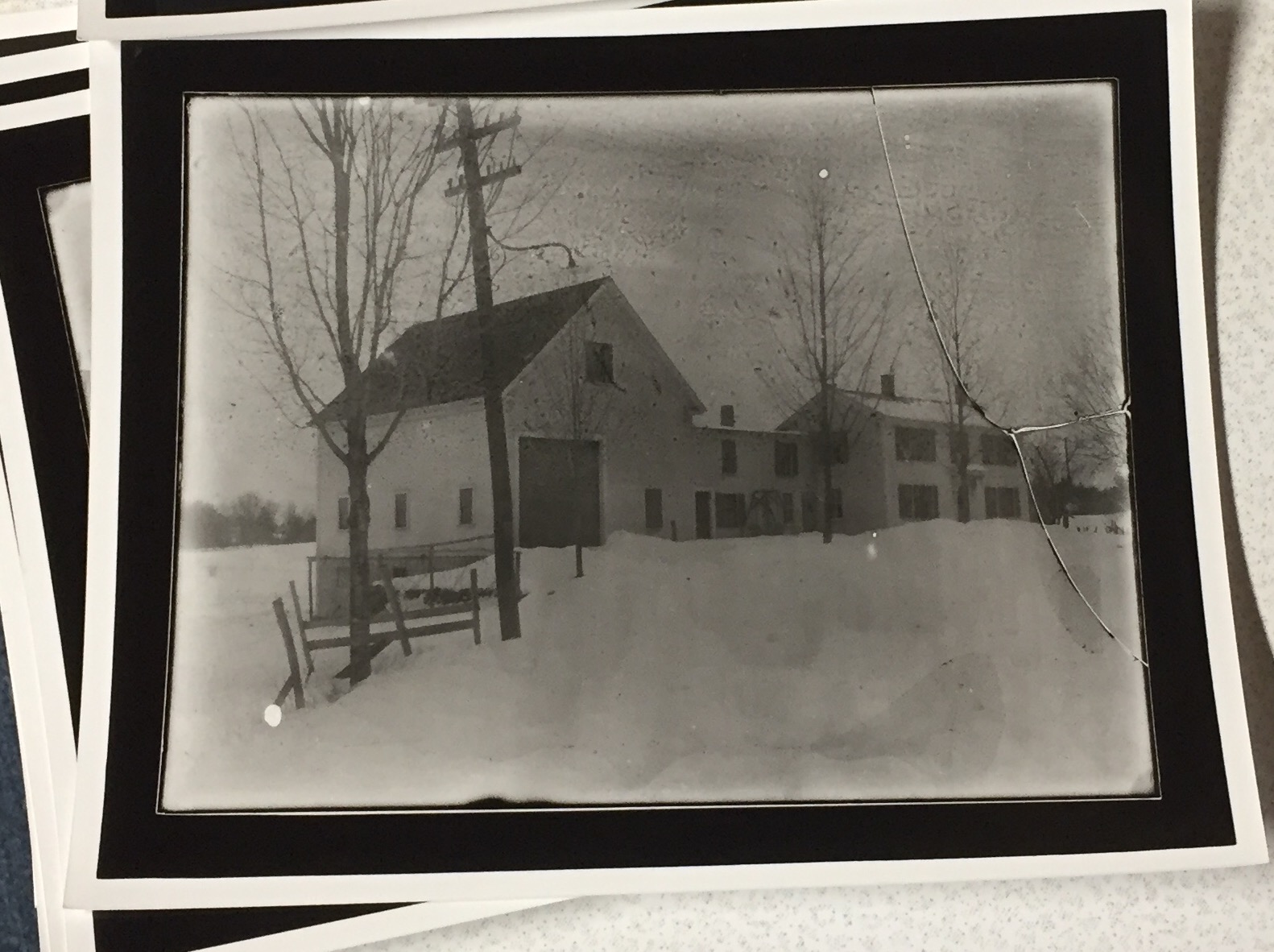

Right now I'm contact printing 100 year old dry plates that were over-exposed: very dense and low contrast. There's silvering along the edges.
Grade 5 filter seems to be just good enough for my purposes (I'll be scanning the prints instead of the fragile plates for my town's historical society). I'm using old Kodak polycontrast paper that isn't fogged. Seems to be working. Kind of neat to see brand-new prints made from 100+ yr old dry plates.
Id have thought the paper would have lost contrast. I just used some fresh ilford and some older ilford (10 years old?) And the drop off was pretty radical.
Here's a couple examples

Looking good! Did you test paper for contrast? I only say because my old ilford must differ by at least 1 - 1.5 grades compared to fresh stock and prints using both were radically different with contrast turned right up.
Those are looking nice tho
Thanks. I didn't rigorously test the paper, I just made it work. I had checked it in the past for fog (there wasn't any) and I've used it for the past couple years as one of my working paper batches to play in the darkroom. So I'm pretty familiar with how it responds (it's a huge batch of 500 sheets that I took a cheap gamble on buying). So I guess it helps to know how your paper responds. Oh and I'm using polymaxT to develop.
As for the plates themselves...I printed these more so I could scan them for the town's historical society's archive rather than scanning the fragile plates directly. So I have some leeway for dealing with contrast. I am making three sets of prints, so the plates can be stored away undisturbed. One set will go to the society, another set will go to the owners of the photographed homes if they're interested, and third set I'll keep.
